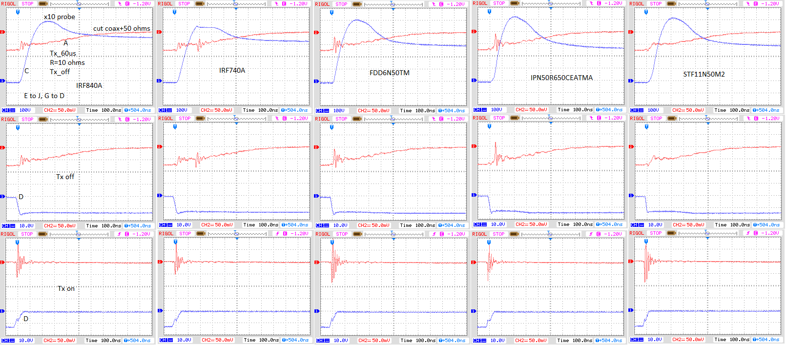

    Some tests with different gate resistor values turning Tx on and off. Guessing some of my problem is the circuit is hard wired. Different gate resistors effected oscillation across .1 ohm resistor at Tx on. Not much effect at Tx off.
    Coil connected to A, avalanches. Should different gate resistors effect oscillation at Tx off. Would a good circuit board layout look a lot different?
    I use a coil with different Tx and Rx coils. Noise level at integrator out seems to be the same whether Tx is on or disabled. What negative effect does the oscillation at Tx on or off have? Should I be seeing integrator out noise increase if Tx is enabled?
    If your noise level is the same with TX on and TX off, I would say it is as good as it gets.

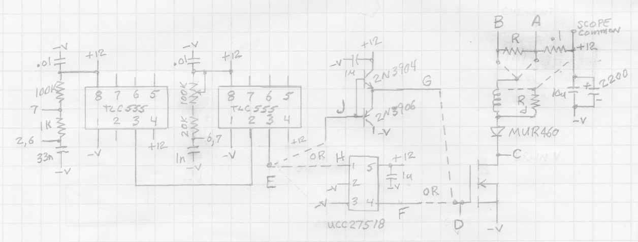

      Agree. I had purchased some different Mosfets to try. Tested them to see if I could see a difference. Added 10 ohms in series with coil(coil to B, R=10)to prevent avalanche. 3904, 3906 driver, no added gate resistor.
      IRF740 did avalanche, 400V rating. Others 500V rating. Coil 328uH about 1MHz resonance. Rd=1000 ohms, slightly overdamped.

        Hi Green is it possible to change the 3906 to a Darlington to speed up turn off
          That made a fair difference in one of my designs.
            Scope ground is at +12V so - supply on gate is off. Gate goes from zero V(on)to -supply(off)in less than 40ns with the 3906. How much faster do you want it? https://www.geotech1.com/forums/atta...8&d=1615911700

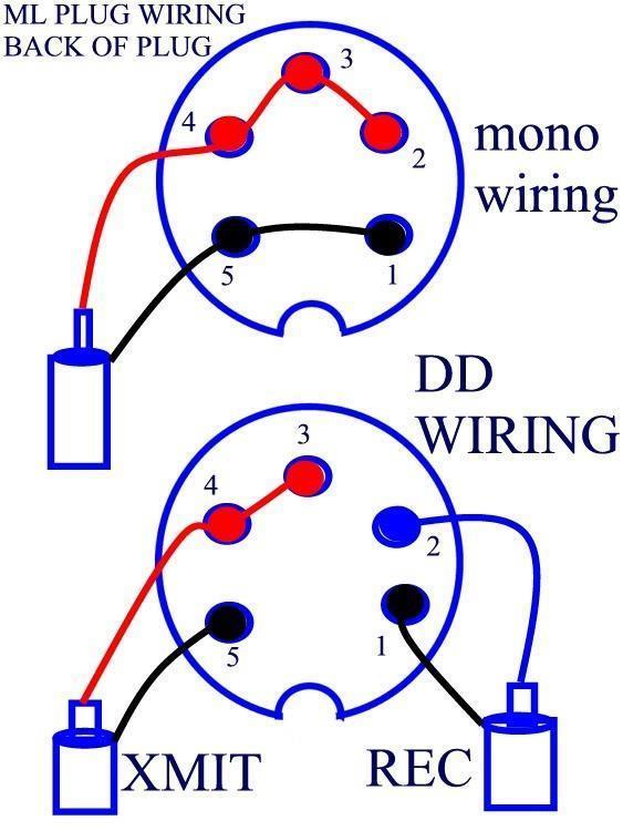

                        I have had a GPX coil running with Crossbow, which is an HH derivative, and don't understand what you mean by: "Because GPX coils has internal damping resistor for RX coil".
                        You stated that the Commander coil is a mono, so there is no separate RX coil.
                        I found that the damping resistor value required for the GPX coil was 470R. Please see attached document: "Minelab GPX Coil.pdf".
                        Also the connections required for a Minelab DD coil are in a second document: "Minelab DD Coil - updated.pdf".
                        By the way, active pulldown will not resolve this issue. You may simply having a wiring problem between HH and the coil.

                          Thanks Qiaozhi
                          According to your files, GPX coils has no any damping resistor inside it, there is the resistor only inside of main unit.
                          So, you believe that the best damping resistor is 470R for both RX and TX in GPX coils ?
                          See attached, i used the map for my pins. Please see both of your attachment. In first, pin 1 is RX and pin 5 is TX, whereas other is different and Pin 1 is TX and Pin 5 is RX.
                          In HH1 Rev. D, there is two damping. Do you think i should put 470R for both damping if i want to use DD GPX coil?
                          Thank you.

                            It looks like it was only necessary to use a 470R damping resistor on the TX loop, as perhaps there was a damping resistor for the RX loop inside the coil shell.
                            I honestly cannot remember, as it was quite a few years ago.
                            • The TX coil is internally damped and the RX in DD coils has the damping resistor in the coil mono coils use the internal damping resistors.
                              Regards, Ian.

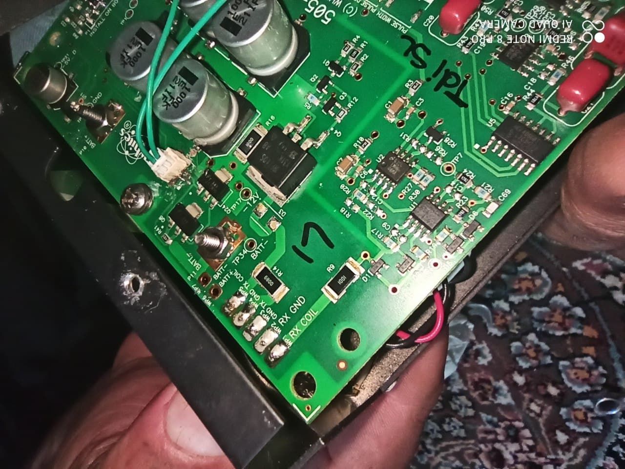

                              • Thank you dear Qiaozhi.
                                I attached TDI PCB, it's pins part. As you told, i think TDI only has used a damping resistor for its TX (680R, I tested 680 for HH1 and mono GPX, its sens is weak ), not RX.
                                Since TDI also can work over GPX DD and it also hasn't used any damping for RX, so it's proved that GPX coils has used only a damping resistor over RX (only for DD), insideClick image for larger version
