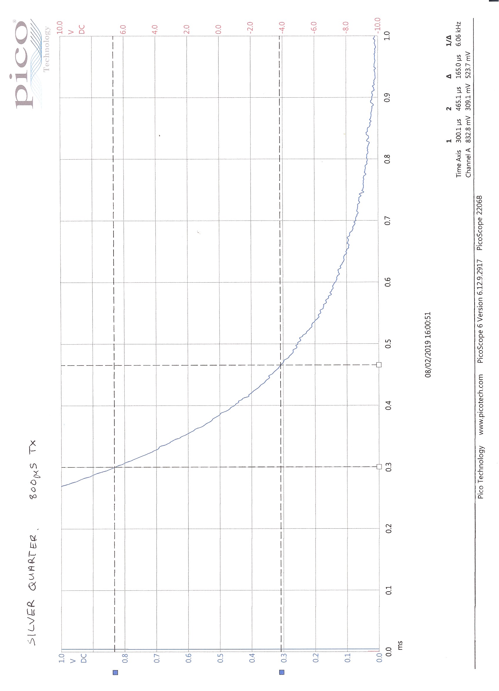

    Like Green, I prefer to measure actual targets as many are alloys have a considerably reduced conductivity compared to the parent metals. I made a special PI for this on which I can vary the Tx pulse up to 1mS in width. Here is the decay curve plotted for a US silver quarter. Note the Tx pulse is 800uS wide which is approaching 5 Tau for this target. I put the first time cursor on a convenient point of the curve and measure with the amplitude cursor. This gives a value of 832.8mV. I then move the other cursors to a point on the curve where the amplitude value is 37% of the first figure. The delta value on the time line is 165uS, which is the Tau.

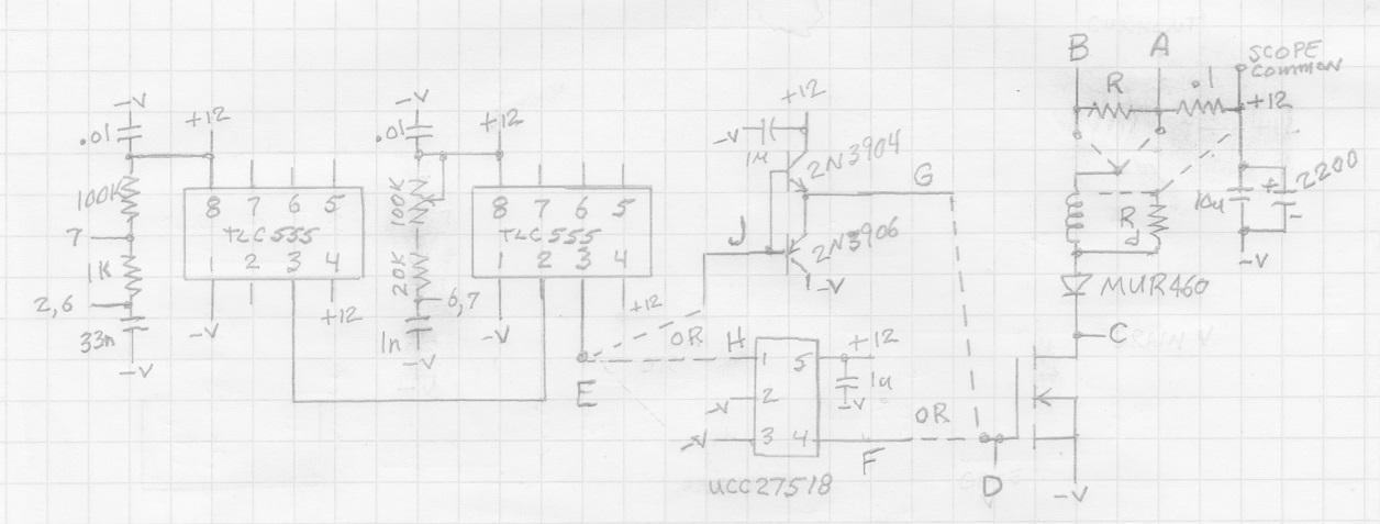

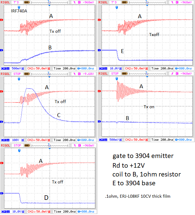

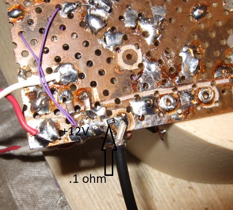

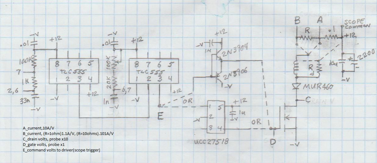

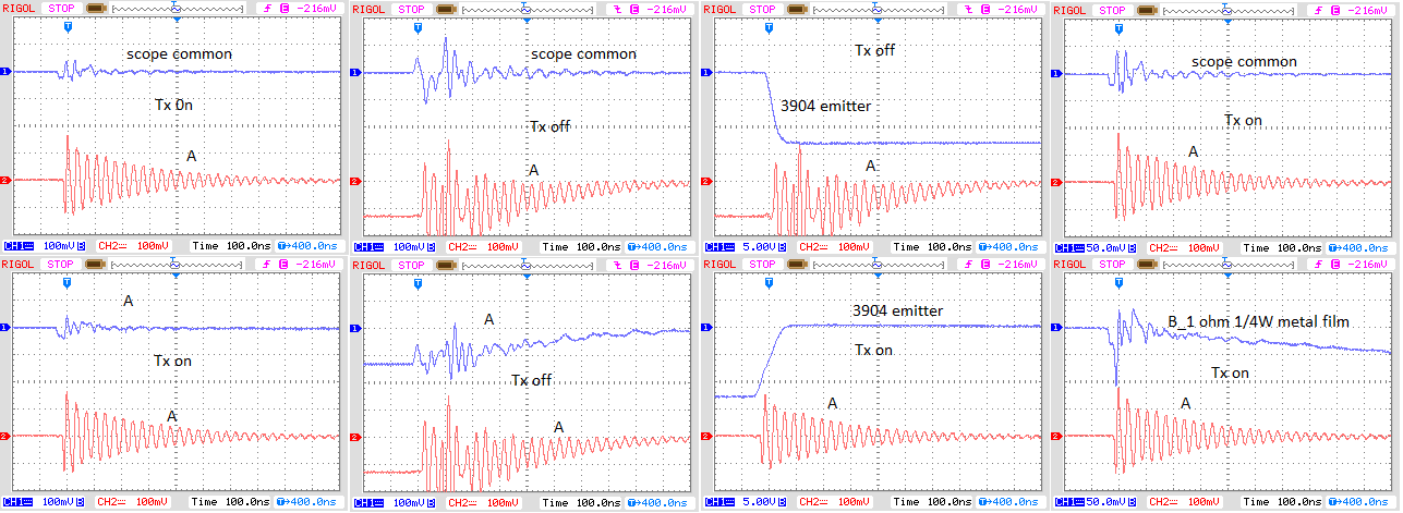

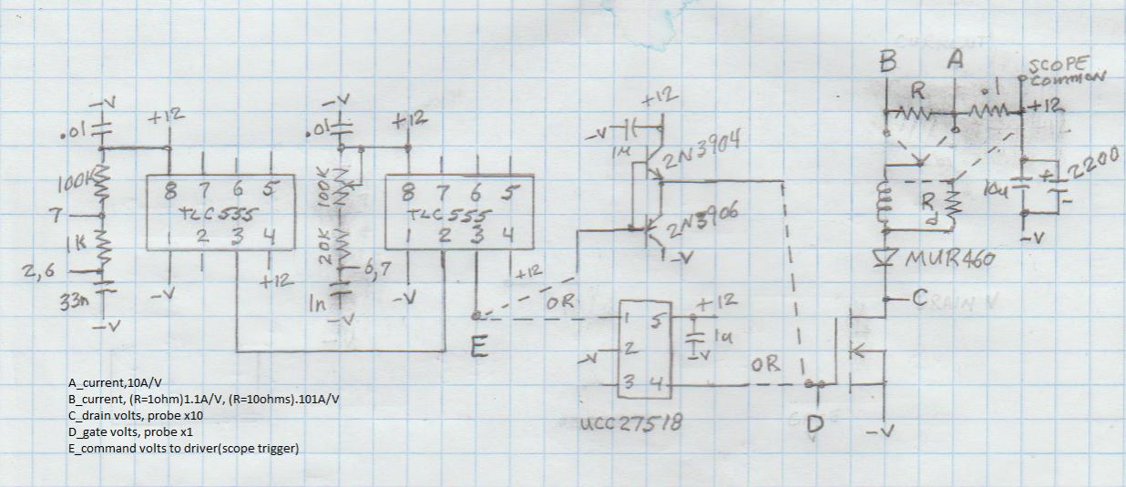

    • Received the .1ohm resistors. Made a tester. Was thinking some of the oscillation was caused by noise pickup using a regular scope probe with ground lead. Cut a BNC cable and soldered across .1ohm resistor to reduce pickup. Thought it would reduce oscillation, NOT. Including some test scope pictures. Top left picture, .1ohm and 1ohm resistor are in series with coil to +12V. How can I get over 1A oscillation across the .1ohm resistor and no oscillation across the 1ohm resistor? Any thoughts why or what I might try? I have a thin film .1ohm and some different Mosfets to try. 1ohm resistor is a 1/4W metal film.

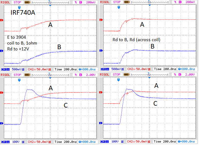

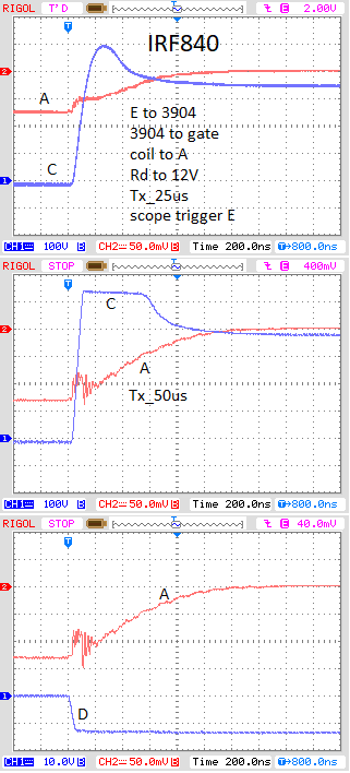

        • Don't know if I should. Added a 100 ohm resistor in series with cut off BNC cable to reduce oscillation. Recorded decay with Rd to +12V and Rd across coil. Recorded C at drain not coil(error reply #122).
            Tried a IRF840 with the 100 ohm resistor in series with he BNC cable.
            Couple questions. Can the BNC cable be excited in resonance or was the oscillation without the 100 ohm resistor real current oscillation? Have more Mosfets, what parameters should I record?
              Yes, Coax cable can oscillate. They are distributed inductance and capacitance and will be 'resonant' at some frequencies.
              100 Ohm resistor in series with the coax can help by lowering the 'Q' of the coax LC.
                reply#122
                Still trying to measure oscillation. More recordings. CH1(normal scope probe) CH2(cut BNC cable soldered across .1 ohm resistor).
                Four left pictures compare CH1 connected to scope ground or point A(oscillation is noise pickup?). Any suggestions on how to determine if oscillation on CH2 is actual current oscillation? Think it isn't but don't know to prove it.
                Third row, labeled CH1 wrong. Should be point E(555 out), scope trigger for all recordings. Forth row, coil connected to 1 ohm resistor in series with .1 ohm resistor. Ch1 connected to scope common or point B(noise pickup on both?)
                If oscillation CH2 is caused by BNC cable resonance, any suggestions on how to solve it or what is causing it?
                  reply#122

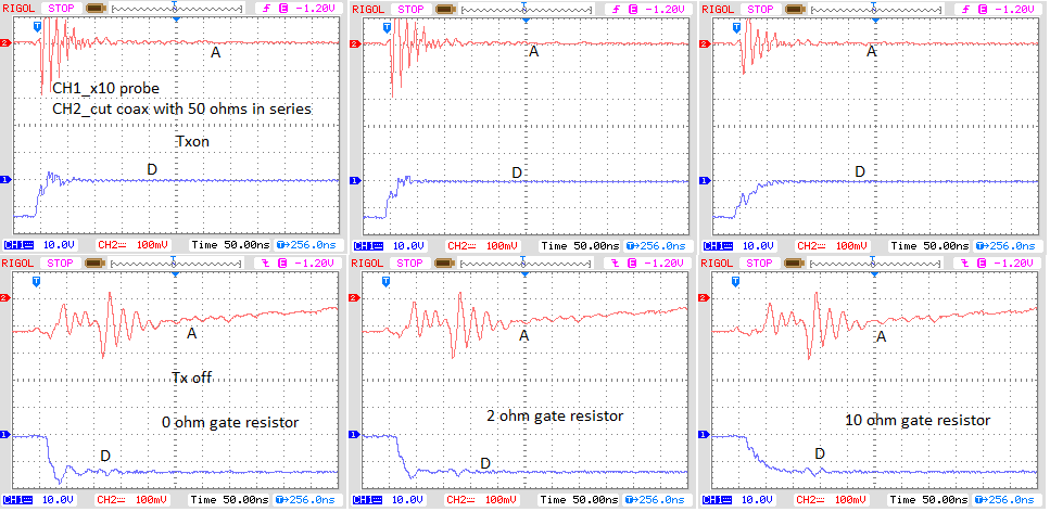

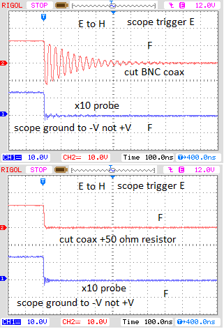

                        • Thanks for the replies. Don't have an oscillator. Thinking a steep response might work. Used UCC27518 output(connected to CH1 and CH2 only). 50 ohm resistor soldered to coax center wire.

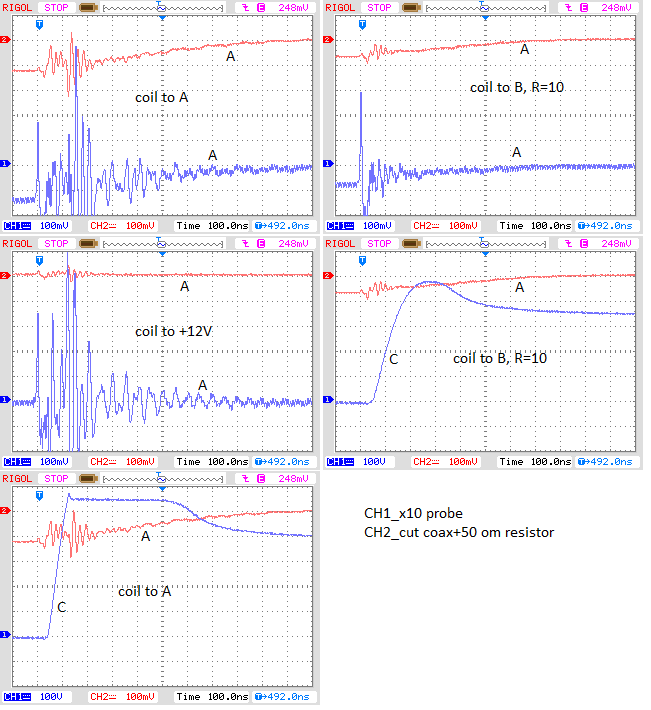

                          • Some recordings, IRF840. Coax with 50 ohm resistor picks up less noise than x10 probe. Middle left picture, coil connects to +12V. Shouldn't be any current thru .1 ohm resistor(some signal CH2, CH1 not good). Like Eric, I get less oscillation if Mosfet doesn't avalanche. Rd to +12V not coil. Not posting how to measure oscillation, posting the problems I'm having.
                            UCC27518 driver
                            • Gate resistor
                              Something about Mosfet gate resistors
                              • Some tests with different gate resistor values turning Tx on and off. Guessing some of my problem is the circuit is hard wired. Different gate resistors effected oscillation across .1 ohm resistor at Tx on. Not much effect at Tx off.
                                Coil connected to A, avalanches. Should different gate resistors effect oscillation at Tx off. Would a good circuit board layout look a lot different?
                                I use a coil with different Tx and Rx coils. Noise level at integrator out seems to be the same whether Tx is on or disabled. What negative effect does the oscillation at Tx on or off have? Should I be seeing integrator out noise increase if Tx is enabled?
