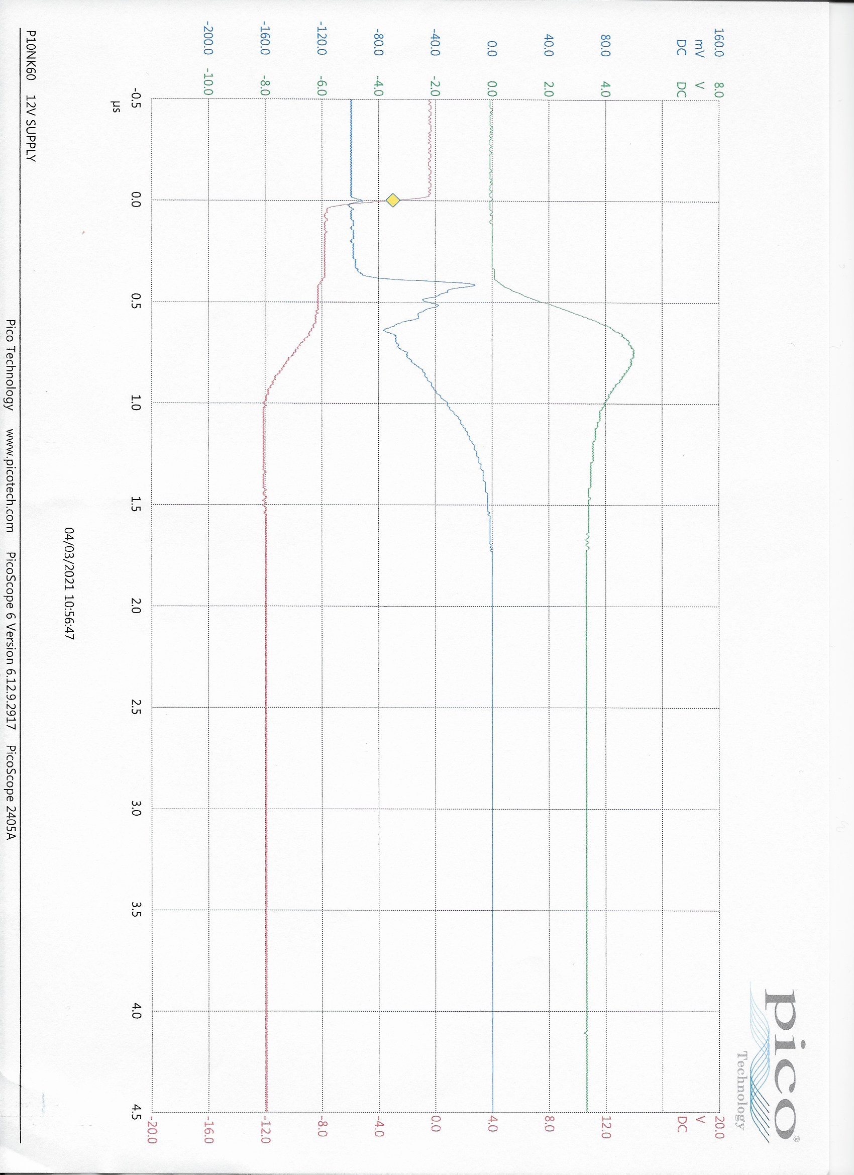

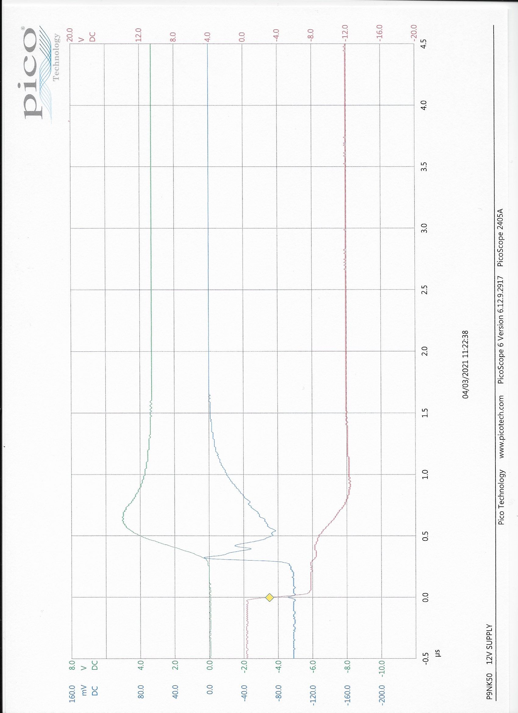

              Having gone through a considerable number of different Mosfets, I am now revising which ones are good for a rapid switch off and those that are not. This is a result of looking at plots of Tx current waveform, high voltage flyback, and gate drive. One thing it is best to avoid is avalanching as this generates a lot of uncontrolled ringing noise. There are many variables which influence the result and the coil is obviously one of them. My coil is 10inches diameter, 330uH and 5.4ohms, with 1.2m of 75ohm Vandamme coax giving a total of 5.8ohms. In series, there is the 0.1ohm current sensing resistor, plus a series 4.7ohm metal oxide resistor to improve Tau and reduce coil current to 0.9A. This was necessary to bring the high voltage pulse below avalanche using a 12V supply to the Tx. Resistive damping to the coil is quite critical and was adjusted to give the fastest response without coil ringing.
              As to the Mosfet, I found that those with a Vds of >500V were necessary. A commonly used one is the IRF740, but this avalanched and rang in my test circuit. Types with very low On resistances did not work well, but the STP9NK50 with a typical 0.75ohms Rds(on) worked fine with very low ringing and 500V Vdss. The ringing we are talking about and measured on many Mosfets had a period of 80nS which equates to 12MHz, so it's not coil ringing. Another candidate is the STP10NK60. All of these Mosfets are in the same ballpark as regards voltage and current ratings.
              One puzzling feature on the blue trace for coil current, is the positive going spike which crosses the zero line to indicate a reverse current and then returning to -0.8A before decaying more slowly to zero which is the damped coil response. Some Mosfets have a much bigger excursion into the reverse current which results in higher amplitudes of the 12MHz ring. Green commented on this a while back and I thought is was an artifact of the back emf pulse. However the two do not coincide in time, except that the voltage starts to rise rapidly as the coil current approaches zero. Maybe this blip in the coil current is caused by one or more parasitic capacitances in the Mosfet. The true coil current decay is the curve that ends between 1.5uS and 2.0uS and ideally continue smoothly to join the 0.9A level.
              The top green trace shows the back emf peaking just below 500V and then decaying to around 350V, then with a slow decay towards 200V when it is shorted to ground by the turning on of the next pulse. this voltage is stored on the Coss of the Mosfet and blocked by the series diode, which is now the MUR460 rather than the HER208 used in previous plots. Changing to the MUR460 seemed to make a small difference, but will look into that later.
              The two best Mosfets are P9NK50 and P10NK60. The latter having more margin before avalanche sets in. Click image for larger version

ID:	359286 Both Mosfets have the blip in the current trace ending close to zero.

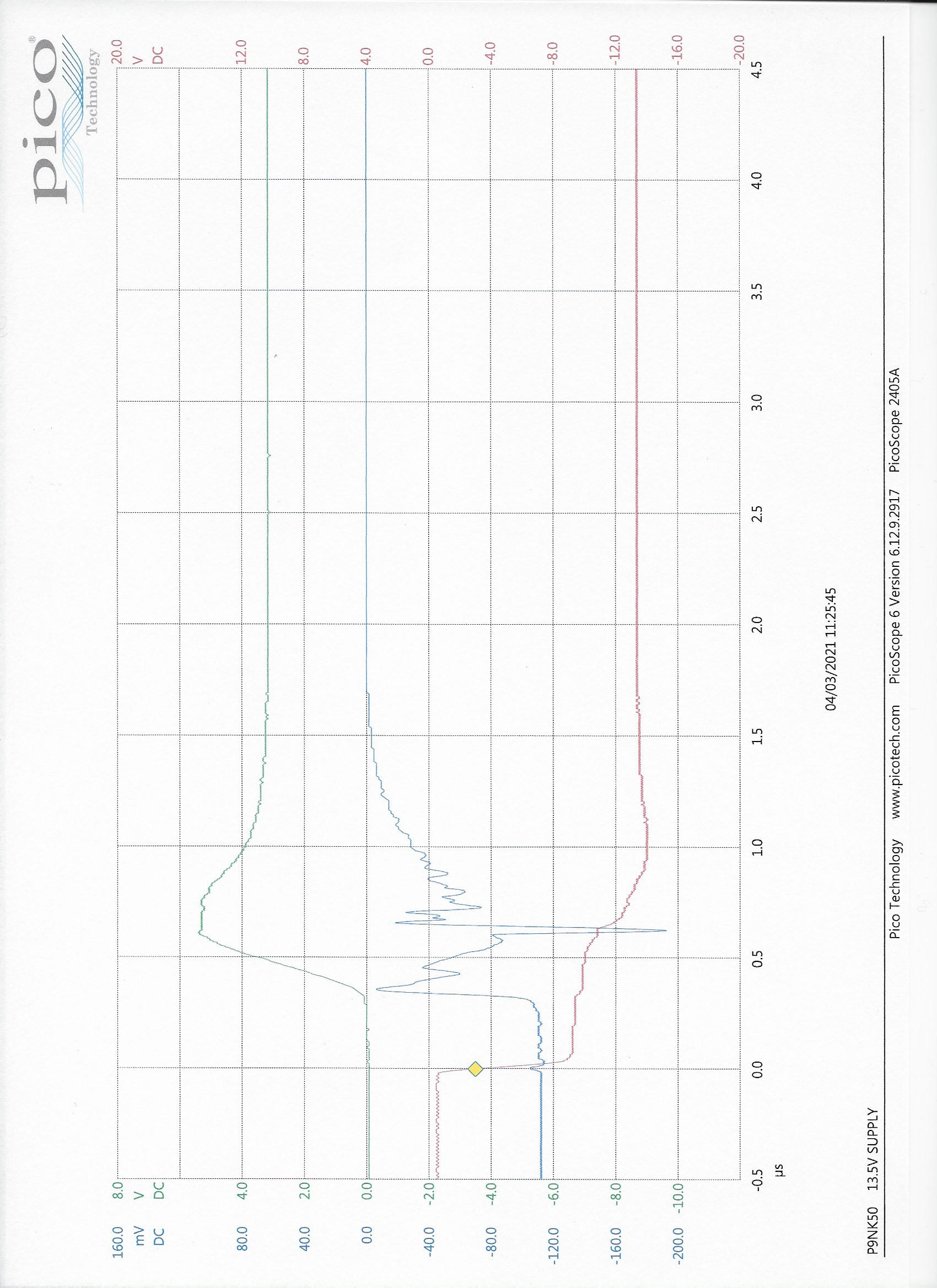

              The P9NK50 then had the supply voltage increased to 13.5V with the result that the flyback exceeded the avalanche voltage. Now the ringing appears. Click image for larger version
ID:	359281. Using the 600V device you can increase the voltage to 15V before ringing starts.

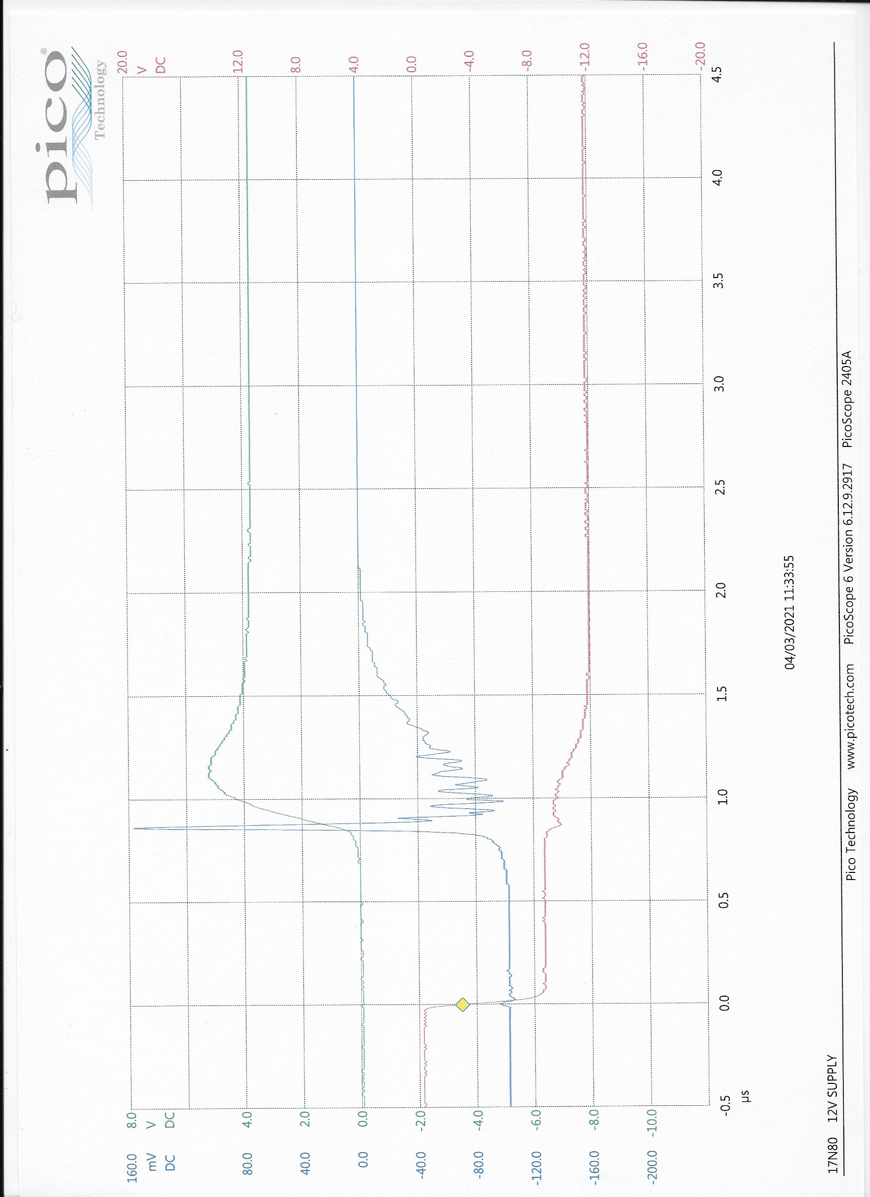

              A device I recently advocated, 17N80, because of its very low Rds(on) and Vds of 800V didn't come out so well and there was a longer delay time before switching started. Click image for larger version
ID:	359282 Notice the much larger amplitude of the spike in the blue trace and that we are still at least 300V away from avalanche.

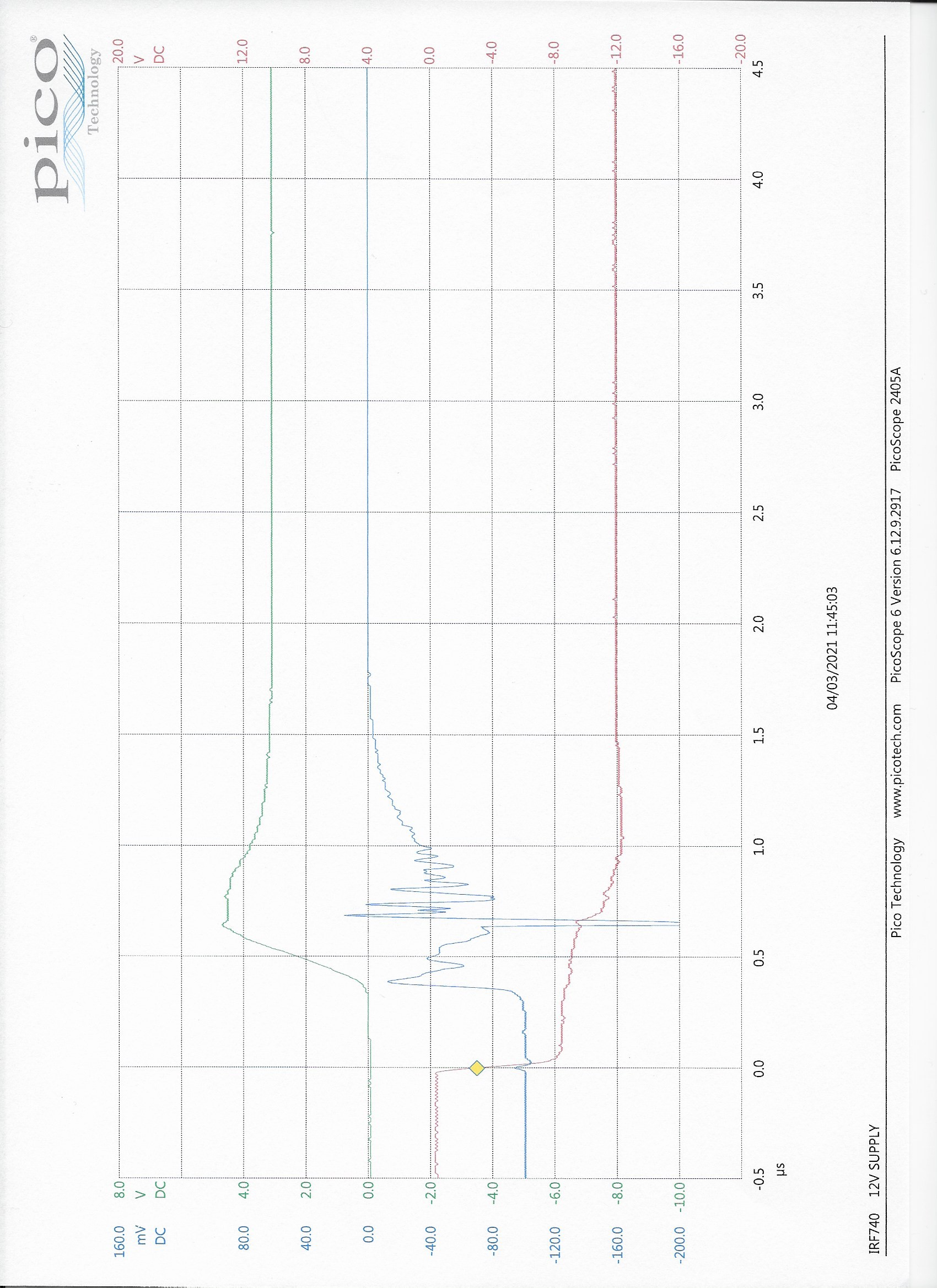

              Lastly, how does the good ol' IRF740 fare? Click image for larger version
ID:	359283 Avalanche at 450V and ringing with a big negative spike.
              Remember that all these plots are with extra resistance in the coil circuit and only 0.9A maximum coil current. Lower coil resistance or higher supply voltage will likely cause avalanche to occur, sometimes to the point that the Mosfet will be turned on a second time for a brief period.
              Where we have delays of >10uS these effects will be long gone and may not matter, but the original question was for fast switching a device and these plots show show what is happening at early times. One can only proceed further when we have a preamp attached that will operate in its linear region much quicker than we have at the moment.

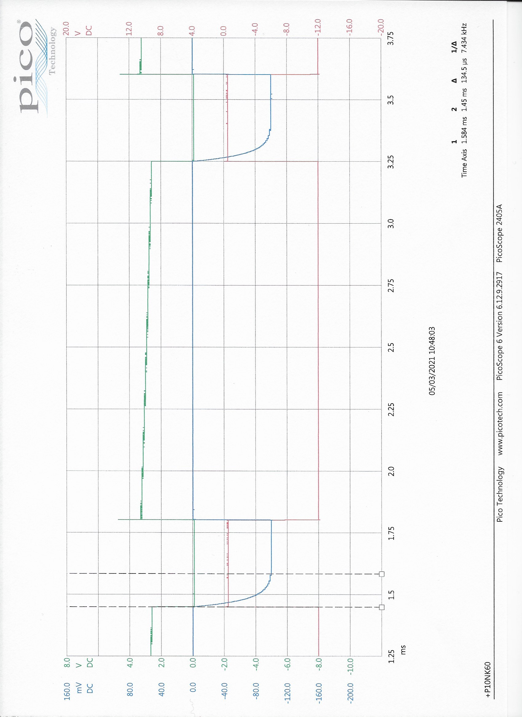

              • #97
                why can't we lower the Pulse width to avoid avalanche instead of higher resistance or lower drive voltage?
                • #98
                  Attached is a plot of the whole transmitter waveform that I have. Aside from the initial current growth period of 134uS, the current is constant for nearly 200uS. If the pulse width were shortened, nothing would change until you reach the point where the current starts to fall at a width of 134uS. Click image for larger version
                  The green trace is the back emf, or flyback as it is sometimes called, and you can see the slow decline between pulses, presumably due to the small reverse leakage current in the series diode and Mosfet. I have tried a bleed resistor from the Mosfet drain/diode junction which takes the voltage to zero between pulses, but this slowed the switchoff slightly. The wide, 350uS, Tx pulse is there to give good excitation to larger good conductors e.g silver and gold coins, as well as small objects.
                  In practice, I would use a considerably higher repetition rate and stick with the low pulse current as a means to avoid avalanche.
                  I tried the complementary emitter follower gate drive which was slightly faster than the single transistor drive, but this causes the avalanche situation to occur sooner.
                  Eric.
