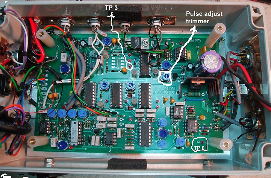

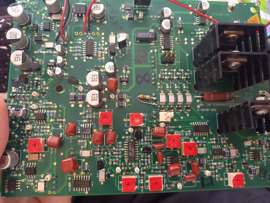

                          One of the boards I got is off the TDI Pro, after quick check it appears to be very similar type as Goldscan 5 (audio is AD654) but it has a processor for the timings.
                          I've decided to go forward and reinvent the wheel for the TDI SL. The changes will be introducing new MCU plug-in board upgrade. Old one goes to trash, new FFC connector and board soldered on it's place. Differences with the original would be

                            Hey dave, is the TDI Pro that you have similar to what I got?
                            I have few questions about the pots/external connections, maybe you can provide some help if you keep notes.

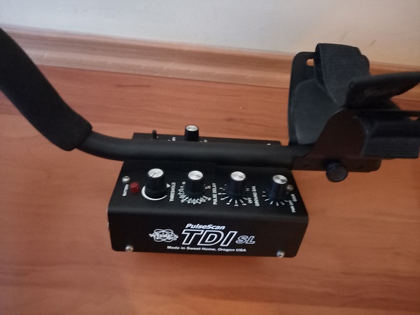

                            I've managed to restore the reverse engineered TDI SL finally after sitting in the basement for 3 years!

                                OK I know what you mean - the one with the 4538 cct for timing generation.
                                The one I got is with MCU. What's strange is I noticed 2 audio amplifiers, maybe that needs a closer look.
