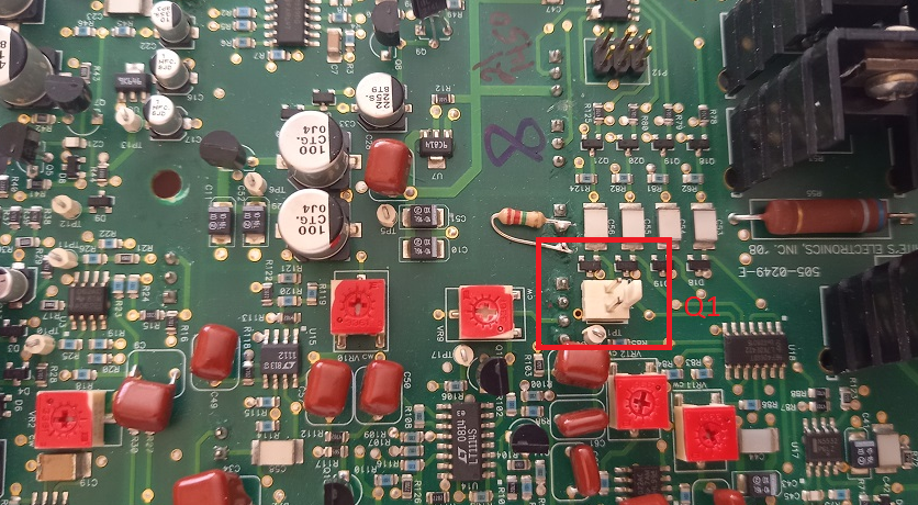

        Thanks Carl, here are few questions I have:
        1. On the bottom side there are Frequency and Delay connectors - I'm going to try 100K potentiometers /is that OK/
        2. The threshold connector - I'm going to try 100K potentiometer /is that OK/
        3. The ground balance connector is 4 pin connections are not very obvious at the moment
        4. On the top side what is the P1 connector, it's not labelled what it is, perhaps GAIN, in the SL the GAIN it's 100K but here probably a 50K is more appropriate value?
        • #49
          1. Freq & Delay were originally 10k. Still, 100k will probably work.
          2. Threshold is 100k.
          3. On the GB connector, 2 pins (1 & 3) are for the 100k pot connection. The other 2 pins (2,4) are for shielding. The wiring for the pot should be small shielded coax. S-video cable would work.
          4. As I recall, P1 is shorted for calibrating the backend circuitry. I don't remember the procedure so try not to mess with trimpots.

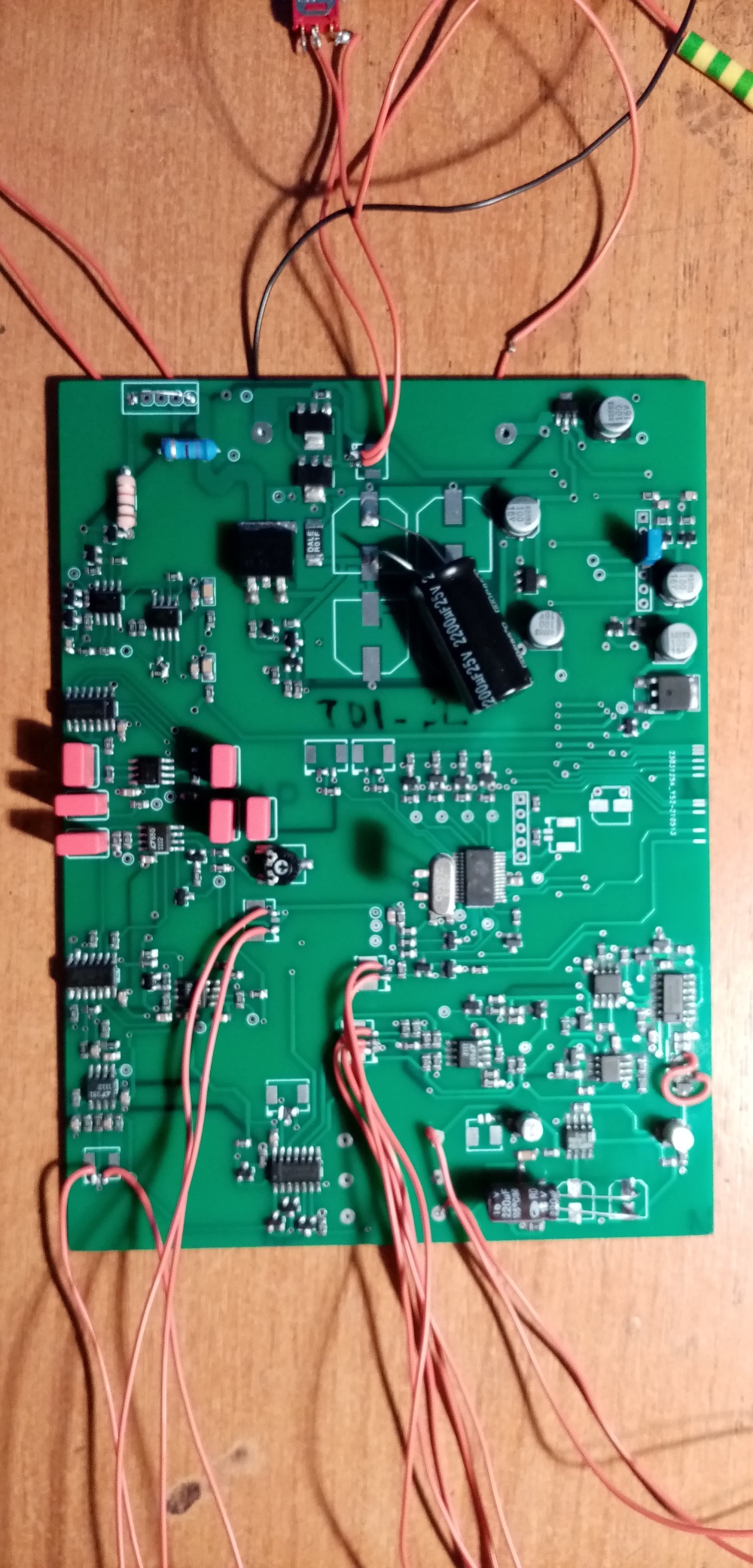

            Thanks Carl.
            I will let you know when this thing fires up, hopefully no smoke.

                      My TDI ...www.youtube.com/watch?v=BLoIkjD0HWo
