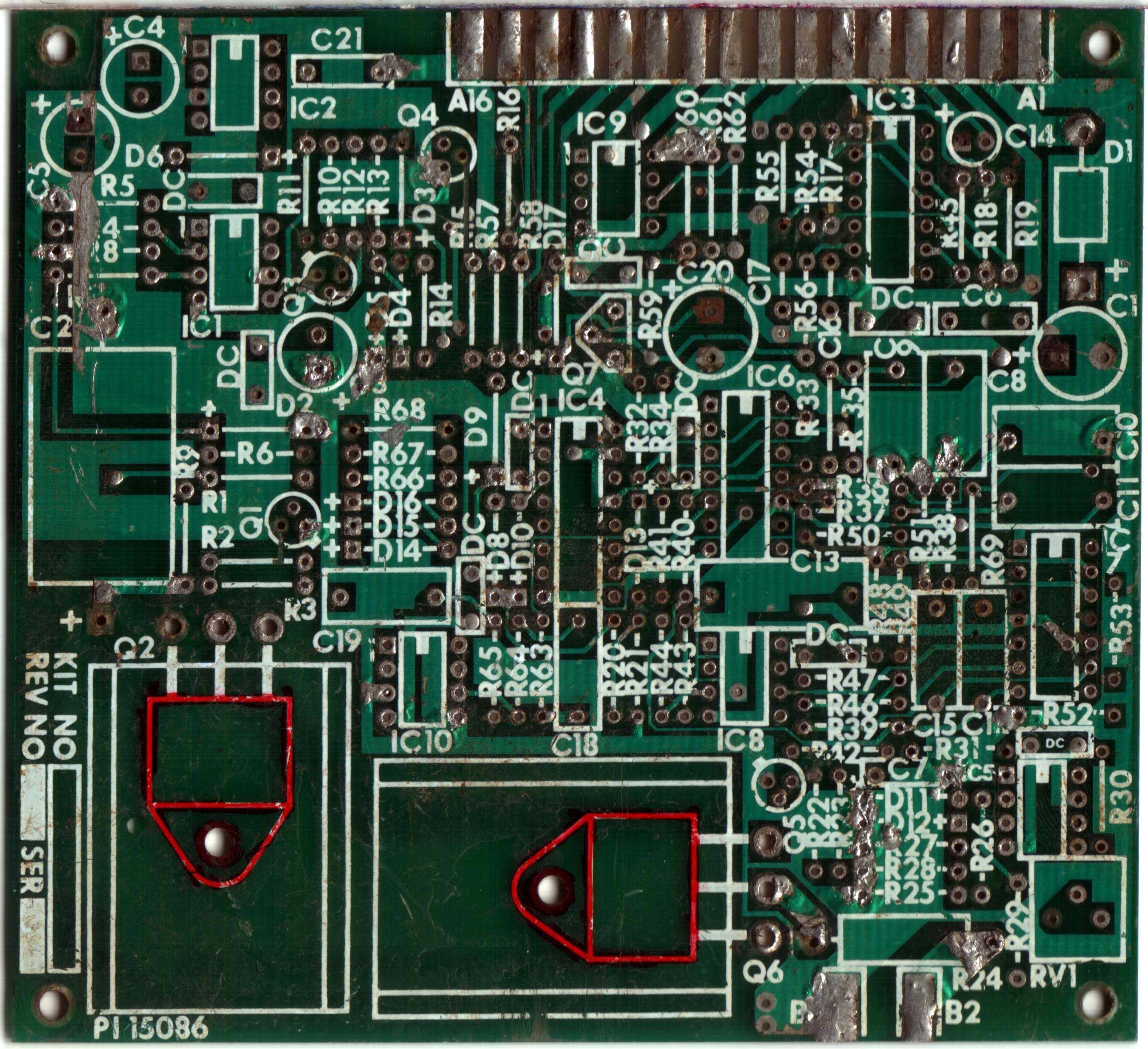

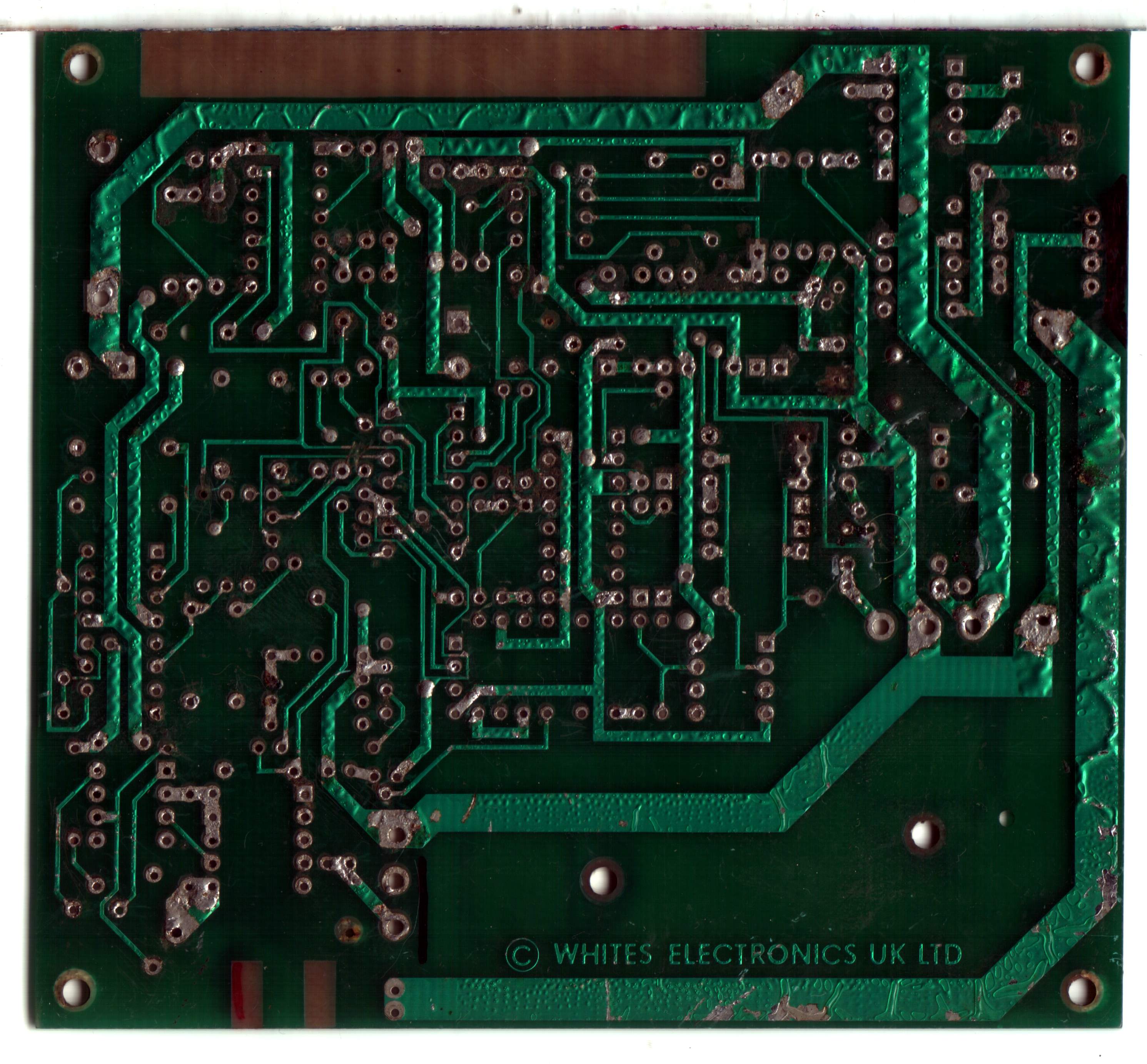

                    you give a link on TO3 (old) case. not same. iwkonik desoldered the board (his pics i put) so he can give pic of the transistor.

                      kt, is the board you showed at all from the AF108

                        • #57

                            I am currently working on a single side layout. Much work to be done.
