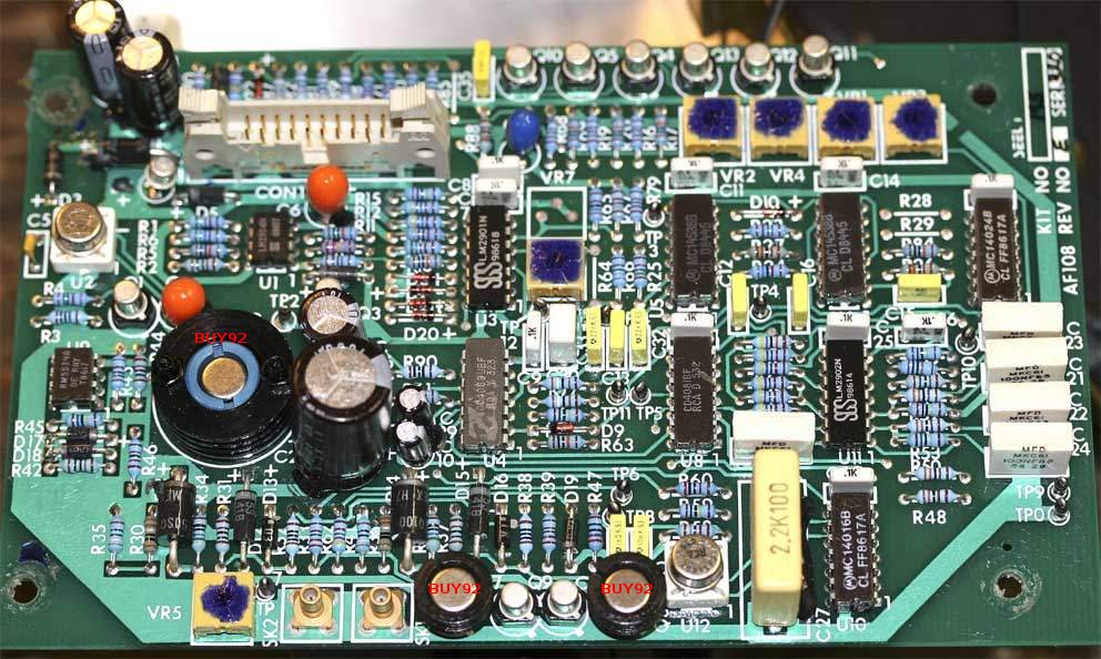

                  There is a AF-108 PI Military Metal Mine Detector listed on ebay, if anyone is interested.
                  • #69
                    Having done some more digging and research, I realized that there was also a PI 150 pipe locator which is a totally different circuit(although it does have similarities).
                    This was the circuit which was back engineered by Ivconic, and not the AF-108.
                    I also found a photo of the PCB of the AF-108 mine detector. Note that the quad AND gate is a 4081 just as waltr had speculated(on the schematic it is mislabeled as CD4069). And also have a look at those lovely BUY92's, with there custom heatsinks. Wow! that's fantastic.
                    • #70
                      Great to see a picture of this board and the nice construction.
                      Those heat sinks were off the shelf back in the day.
                      No idea if they can still be bought.

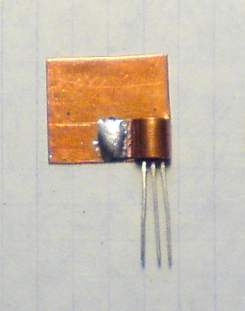

                            OH LORD,THAT'S TERRIBLE MURIEL!
                            Won't the solder melt before the magic smoke appears? OK, that will surely work, but not the prettiest sight.
                            The BUY92 is nothing special(TO-39 package). Easily replaced by something in a TO-126 package. This is least of the worries.
                            The biggest challenge here is adjusting those trimmers in the pulse generator circuitry.
                            I have almost completed the remainder of the layout. Will be starting construction soon.
                            Hope to have a working prototype in about two weeks or so.
