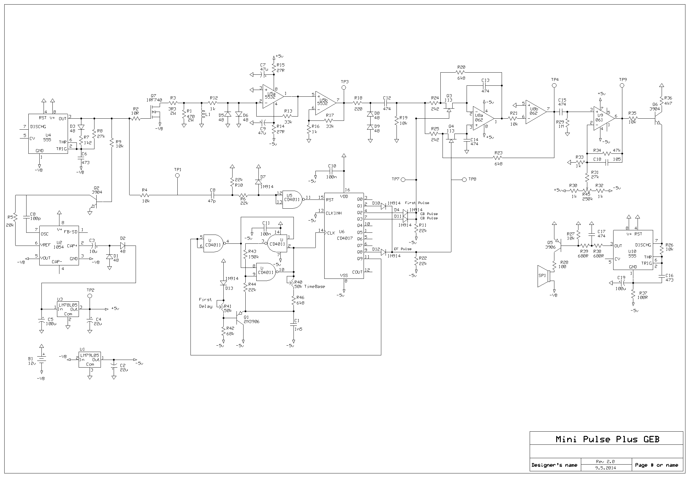

    Check the methods I use on my HH2 here:
    A basic PI design incorporating a PIC micro for timing control, intended as a learning platform for using uC's.
    Be sure to follow the links to theoretical and detailed discussions.
    It does create a "hole" but I have found that No interesting objects exist in this hole and the method enhances detection of long TC targets.

              Correct, it is the three sample method that can be done with simple hardware.
              I have not found a measurable decrease and long TC target response are enhanced.
              If we wish to move forward I think we need to first identify all current GB methods and describe their particular strengths and weakness.
              Then with some additional theory propose other methods to be tested in Real Circuits or Software.
              A very possible change is having Software (that controls pulse and sample timing) alter the timing to remove 'holes'.

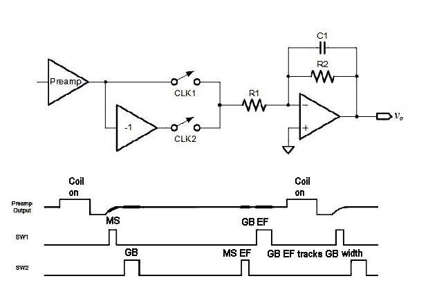

                I have also been using three sample technique but the GB comes at cost of reduction in sensitivity. I use Target Sample, Ground Sample and EF Sample.
                Is their any other technique to achieve GB without compromising on the sensitivity?
                  What timing of the three samples?

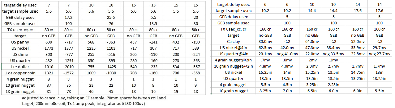

                  I have found that using GEB sample of 90usec enhances sensitivity to long TC targets like smaller silver coins.
                  Short TC targets like US nickle and pull tabs seem unaffected.

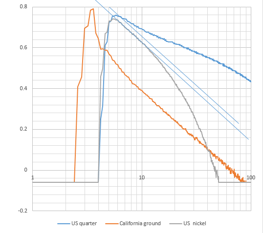

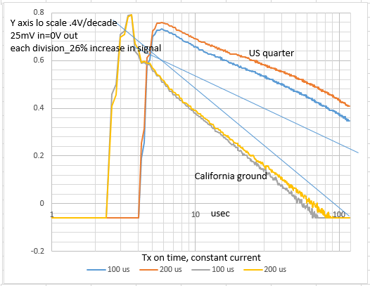

                        For ground signal only, subtract ground sample from target sample to ground balance(make them equal before subtracting). Has anyone one done S/N comparison between short = time sampling(increase ground sample gain before subtracting)vs increasing ground sample time before subtracting with an integrator? Including a chart with ground and US quarter. Ground sample taken at 20us is about 6.8 divisions less than target and ground sample at 6us. Need to increase ground sample 4.8 times before subtracting(Gain=1.26 raised to the 6.8 power). Target sample at 20us would increase 6.8 divisions also. Three divisions greater than 6us sample(1.26 raised to the third power, 2 times the signal opposite polarity). Two times the signal but almost 5 times the noise=loss in detection depth. I've done ground balance by increasing ground sample time so ground sample signal=target sample signal with ground signal only. Integrator gain=((R feedback/R in)*sample time*sample rate). Increasing ground sample time increases integrator gain. Maybe signal amplitude, increases noise signal but not proportional to gain increase. Increase noise means less target detection distance.
                        added some testing changing sample times to GB
                          Wrong for GB on signal. Signal amplitude is 2 times higher than GB off signal but GB on signal is(target sample - ground signal)so GB on signal same amplitude as GB off signal opposite polarity. Another chart including ground, US nickel and US quarter. Think the nickel GB on signal would be about 30% of GB off signal. Thinking averaging with an integrator might be better. Maybe I'm looking at it wrong. Anyone have a thought?

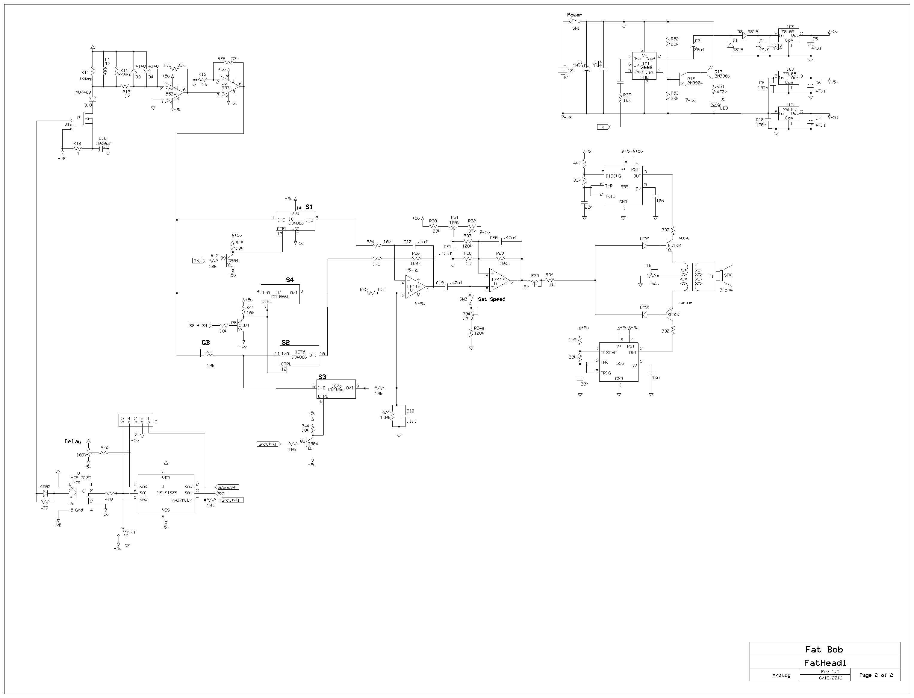

                              some information that I have collected in the past.
