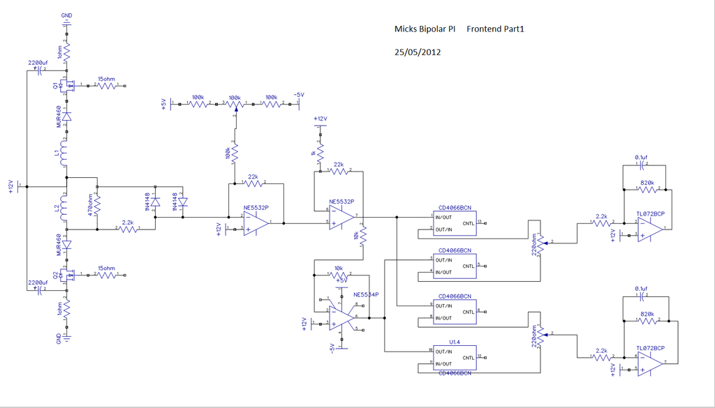

                  MicksTV presented a similar(Manta) PI circuit using a center tapped coil. Unfortunately Mick would upload his schematics and photos to hosting sights and many are lost now.
                    I think you are hoping for something that is impossible. The ground signal is the same as a target, it is a result of induced currents. If it nulls out the ground, it will null out the targets. In bi-polar you get ef cancel because it is unaffected by the induced currents and does not change polarities. Ground balance on bi-polar is just like any other pi except you can ignore the ef. early target minus later GB signal.
                    @Green the ground does invert. So it's not a break through for GB
                    Hi Altra, I miss mickstv's posts, is this the one you were thinking of ?, I may have another here somewhere.
                      Hi 6666, yes that's the one, thanks for posting it. He also posted a p-channel version with a differential pre-amp. The only difference between the Mick's drawing and the Manta. Is the series diodes are replaced with mosfets in the Manta. These block the opposing flyback voltage from going back into the low voltage supply, just like the series diodes.
