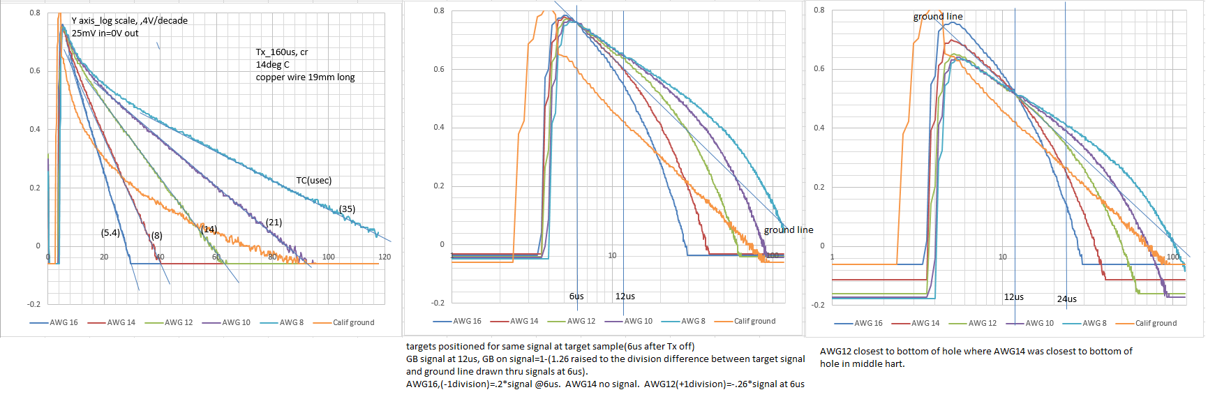

      Still trying to define the problem. Charted some signals that I think should be similar to gold rings? Trying to understand the advantage of sampling with an A-D vs an integrator. Signal greater with an A-D but don't know if S/N is better. Planning on charting US coins. Wondering if charts make sense or should be done different. Is doubling target sample time for ground sample time best or would a different ground sample time be better?

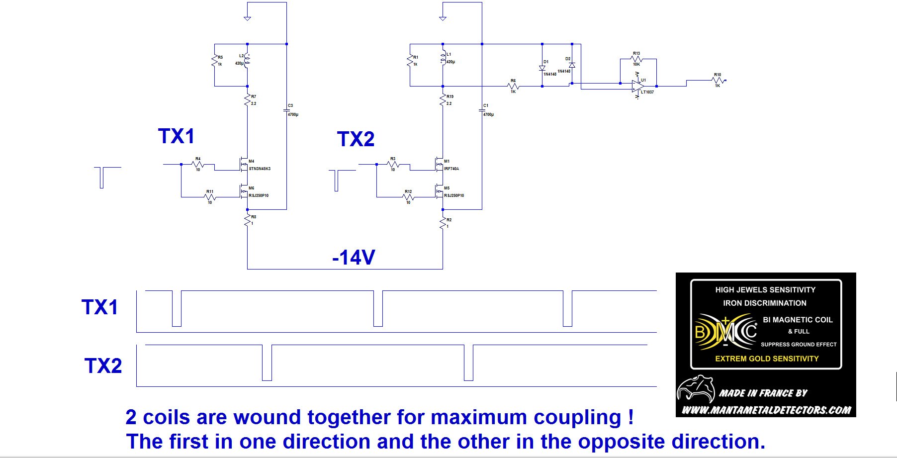

                      In the Manta thread, the author states that the two coils are wound together for maximum coupling, yet they are wound in opposite directions.
                      I'm trying to visualize this arrangement. Are the two coils of the same diameter?
                      Next he states that the two coils have a resonance that HARMONIZE. This could be important point.
                      Next he states that the ground cancels (-g+g). So we can infer that there are two seperate channels that are summed, with one of the coils acting as the recieve coil for both transmit pulses from the two coils, however one of the recieved signals will contain a negative ground component (-g) because the coils are counter-wound(180 degrees) to each other.
                      Now when he states that the two coils have resonances which harmonize, Does he mean at full resonance (the fundamental frequency f)? or at some harmonic interval?

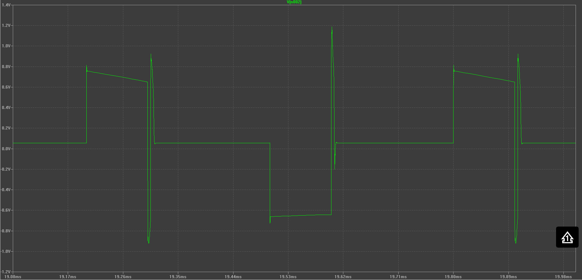

                        His second reply contains some scope pictures. https://www.geotech1.com/forums/atta...5&d=1462902729 The signals are opposite. After pulse decay nonferrous targets and ground have the same polarity so I'm wondering how it cancels ground and not the target.
                          He stated he ends up with 2V. Don't know how.
                            There is pulse 1 and pulse 2, and pulse 1 Rx then pulse 2 Rx
                            So pulse 1 first then pulse 1 rx, followed by pulse 2 and pulse 2 rx
                            Pulse 1 rx =+v+s (where s is ground effect)
                            Pulse 2 rx = +(-v+s)=+v-s (+ sign because the rx coil in counterwound 180 degrees and pulse 2 comes from coil 2)
                            Pulse 1 rx ADDED to pulse 2 rx=(+v+s)+(+v-s)=2v. (s is cancelled)
                            So I speculated two gated channels followed by a summing amplifier later down the signal path. I am just guessing.
                              Because with one recieve coil and two pulse sources (one in antiphase), only ground is cancelled. This is the author's assertion, I don't know.
                                In the Manta thread there is a schematic: BMC TECHNOLOGY MANTAMETALDETECTORS.jpg
                                This show that the two coils are energized in the same polarity in the circuit but their magnetic polarities are opposite by the location of a 'dot' on the coil symbol.
                                The way to wind such a coil is use bi-filar wire then connect the each TX MOSFET on opposite ends.
                                Is a scope capture that show of RX signal. Seen is the opposite polarity of the TX pulses.
                                What is not as obvious is the fly-back 'decay' polarities are the same. This is due to the coupling.
                                I first thought that the GB cancellation equation they presented was wrong but studing the schematic and scope capture I see have this could work.
