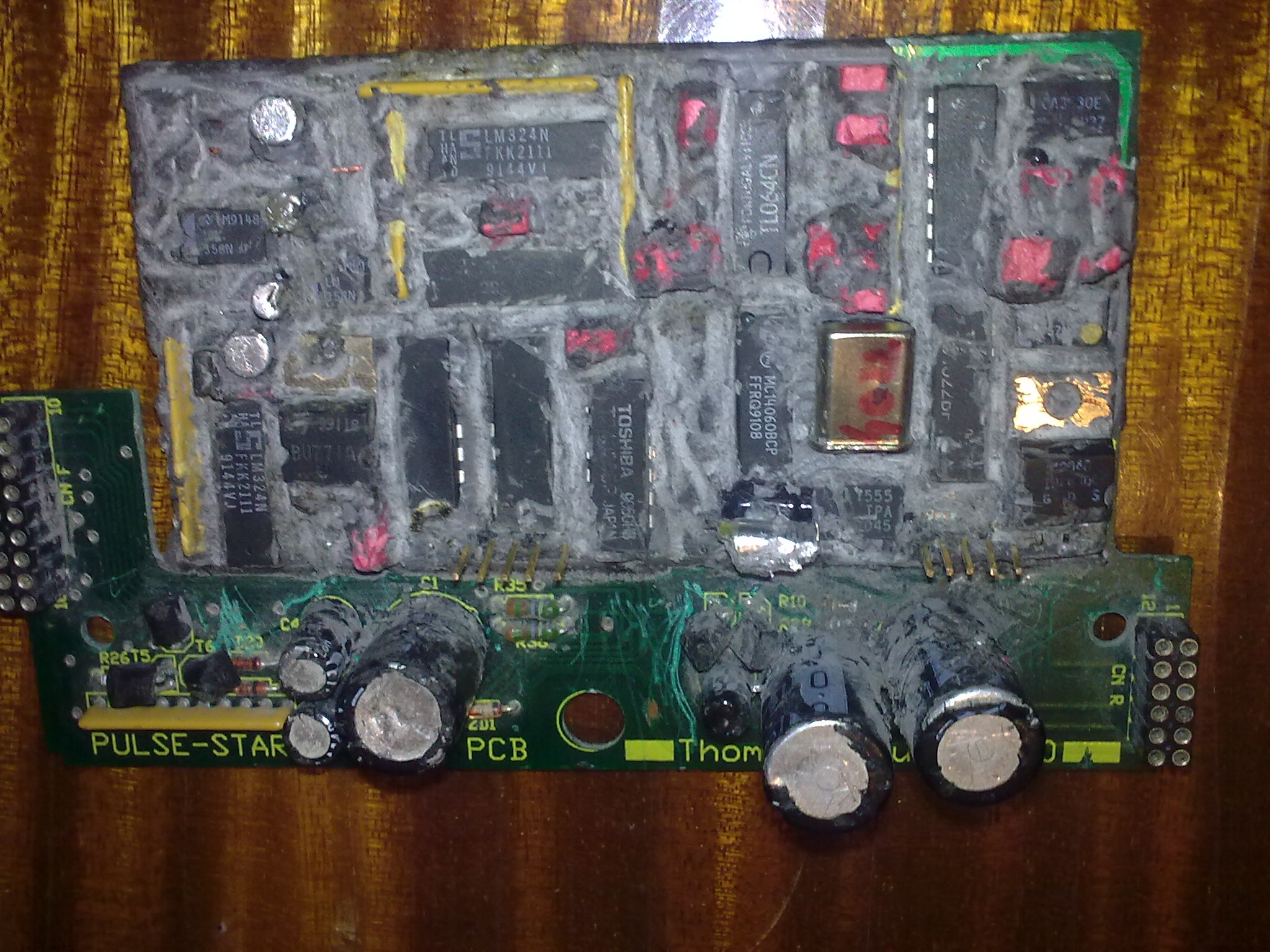

    • Here is a photo of the original pcb motherboard where most of the ic components can be clearly identified​..

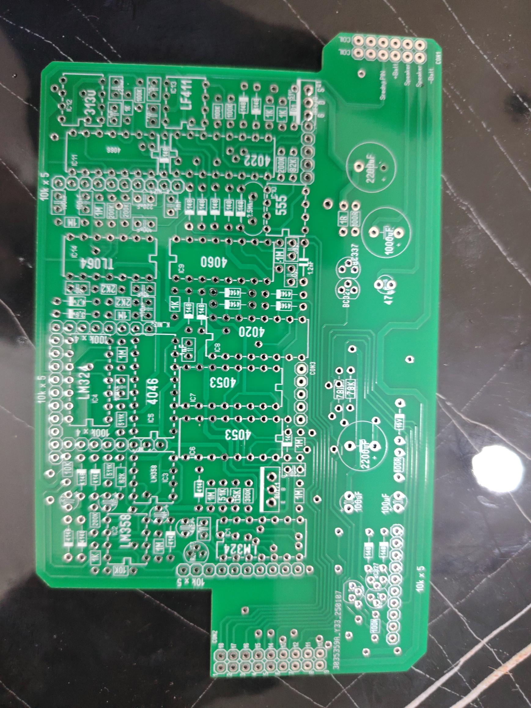

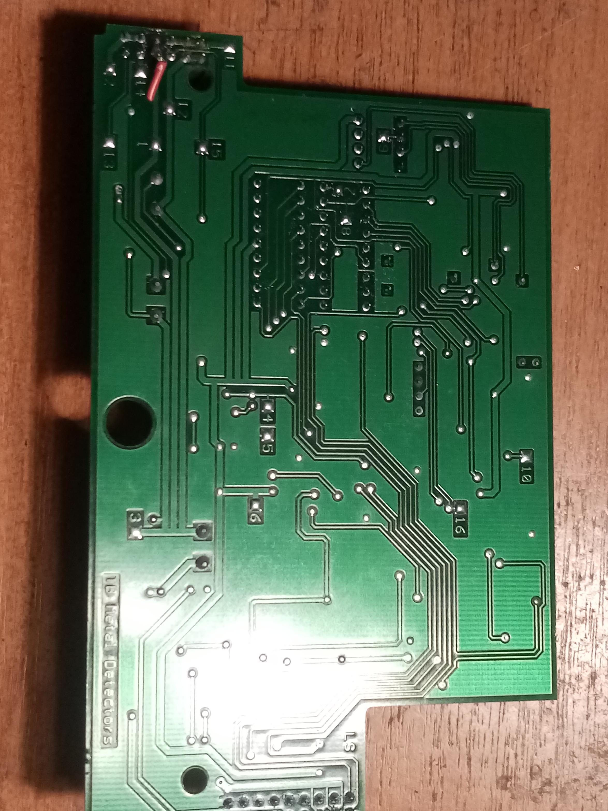

                      • A slightly improved drawing, now the corners of the lines are almost 100% of the original drawing! Gerber file saved for creation..​
                        • I can't see the Gerber files. I checked the Layout 6 file and some values ​​have changed; for example, R from 200k is now 220k.
                          The 1 ohm resistor of the IRF630 power supply is now 10 ohms.
                          I installed 10 ohms on my board and haven't noticed any performance degradation with air testing. There has been a slight decrease in current draw and an improvement in the power supply ripple.​
                            Hi Jose, there is no particular improvement, but these are real values! It's not 1r, but 10r, 200k is 220k and in some places the capacitors are 82nf not 100nf! 100nf was put because of easier procurement here in Serbia. So basically there won't be any big improvement in range!These are those original component values! And if there is no gerber file, then I accidentally sent something when I put it in the zip.. I will post it in the next days, although it can be done from Sprint so that everyone can export gerber..

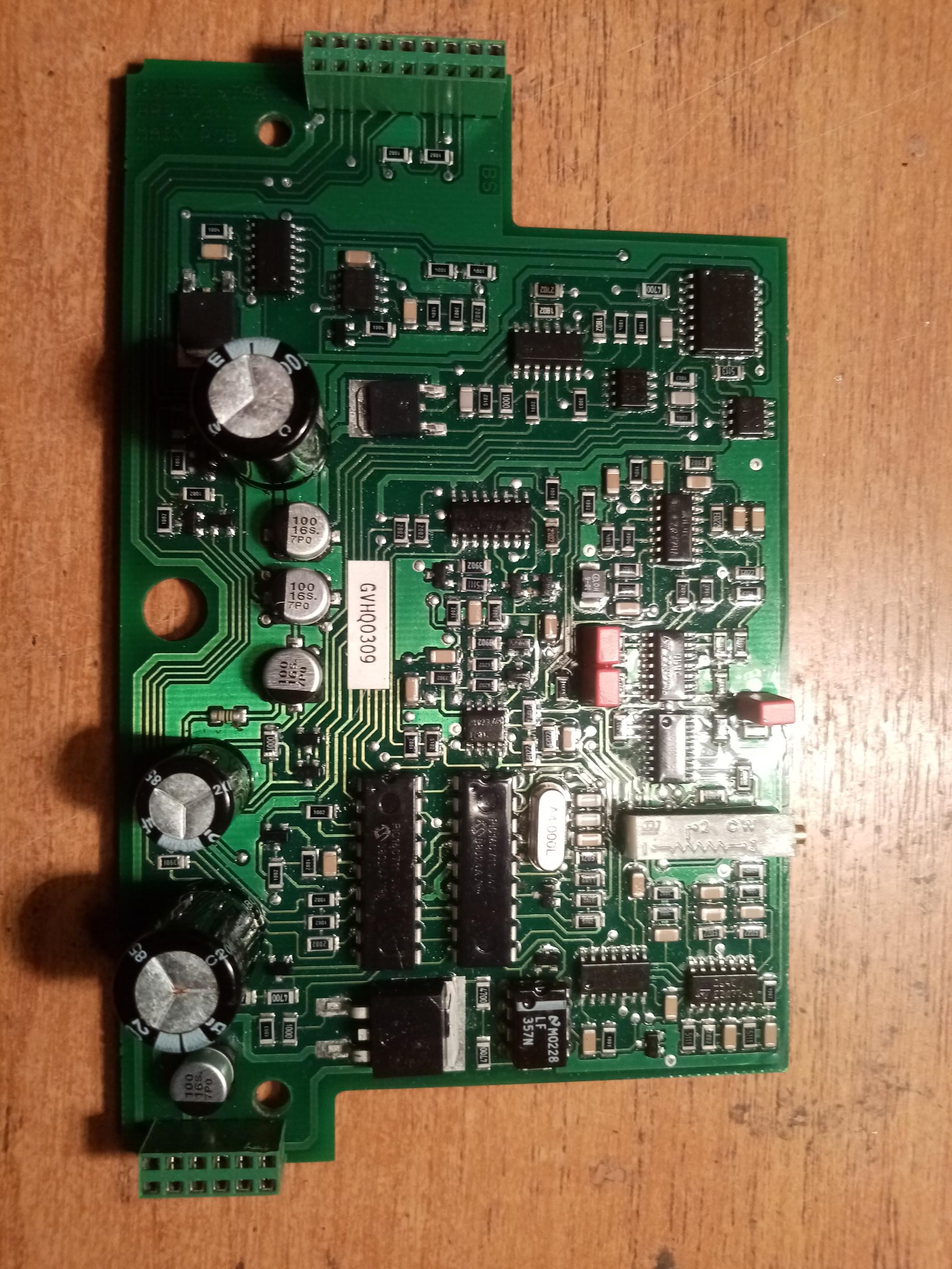

                            • Here are the photos of the Pulse Star 2 Pro. It can be seen that it has two processors these days since I repaired it and tested its depth. On the way, I will see the pulse width and frequency and other parameters.
