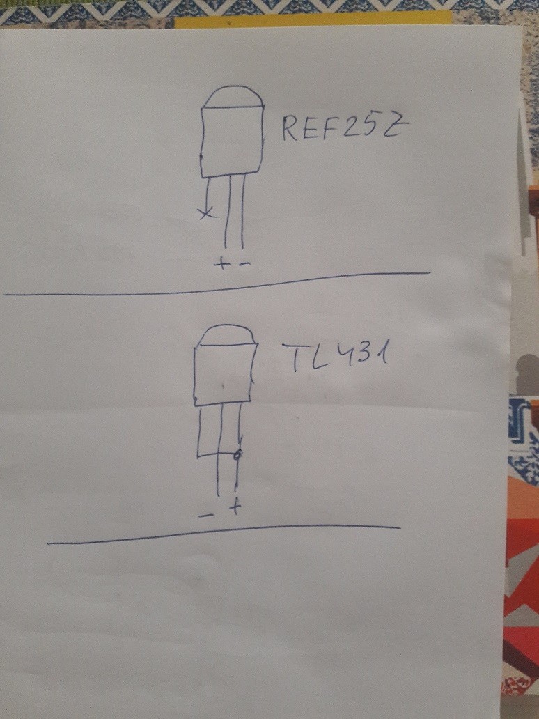

    • Hi Ssqqar12,
      No problem to use TL431 instead of REF25Z. Just solder it on the board according this scheme.
        Hi Ssqqar12,
        Hi Ssqqar12,
        This means, according to the modification, it is placed in reverse.​I mean the opposite of negative and positive according to the diagram you drew.
        • Yes, TL431 have to be placed in reverse of REF25Z. The hole for MINUS of REF25Z have to be used for MINUS of TL431. The hole for PLUS of REF25Z have to be used for PLUS of TL431. The third hole under REF25Z (not connected anywhere ) will rest not used.
