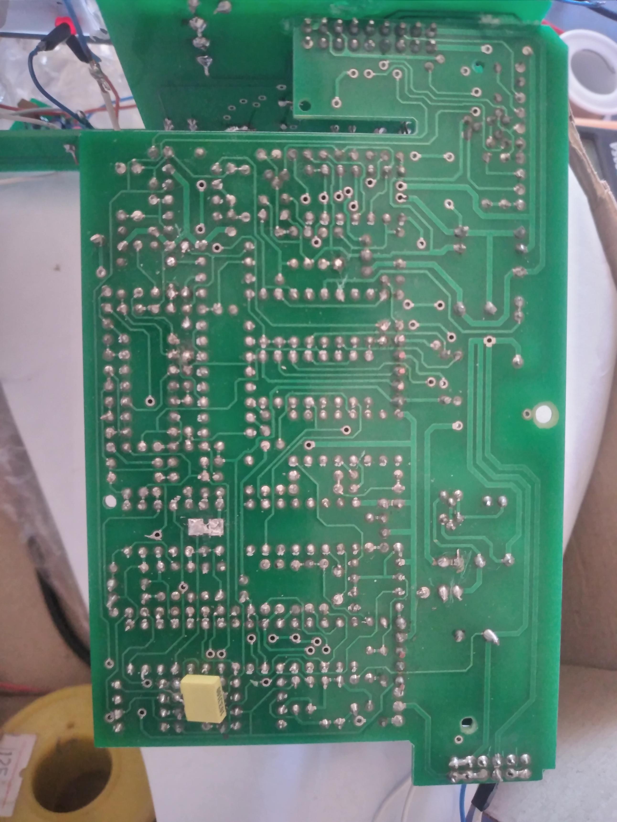

  • You are doing something wrong or you have connected some lines at some point during soldering. Get a better soldering iron for electronics, not for construction gutters. Or some of your components are faulty. What doesn't work? As we can all see, you haven't soldered everything yet and you claim that it doesn't work.
      • Originally posted by Mehranfar View Post
        Yes, there is probably contact between tracks. Check with a multimeter for a possible short circuit.
        • Originally posted by nejdet View Post
          There is no connection. I checked.
              Okay! You obviously have an original device. Show us where we are wrong, are you trying to clone this device or are you testing us?
                Well, I compared the PCB file with the original device and found a few errors.
                  • You must be joking. This is an empty box!
                      Do you have a clear picture of the original board?
                        There is no connection. I checked. When the device turns on, it just beeps and I don't know what the problem is.
                        • Under 1, are you drunk or crazy? The second record does not exist and it is the original. Under 2, you should explain what is not working. If it beeps without the coil and works with the coil on then replace Lf357 with 411 and probably some ic is faulty replace tl064 with lf444.
                            Yes, it beeps without a coil. lf411
                            • Does it work with the coil on? Did you put a resistor across the coil?
                              • I didn't connect a coil, without a coil, the device beeps when I turn it on.
