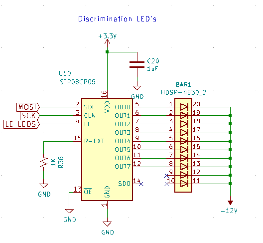

    The LED driver arrived and promptly blew up when I tried it. I had assumed the FET's in the output of the driver would not have body diodes, and the schematic of
    the internals seems to verify this, however, all the outputs conducted momentarily with no current limit and smoked the chip .. (it is a STP08CP05MTR)
    If you have a look at the schematic attached, I am driving the LED's through the FET's with reverse currrent i.e -12v compared to ground. I had assumed that would be ok, as once turned on, mosfet's don't care in which direction the current flows .. they act as a resistor ..
    I think they only would have had problems if there was a body diode, which would have conducted instead ..
    Have a look at how I wired it up and see what you guy's think ...
    The whole reason for doing it this way, is because I need to level shift the FPGA 0..3v to the -12v to drive the LED's .. (because GND is the positive of the 12v battery)
    Maybe there is a better way?
    Cheers

                • Never pull an IC input or output below the negative supply rail, disaster is guaranteed. If it's not FET body diodes ( which pretty much every MOSFET has ) it's parasitic diodes or transistors inherent in the manufacture of IC's. There's a well-known phenomena called SCR-latchup that can occur with certain IC inputs.
                  https://en.wikipedia.org/wiki/Latch-up
                  Also, never apply more than the positive rail voltage to any IC inputs/outputs, while not so troublesome, especially if the current is limited by a resistor, for example, it's still best avoided. Use of a diode ( preferably a Schottky type for low forward voltage drop ) can protect IC pins from these mishaps.
                  There is a bizarre phenomena where an IC can be functional, with no positive power supply, and I have actually witnessed it myself. It was a 4000-series CMOS gate package. When one of the inputs was logic high, an internal parasitic diode conducted to the positive power supply, hence powering the chip. It was effectively running at 11V instead of 12V, but was fully functional. Only if there were no inputs High would the power disappear. The cause of the missing power? The leaded IC was inserted in a socket, and the power pin had 'dog-legged' during insertion, and had not made contact with the socket.
                  I haven't looked at the datasheet for this driver chip, but I assume it monitors the current using a series resistor in the Source of the FET, and uses this to set the serially-programmed current control. This obviously is incapable of working the wrong way round.

                  • I looked at your schematic and the data sheet.
                    Skippy got what happened, there are always intrinsic diodes in MOSFETs.
                    The data sheet is a bit skimpy but the clue is in the MAX ratings.
                    Vo Output voltage -0.5 to 20 V
                    this implys that the Voltage on an output pin must never go below ground.
                    Can you flip the LEDs around and then power them from a positive 5 to 12V?

                        Guys, I am sorry I brought it up.
                        I know the correct way to use this driver, I just could not do that with a ground based on +12v. I need to use the 12v to drive the led's to get the brightness I need, I can't use the +5v rail, as it is derived from a capacitive switcher (LT1054) that is already maxed out supplying the rest of the circuit.
                        I could use another LT1054 to give me another +12v that is above GND (Battery +12v) and driver the LED's of that, or I could put an isolation chip on the SPI lines (Adum160), that way I can run the LED's and driver straight off the battery and isolate drive them ...
                        @Skippy
                        You are mostly correct, except for the fact that you can run a MOSFET at full rated current in reverse (as long as the mosfet does not have a body diode) I have done that many times (I have been an Electronics Engineer of some 50 years ... so know a couple of tricks ..) I just wasn't expecting the driver to have body diodes on the Fet's, my mistake, but you are correct I had forgotten about the current limiting circuit ... the datasheet does not have any detail on the method of current limiting, and the schematic of the chip shows no body diode on the fets ... very bare info ..

                            • Quote:"@Skippy, you are mostly correct"
                              What's with the 'mostly' ? Did you read my note about synchronous rectifiers, using power FET's the 'wrong way' round ? And if you're using it the 'wrong way', it doesn't matter if there's a diode internal to the FET or not.
                              And yes, the IC datasheet will skimp on such details like body diodes, as it's assumed there will be such diodes, and they will never conduct, as the output pin will never go negative by more than 0.5V, as that is stated in the design absolute max figures.
                              I'm curious as to what power FET's you've come across that don't have body diodes. I don't ever recall seeing one. I've used small-signal MOSFET's, the type with seperate gate, source, drain and substrate, and there's a 4000-series CMOS part ( the CD4007 ) that can be used that way, they are diode-free, and dual-gate RF FET's like 3N201's also may be diode-free. But all power devices seem inherently lumped with a diode. I've seen ones with additional diodes, either fast p-n junction or schottky types, as the intrinsic body diode is slow.
                              35 years of professional electronics design experience speaking here.
                              Edit: I had to Google the subject of body diodes ... looks like transistors made with the Silicon-on-Insulator process can get round having body diodes. SOI is reserved for rad-hard parts, eg for spacecraft and EMP-resistant military hardware, so not really applicable to our little toys.
                              • And regarding a fix for your design problem:
