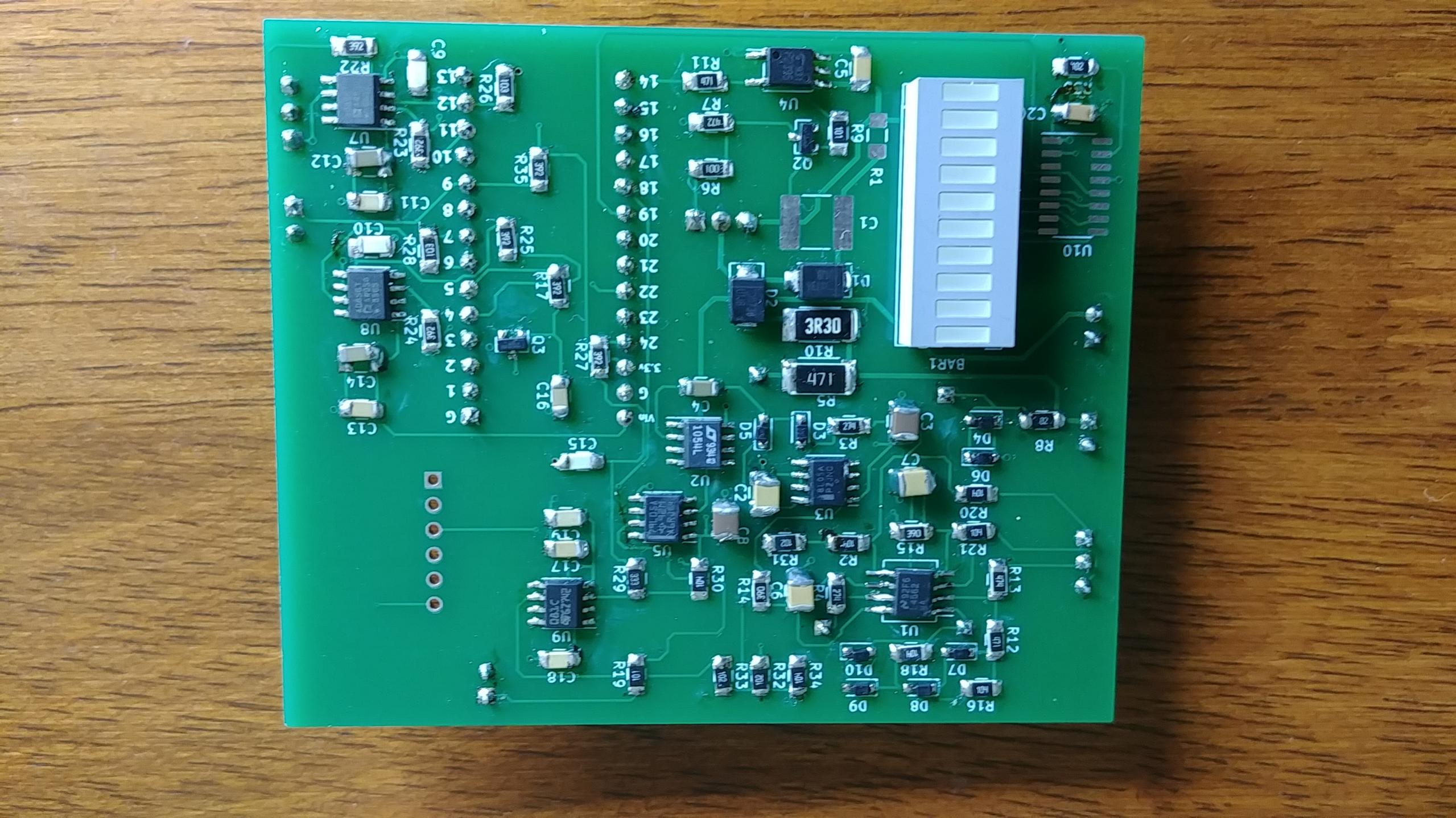

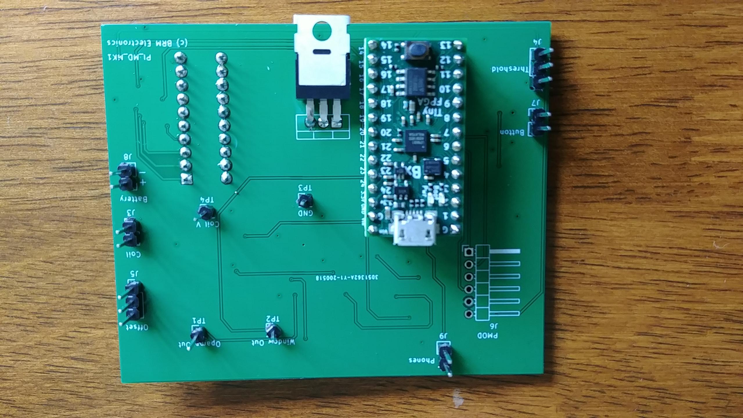

                        • The connectors to the TinyFPGA-BX have arrived ... attached is photos of the board.
                          I am starting testing, although difficult, as my Workshop has had a Rat die in the walls, and the stink is unbearable .. Have had to work elsewhere.
                          I will see what I can get done ..
                          The only part I am waiting for is the LED driver, but I can do lot's of testing before that arrives ..

                          • Update: Have the board working, at least detecting & discriminating metals .. (Found two errors .. which will be fixed on the MK2 version)
                            I am now going to do some fine tuning and get the LED array indicating detected metals once the driver arrives (RS is a bit slow at the moment) ..
