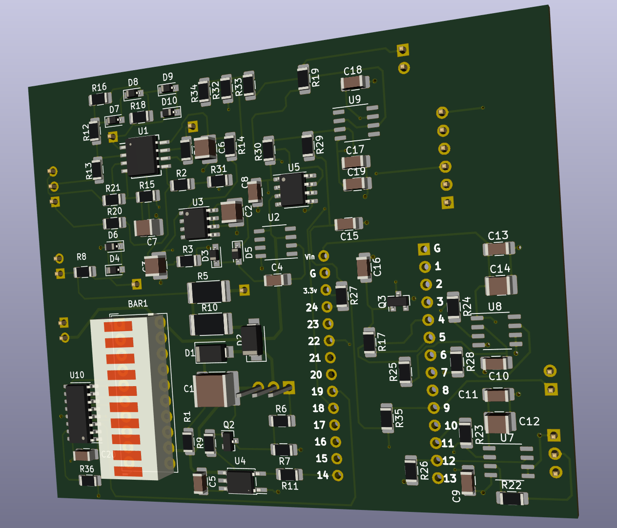

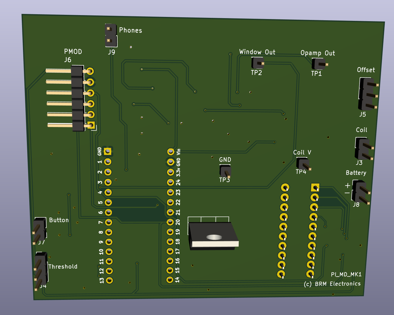

                Here is what the board looks like .. all components are 1206 or bigger ... my eyes are getting old
                • Are you selling the pcb pre made,you lost me with smd
                  • As mentioned several posts back I will be selling as a kit .. (pre-made)
                    • Do you have an aprox price yet ?
                      • Not yet.. Don't even know what everything costs yet..
