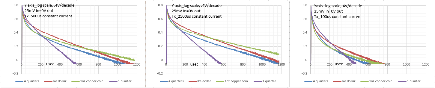

                Chart with stacked nickels and stacked quarters. Four quarters decay faster than 1 quarter at start of decay and slower latter in the decay with a PI. What happens when IDing stacked coins with a VLF?
                Can a target thick enough to be effected by skin effect decay straight line on a linear X log Y chart?
                Ironically, most White's VDI machines will ID 2 stacked quarters the same as a half dollar, and 4 quarters the same as a silver dollar. Other detectors will give somewhat similar results.
                All targets are subject to skin effect. It's a more dominant effect on tau than the raw conductivity of the metal.
                    All targets are subject to skin effect. It's a more dominant effect on tau than the raw conductivity of the metal. .
                    Log amplifier failed on my tester awhile back. Replaced it and did some testing to see if the repair worked. The target current should have decayed to zero by the end of the 2500us Tx. Tx off(maybe 1us pulse)then excites the target. Should have just skin current at start of decay. Higher resistance, steeper slope, lower TC which charts show. At start of decay, 1 quarter has a higher TC than the other targets. Would be interested where in the decay curve SaltyDog is calculating the slope, assuming he is IDing targets based on decay slope.

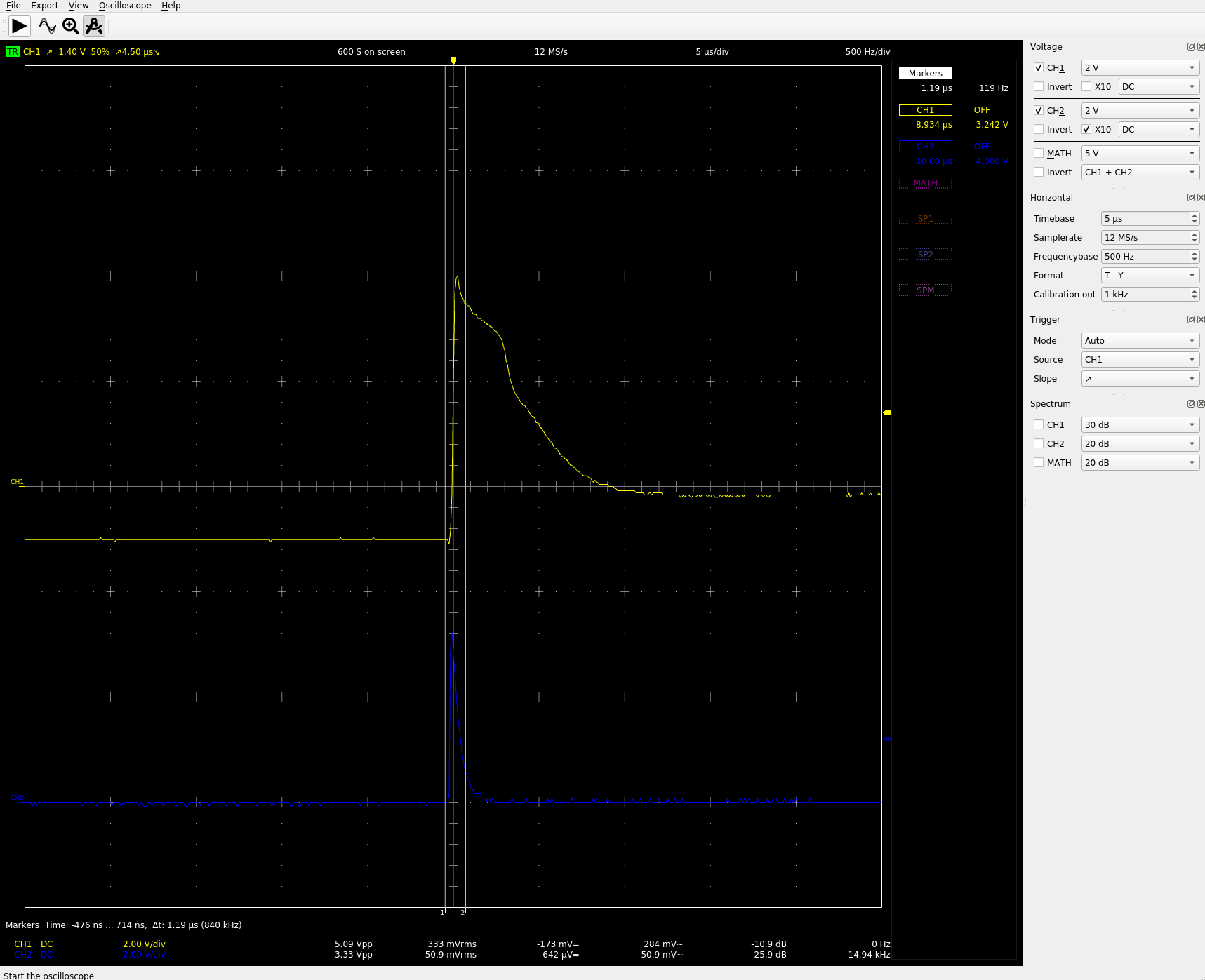

                      • Hi,
                        Yes, I had seen that thread. I all trialing some other improvements with the preamp at the moment, working with another forum member on that part.
                        With some improvements, I have the main part of the discharge curve happening in 5us now .. you will notice there is no preamp saturation ..
                        I am still waiting on parts to finish some other idea's ..
                        Attached is preamp output, the blue trace is the TX pulse and finishes in 2us.
                          Decay charts with some different materials.
                          (third chart)1x1in targets cut from aluminum can, lead sheet and copper clad board have almost the same decay rate. Big difference between 1x1in aluminum foil and aluminum bar targets. Big difference between 1x1in copper clad and piece cut from copper tubing.
                          Second chart is an example of decay slopes with Carl's 1x1in aluminum foil targets(to 16 layers, didn't try 32 layers)
                          Hi Green,
                          How are you producing those TC charts? i.e. what test gear configuration are you using?
                          • Originally posted by Elliot View Post
                            Hi Green,
                            https://www.geotech1.com/forums/show...567#post253567 Using Excel to get multiple targets on the same chart.
                            I first charted the decay slopes linear X log Y by recording amplifier out with a mono coil. A no target recording and a target recording, subtracted the no target recording from the target recording with Excel and charted. Wanted to try a log amplifier so I could see log amplitude decay on the scope. Either way gives similar results.
