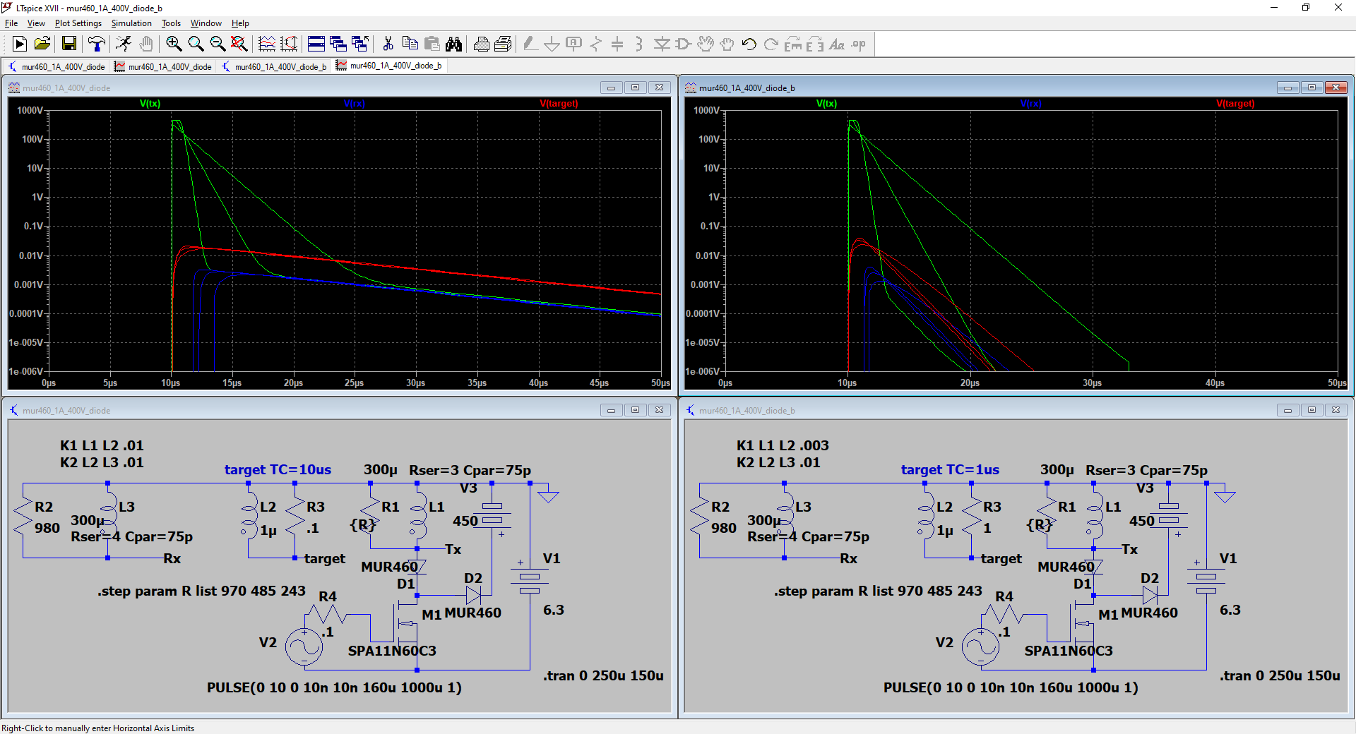

            The coil Tx above was done with constant rate 160us on time with 1A peak. The coil is fast so mosfet does avalanche at about 560V. Not sure what you are calculating, I'm thinking di/dt=E/L. 1.18A/us at avalanche or 2.1ma/us at 1 coil Volt. Only time decay rate is constant is at avalanche. Maybe wrong?
            Maybe average current decay rate. Peak current/time to what lower current? Wondered how much decay rate effects target signal. Tried a spice simulation changing Rd to control decay rate, critical damped resistance and critical damped resistance/(2 or 4).
            Two different targets, 1us TC and 10us TC. With 10us TC target, 3us after turnoff target signal is the same, 7us after turnoff Rx signal is the same and after 20us Tx receive signal is close to same with most damped being slightly higher.
            With the 1us target, 1us after turnoff the more damped target signals are higher, 2us after the more damped Rx signals are higher, the critical damped is the only Tx decay the target is visible.
            Tx damping has little effect on target and IB Rx signal. Big effect on how soon Tx signal can be looked at with a mono coil.

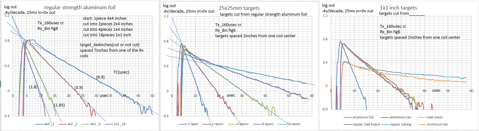

              Decay charts with some different materials.
              (third chart)1x1in targets cut from aluminum can, lead sheet and copper clad board have almost the same decay rate. Big difference between 1x1in aluminum foil and aluminum bar targets. Big difference between 1x1in copper clad and piece cut from copper tubing.
              Second chart is an example of decay slopes with Carl's 1x1in aluminum foil targets(to 16 layers, didn't try 32 layers)

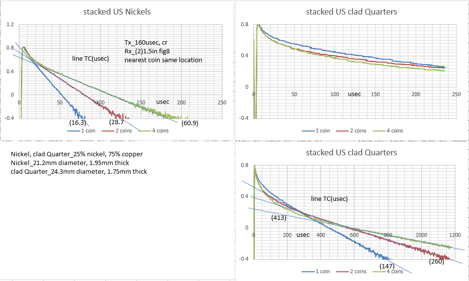

                              Chart with stacked nickels and stacked quarters. Four quarters decay faster than 1 quarter at start of decay and slower latter in the decay with a PI. What happens when IDing stacked coins with a VLF?
                              Can a target thick enough to be effected by skin effect decay straight line on a linear X log Y chart?
