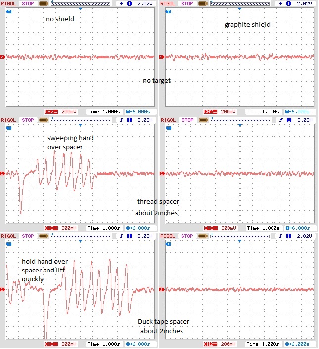

      The coil is stationary, the hand and targets sweep across the coil at a measured distance controlled by a spacer.

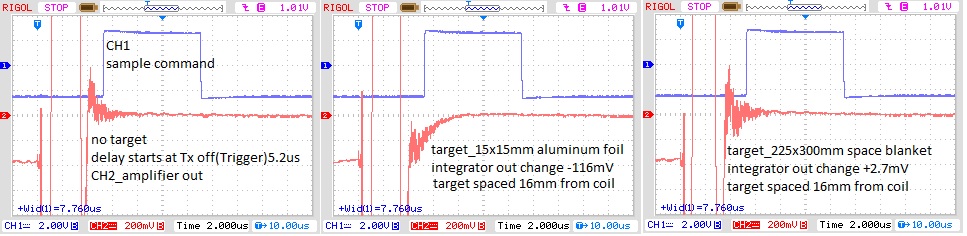

      Thanks. My error, (10 sweeps)isn't static. I included the space blanket because it's something I tried. Don't think space blanket is a good test. Think hand test might be good because shielding reduces the effect a lot and shielding doesn't seem to effect target signal strength? Wondering how much different the signal would be for a non shielded coil if 5 different persons swept their hand over the coil. Been trying foam without success so far.
      • Another test. Recorded differentiator output. Amplifier, integrator then differentiator. Used a spool of thread or a new roll of Duck masking tape for spacer. About 2inch spacer between coil and hand. Think increased signal with Duck tape spacer is due to increased dielectric(more area and maybe higher dielectric)?
        Spacer was centered over one of the 8in fig8 Rx coils. Hand was swept over spacer. Didn't see a signal change when sweeping hand over shielded coil.
          Sweeping and holding the hand over spacer and removing quickly are good tests. Looking at the amplitude of the target signal of about 400mV? peak to peak and no target response with shielded coil suggests that the shielding is very good.
          The question now is how much is the target response affected by the shield, with your smallest target?
          I feel the large space blanket test is not much use. My small space blanket test with 15x15mm is close to the minimum I can detect with this 200mm coil. I don't know what natural target to compare it with though.
          My smallest target is usually a #9 lead shot, supposed to be comparable with a small gold nugget. I don't have any gold nugget to play with.
          I suspect that the environmental static situation might strongly affect all static test and also the hand tests. A big fat hand might respond quite differently then a small skinny hand. Just guessing.
          When living near the ocean, I never saw static sparks. Up here in the mountains in winter there is static everywhere. One gets electric shocks when putting a foot on the ground when stepping out of a car, touching a door knob etc.

                Wondering what we are doing different that you can detect a 15x15mm piece of space blanket. I see a change at integrator out with the 225x300mm piece, opposite polarity I would expect. Don't see a change at amplifier out during sample time, maybe some - change during coil decay. The 15x15mm foil has a TC of about 1us and can easily see a change during sample time at amplifier out.

                  "wondering what we are doing different" Well, everything. Your PI is fairly conventional. Your tests are excellent. The data that you publish is very useful and I always look at it and appreciate all the good work you put into it. I use it as reference.
                  My own PI is still experimental. It is radically different from any other PI I know of. That is my goal. To design a PI that is totally different. Completely new.
                  To know if my PI design is any good I need to compare with other PI. I am really grateful that you share your data so that I can compare.
                  When you mentioned a space blanket as test target it made me wonder if I could detect it. So I tried a 15x15mm piece.
                  Today I made tests with a #9 lead shot. I tried with pulses every 30us, then 25us then 20us then 15us. That is, one TX flyback every 15us. This worked best, but I only got 18mm distance from the 200mm concentric coil. I have seen way better than that, so the latest changes to the circuit obviously are not good.

                          • Today I made tests with a #9 lead shot. I tried with pulses every 30us, then 25us then 20us then 15us. That is, one TX flyback every 15us. This worked best, but I only got 18mm distance from the 200mm concentric coil. I have seen way better than that, so the latest changes to the circuit obviously are not good. from reply #145
                            Any thoughts why you got more distance before? Sampling #9 lead shot with a TC of .68us 1.5us sooner should increase the signal 10 times, maybe 90mm increase in detection depth with 200mm coil(hadn't noticed you were using a concentric coil, should make it easier to detect the shot but wouldn't get as large of increase in detection distance with 10 times the signal). What else could increase detection depth?
                            Sampling faster should decrease the noise. Is there a formula for expected decrease in noise? Did sampling faster make much difference for you?

                              The more samples you integrate, the better SNR gets. We can only integrate so many samples without slowing down the sweep speed too much. High repetition rate helps.
                              with a TC of about 0.7us, 15us is enough time for the signal to decay.
                              Today I got to 26mm for the #9, by narrowing the pass band of the filters.
