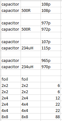

    Some testing with my capacitance meter. Measured a 100p and 1000p capacitor and with a 500 ohm resistor or 234uh flat spiral coil(not shielded) in series. Added resistance or inductance had little effect.
    Made some more capacitors, glued aluminum foil to each side of pieces cut from 3/16 foam board. The (2x4)one side, (4x4)opposite side measuring the same as (4x4) both sides surprised me. Foam boards were 4x4inches for both.
    Going to do more noise testing.
    Forgot the p after capacitance readings for the foil capacitors.

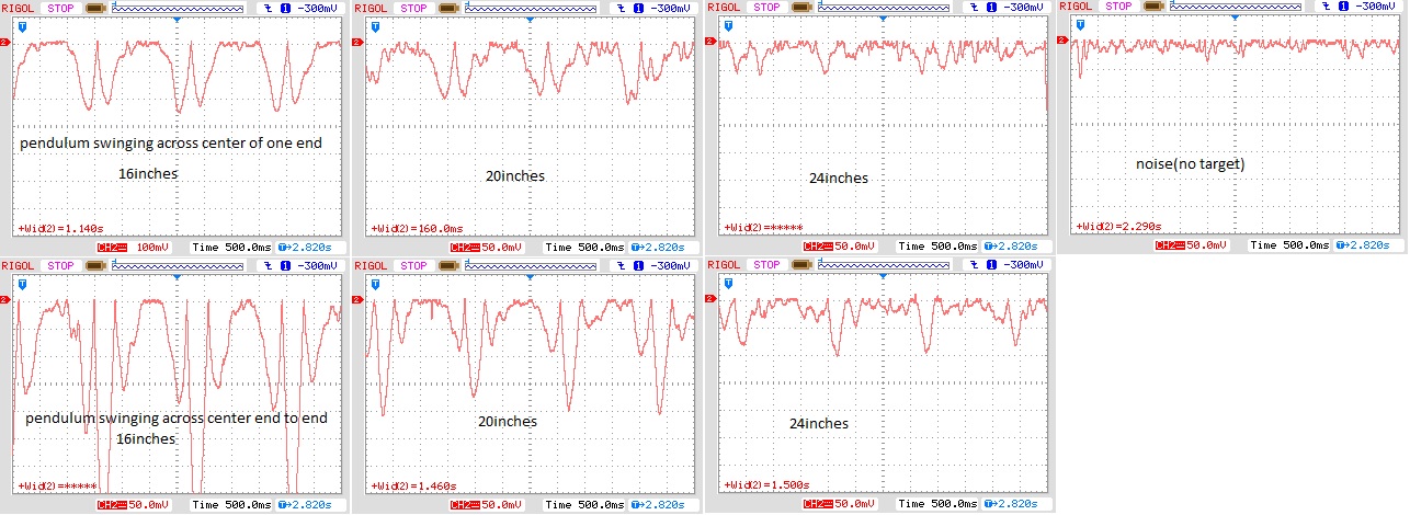

      More tests with the foam board.
      • Was playing with 24in fig8 coil couple days ago. Tried to detect a quarter at 24inches. To much noise, still haven't found source of noise that I can cancel by rotating the coil. Measured signal at AC coupled stage output absolute valued after the integrator with scope. Held a quarter at 16inches from coil and removed quickly, got about 400mV peak. The 24in coil looses about 1/2 the signal for every 4inch increase in distance at distances above 16inches. Should have about 100mV signal at 24inches. Get about 20mV peak noise with coil input jumpered. Signal should be greater than twice the noise so it looks like I could detect a quarter at 24inches if noise is low enough outside.
        Moved outside today. Fastened a quarter to a drink bottle swinging from a tree limb(pendulum). Laid coil on the ground, to much noise. Did some testing with coil touching ground, sheet of plastic between coil and ground and coil spaced 10inches above ground on a foam container(_26). Don't know why coil is noisier on the ground. Plastic probably helps since I didn't coat the coil after applying the graphite shield? Rotating the coil didn't seem to make much difference. Noise less than 40mV with coil spaced 10inches from ground, maybe could detect the quarter at 24inches. Tested the 30in DD also for noise, lot noisier.
        Pendulum test(_27)11 feet from limb to coil. Tx_324us, 1A peak constant rate. Delay_25us. Sample_103us. Tx rate_481pps. Got little over half the signal swinging from a pendulum that I got inside removing the quarter, integrator and differentiator TC not what they should be? Can see the quarter at 24in with target swinging across center of one coil but not good. Lot better when swinging from end to end. Shouldn't be a problem detecting a quarter with 4A peak Tx current.
        Next is learning how to minimize noise.

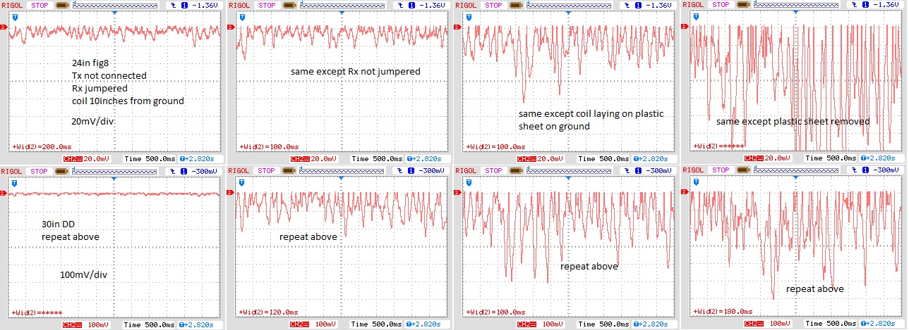

        • I remember, a long time ago when testing a large coil outdoors, I got a big reduction in noise by actually grounding the coil. Drive a non-ferrous rod into the ground with a wire going to the electronics ground of the coil. Worth a try.
            On the topic of graphite shielding, I have some Surfmaster coil shells that I believe have graphite shielding on the inside. I get about 1K with a simple test meter measurement across the diameter of the shell. For better accuracy it should be a measurement of the sheet resistivity which requires a slightly different technique.
            Eric.
            Thanks for the suggestion. Didn't have a problem with the 8in fig8 coil touching ground with my first detector. Didn't try to look at signal with a scope, threshold didn't seem to change raising or lowering the coil. Guessing scope and coil having different grounds might be the problem.
            I was a long way from detecting a quarter at 24inches with the 8inch coil and was wondering what it would take to detect a quarter at 24inches. Wasn't expecting to detect a quarter at 24inches with 1A peak, thinking maybe 4A peak. Been wondering what I would change to make it better. Looks like circuit noise(Rx jumpered)is about the same as figure8 coil connected with the coil off the ground. Figure8 canceling noise outside in the yard, not as much in the house. Reducing circuit noise would help, been using 1MHz amplifier response. Needing 25us delay, using lower frequency response might lower the noise? With target signal about 1/2 second swinging 1meter/second with a 24inch coil my integrator and differential time constants are probably to high, don't know how to calculate what they should be? Lower integrator and differential frequency might lower circuit noise and increase signal?
            Like the figure8 coil, not happy with my shielding procedure. Need to understand coil parameters better. Was thinking fewer turns since inductances were higher than calculated. Probably wouldn't help since circuit noise seems to control minimum signal.
            Any thoughts?

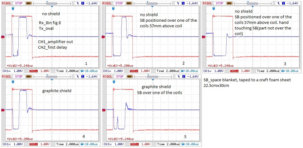

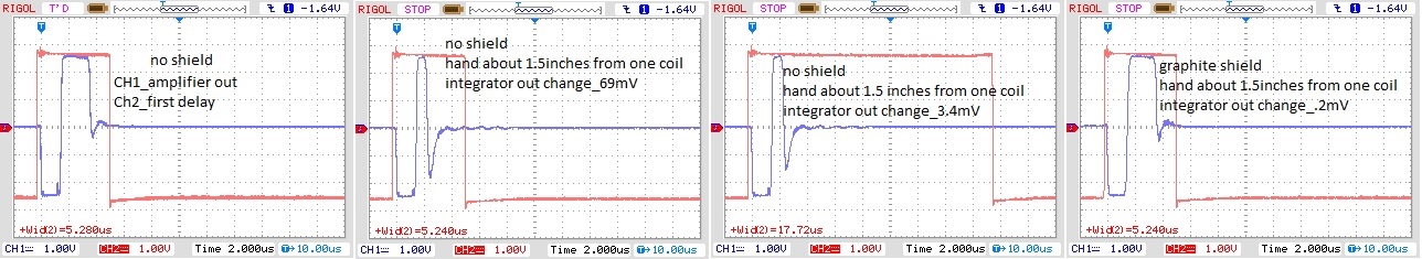

              A test using the hand to test for shield effectiveness. Coil(Rx 8in figure8, oval Tx)
              With no shield, big effect when coil decays. Longer delay before sampling reduces change, wasn't expecting a change with 17us delay.
              Is there a better way to test for shielding than using the hand?
              Want to try some other shielding than graphite.
              Any comments appreciated.
                US quarter at 8inches causes 50mV change at integrator out with 5.3us delay.

                  Tried another test. Cut a piece of space blanket 22.5cmx30cm and taped it to a piece of 2mm craft foam 22.5cmx30cm to replace the hand for the test. Got a negative going signal during coil decay(picture 2)when I placed the SB over one of the coils, same as placing my hand. As I was bringing my hand close to the SB edge not over the coil the signal went more negative. Think I might be increasing capacitance. Where I was touching the SB wasn't over the coil and wouldn't have caused a signal change if the SB wasn't there. Thought the SB might replace the hand for the shield test until I added the shield and tried it. SB causes a visible scope signal during coil decay where my hand doesn't. SB is a short time constant target, hand might be but if it is it's a lot shorter.

                    for the capacitive effect we need to find a non-conductive material that accepts a static charge. Does anybody have suggestions?
                    Years ago I used the hand test to judge the shield effectiveness. without shield the hand would be detected at some distance and the hand would also introduce high frequency noise from a distance.
                    The shielding would reduce the sensitivity a little and would remove most of the high frequency noise.
                    In the meantime the sensitivity achieved has increased a lot, so that the hand can easily be detected at a greater distance, even with a shield. Adding a strong shield reduces the sensitivity significantly.
                    At the end we will have to compromise between sensitivity and noise, as always.
