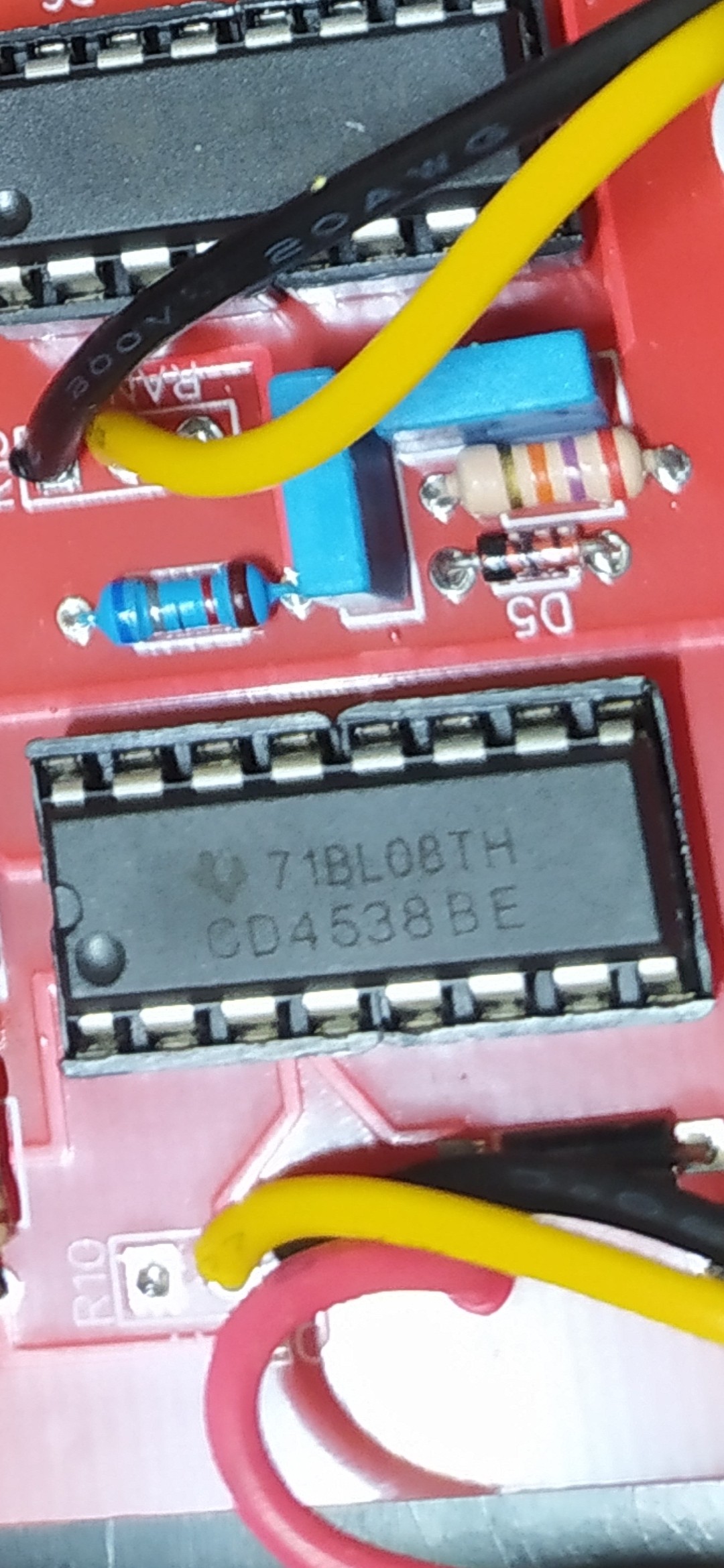

                          • I have all the original values ​​of C4,C5,C6-1.5nf R7-15k, R8-27k and R9-68k and I am reading on the oscilloscope T4 and T5 15us and it should be 45us. can anybody help me? Click image for larger version

                            • again strange working 4538. change them on another type.
                              in BOM file you must see a line
                              DD1 4538 HEF4538BP, 74HC4538N, MC14538BCP
                              do not use CD4538 (RCA)​
                              • Yes, I'm using the CD4538BE, I'll try to get other ci's to test. Thank you kt315. Click image for larger version
