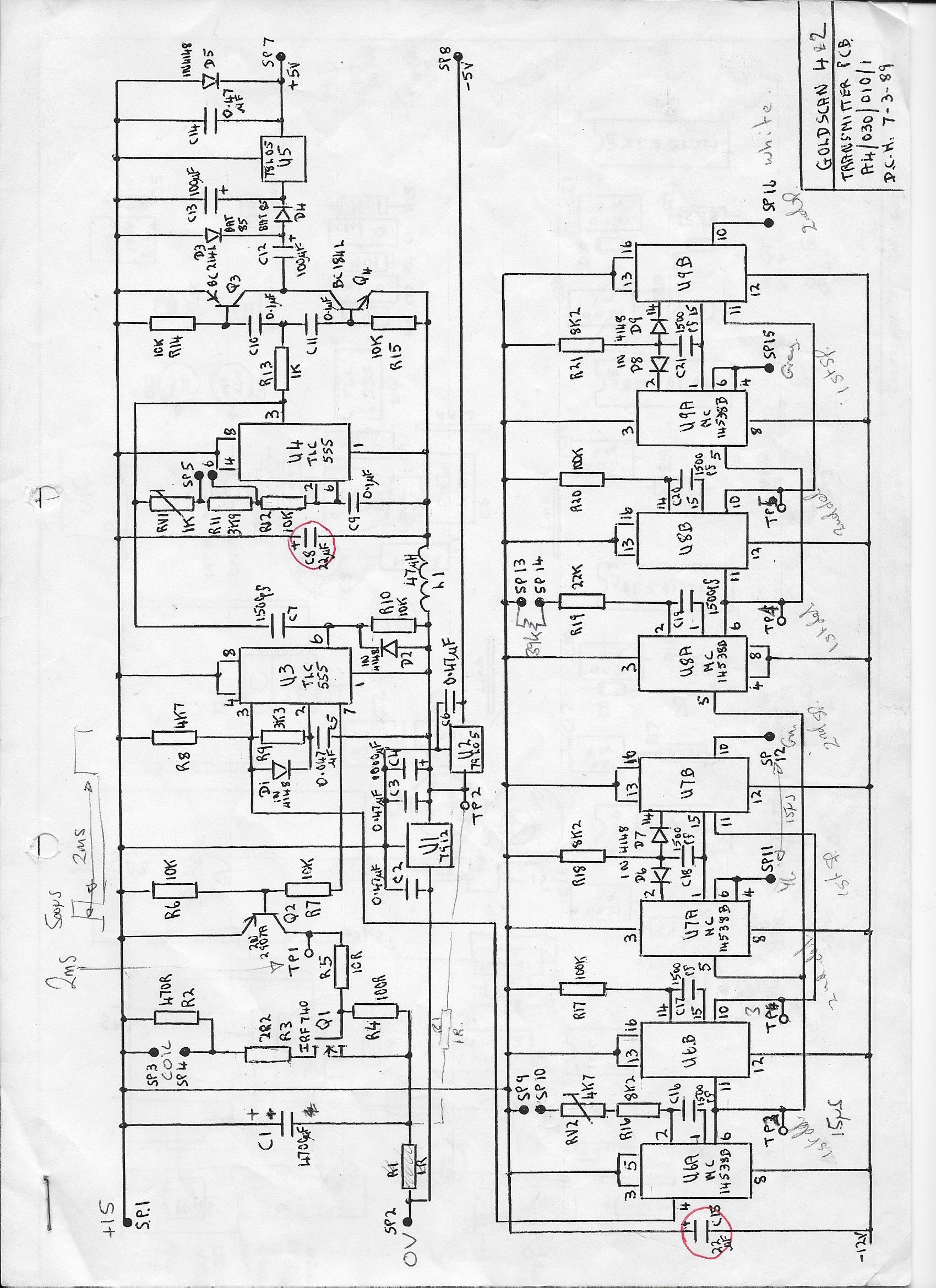

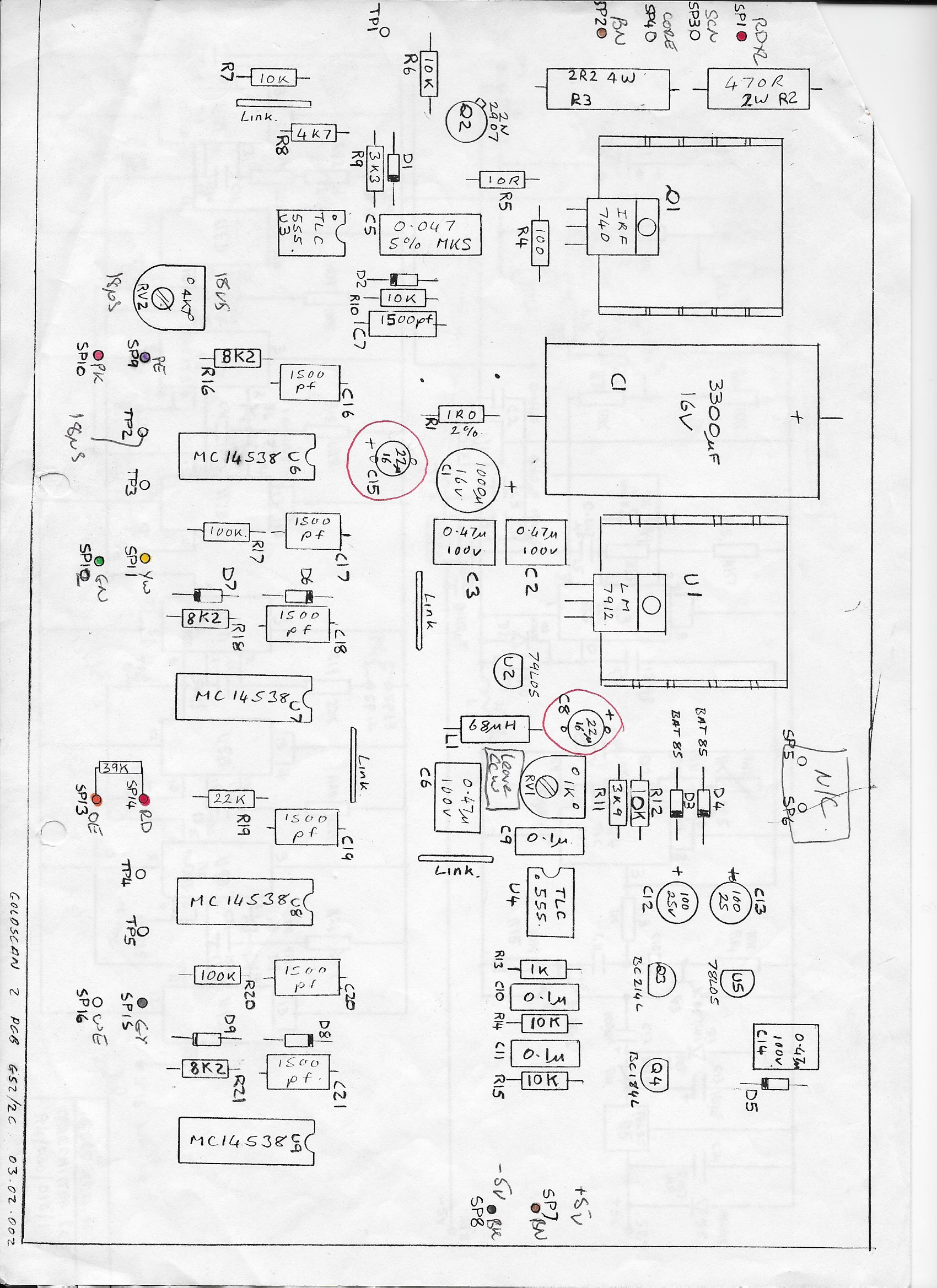

          Hi Paul, Found the Tx board info and located the two tantalum capacitors that failed. They were not where I thought they were in my previous post. Attached is a circuit diagram and board layout with the caps ringed in red. Both are across the -12V supply rail, so would blow quickly on a reverse voltage. Check the choke L1 to make sure it is not open circuit. If it was, there would be no +5V supply. I noticed that the board layout has a few things slightly different to yours, and a few extra components. This is because yours is an early one. It is basically the same though.
            [ATTACH]53878[/ATTACH] [ATTACH]53879[/ATTACH]
            Eric.
            Hi Eric, I've sent Bill's phone number to you by private message. I have noted the circled caps in question and the caps are now on order, hopefully that is the only damage done, I'll check L1 as you suggest shouldn't be much ado if there are other problems with those detailed diagrams. Thank you.
