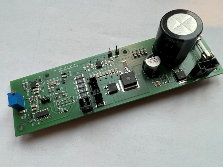

    Here is a picture of a earlier version to show the basic location of the logic on the RX circuit board. Towards the top center to the right of the larger vertical connector.
      nice structured drawing... and also the PCB makes a good impression. Specially the position of mounting holes for the PCB seems to be thought about prior placing components.​ I notice that you have placed the schematic symbols off-grid. Has this a reason? And which design program are you using?

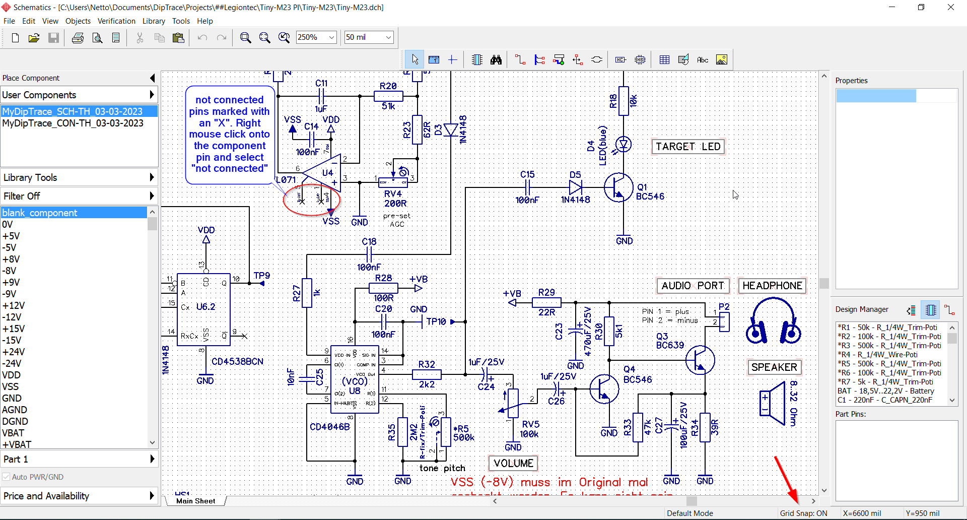

                    DipTrace.... very good. My favourite PCB program. With “components placed off-grid”, I mean that usually the schematic editor grid is set to 50mil. However, in your earlier posted schematic was the components placed somewhere irregular between the grid of 50mil. In the screen shot below, you can see in the status bar “Grid Snap: ON” in my DipTrace settings (bottom right corner). With the keyboard keys “FN + F11” you can enable / disable it.
                    Also you might run into problems if you do not mark unused component pins with an “X”. See example schematic (top left corner) below. DipTrace has an option for it.
                        I'm used to having grid sizes of 0.01 or 0.001 inches and would likely never use anything else. My diagrams have been using 0.001 inches. If you set the grid to 0.001 and display the grid and then zoom way in my system it appears to indicate that DipTracet may not be able to produce a grid of that size and snap to them. It is actually possible to place a wire close but not have an actual connection which should not be allowed if zoomed out. I figure that as long it can generate a circuit board without errors then all is good for now.
                        Placing the X for unconnected pins is good. I will look at configuring that since it may be an alert when a wire is placed but not actually connected as I mentioned or wire is deleted improperly and removes other segments that are then not noticed.
