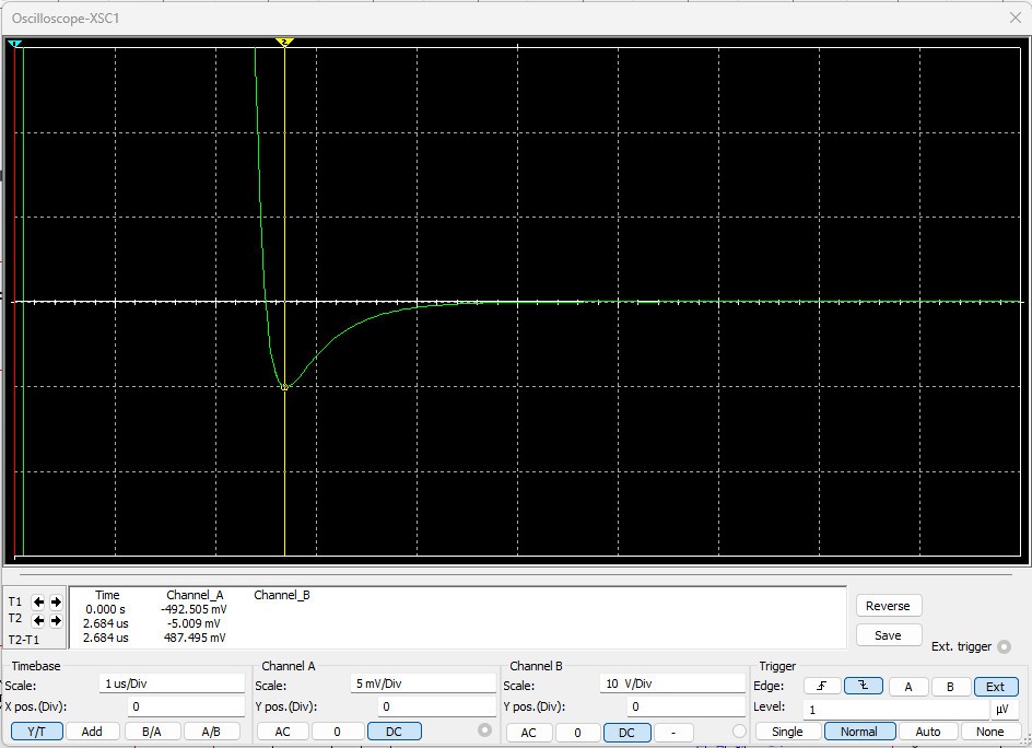

                      • In this post I will show my results for coil decay tests in where I set the damping so that there was a 5mV level of under damped, negative going peaking for both a resistive load only and active loading like that planned for the AGD26.1 with two different active devices. The measurement point was the Signal-Out in the circuit diagram, and uses a resistive and diode clamp with an added 10pf pcb trace capacitance. The injected test signal ha a frequency of 1Mhz.
                        The resistive load only. Time to decay to the 5mV undershoot level from the end of the TX pulse:
                        Took 4.418us, Injected 1Mhz signal level recovery at 13.112uV

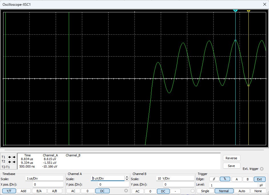

                        AGD26.1 circuit using LM7171. Time to decay to the 5mV undershoot level from the end of the TX pulse:
                        Took 2.684us, Injected 1Mhz signal level recovery at 10.166uV
                        AGD26.1 circuit using THS4631. Time to decay to the 5mV undershoot level from the end of the TX pulse:
                        Took 2.592us, Injected 1Mhz signal level recovery at 10.632uV
                        It is clear that a resistive only load when using a resistive and diode clamp into a RX front end gain stage presents a problem that is mostly due to the diodes becoming a open circuit near the most critical part of the receive signal. Increasing the value of the damping resistor will gain speed and get closer to active damping results but it will very rapidly increase the 5mv peak undershoot to a 100mv or more making the front end gain stages may not very happy. A low value resistor feeding the diode clamp will make this worse,while a high value resistor in creases noise and is really not very suitable with gain stages that have significant input offset currents.
                        I used the LM7171 for my initial tests for this application some time back but was never happy with it. Its output voltage limits is quite a be less than the rail voltages and it has significant input offset currents But it has the speed required for this application. The THS4631 appears to be a better choose with a decay time of 2.592us from the end of the 36us transmit pulse and that this speed decreased the signal loss by 0.466uV.
                        In the first case shown for the resistive damping load only the clamping diodes stopped conducting and caused a no load condition like a FET based front end and thus the signal level is higher.
                        The LM7171 5mV under damped test
                        Scope 5mV per division vertical, 1us per division horizontal.

                        The LM7171 Signal recovery test
                        Scope 5uv per division vertical, 1us per division horizontal.

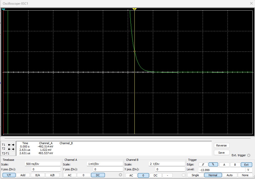

                        The LM7171 Active damping adjusted for no over or under shoot. Decay to marker at 1mV level from 730 V coil volts in 2.631us
                        Scope 1mV per division vertical, 500ns per division horizontal.

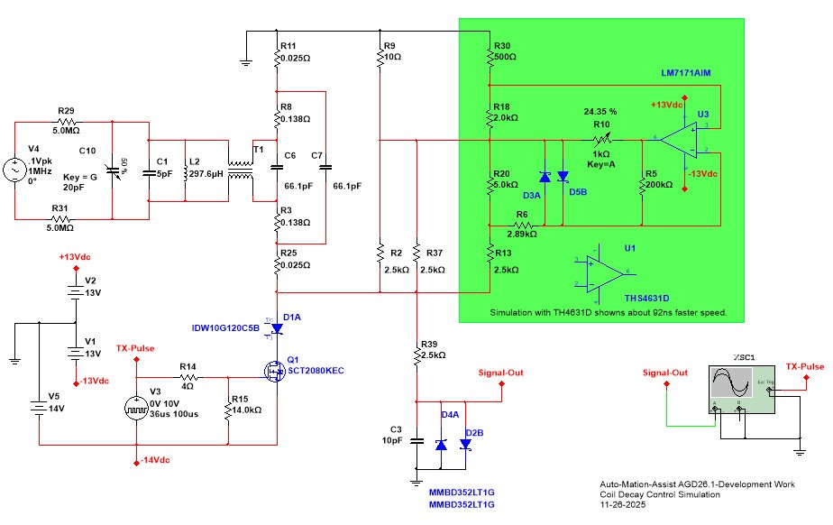

                        Resistor R6 and trimmer are used to adjust damping. R6 fixed resistor value sets rough operating point, the trimmer R10 set damping, shown at 24.35% of 1000, so 243.5 ohms.
                        The active damping is in the green section. R9, R2, R37, R39 and the two clamping diodes D4A, D2B provide normal but not complete damping. C3 sims PCB trace capacitance.
                        C10 across coil at 50% normal, stepped 1pf or 2pf plus or minus to check decay detect none-ferrous or ferrous for decay comparator tests. Circuitry not shown.
                        1 Mhz test inject signal and C10 shown near top left.

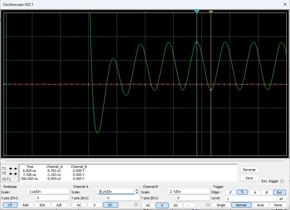

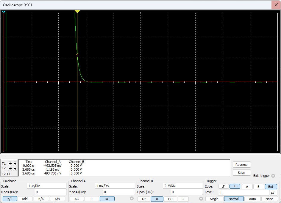

                        • I had a few more pictures that show the where the "positive" 1mV point was with the LM7171 and the 1Mhz test inject signal recovery.
                          Scope vertical 1mV per division, Horizontal 1us per division.
                          Now that I have good controlled damping we can convert the decay idle horizontal us counts at 2.685us and add or subtract the shift in position
                          of the marker, left or right with decay comparator. This will to help determine none-ferrous, Left movement of the yellow marker or ferrous,
                          right movement of the marker via conversion to in nano seconds difference from the end of the TX pulse.
                          Click image for larger version  Name:	7171-5mV-NotUnderDamped-1.jpg Views:	0 Size:	114.6 KB ID:	442969
                          In reference to the above picture:
                          Based on the position of the marker in relation the the curve in the decay show that we are in a good position for measuring very small amplitude
                          variations that may be caused my metallic objects as the coil is being swept back and forth if we were in the field. This would show up near the
                          bottom of the curve like the under or over damping peaks would but be very small and likely only visible on most test equipment after the signal
                          passes through the first gain stage. The use of test injects signal can help work around this and use that to verify proper RX gate timing.​
                          The picture below shows the recovery of the 1Mhz test inject signal for the above picture.
                          Vertical scale is 5uv per division, and horizontal scale at 1us per division. Displayed signal level at markers is 9.954uV P/P.
                          Click image for larger version  Name:	7171-5mV-NotUnderDamped-Signal.jpg Views:	0 Size:	131.7 KB ID:	442970
