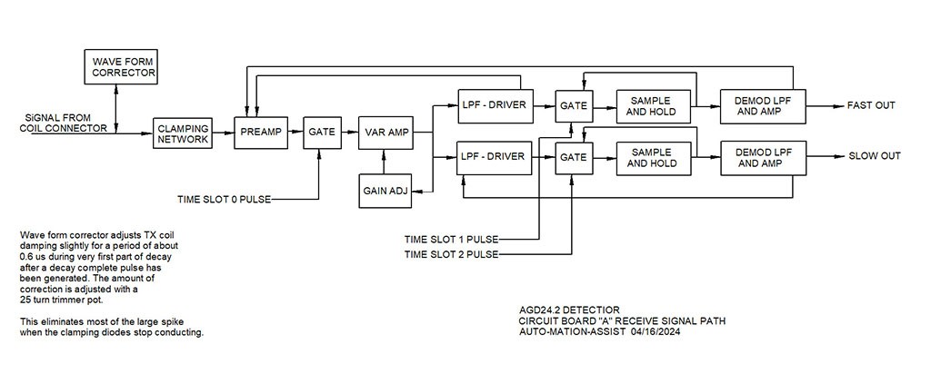

      • Waiting for parts to arrive and thought about making some block diagrams to show signal routing. The first one is for the receive section of the AGD24.2.A board and it is posted here.

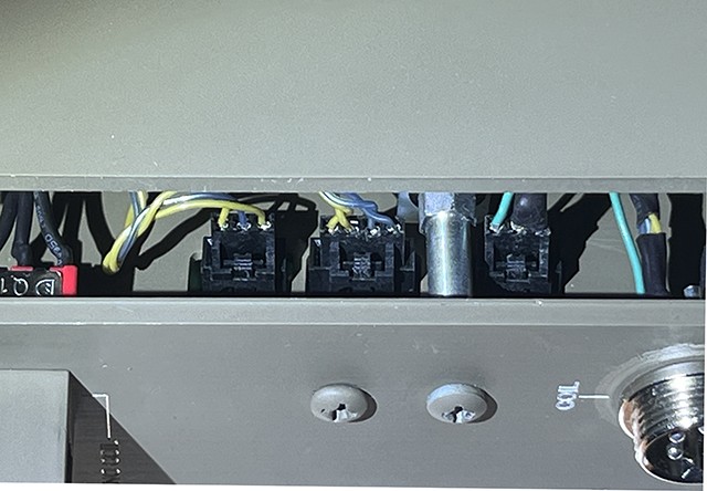

          Click image for larger version  Name:	9-AGD.24.2-RearPanelConnectors.jpg Views:	0 Size:	68.7 KB ID:	424002
          The picture below shows the rear panel connectors plugged in. I start with the RX connector on the right and then do the TX and coil selector switch. Its a tight fit but has enough space and not overly difficult. The ferrite size core causes most all the difficulty.
          Click image for larger version  Name:	10-AGD.24.2-MoveSpeaker.jpg Views:	0 Size:	51.1 KB ID:	424003
