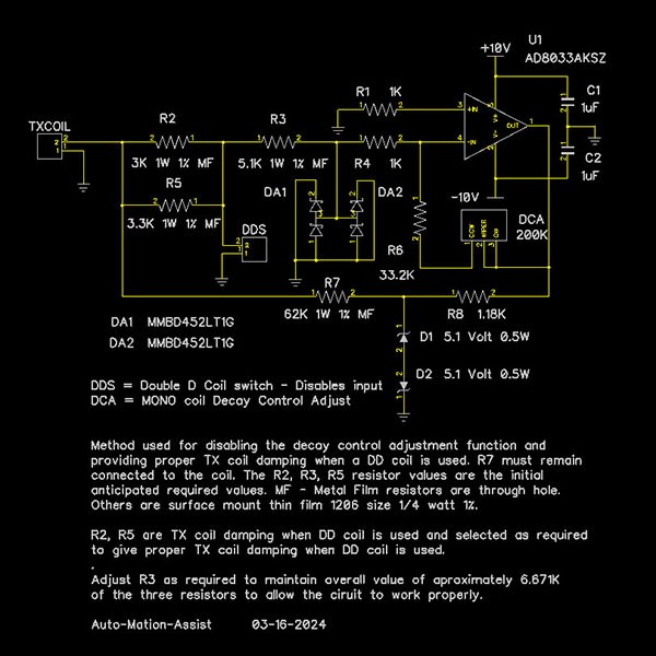

  • Yesterday I was looking at the values on the TX coils damping resistors that need to stay at a constant value. One of these is the resistor value used to provide proper damping when a DD coil is selected and the RX section is completely removed from its connection to the TX coil including all its components that protect it from the high voltage TX coils decay. Since these parts are no longer connected it is desirable to disable the decay control parts that help control the problem created by the RX clamping diodes as I described in prior posts.
    The best way to disable the fine decay control circuit is to not let the coils decay voltage reach the fine decay control circuits input by shorting it to ground. Now we can break the connection that goes to the TX coil and insert whatever value resistor is required to properly damp the TX coil with the RX section disconnected. This works fine and if we now remove the short to ground and select the Mono coil we find that the decay correction circuit is no longer working properly. This is due to two reasons. The control circuits input resistance is now to high and also we have increased the level of positive feedback in the circuit caused by the junction of the added resistor to make the DD coil happy.
    There are two things to do to fix this.
    First the resistor that is causing positive feedback (R7 62K) needs to connect back to the TX coil and always remain connected there.
    Second the total value of the added resistor/resistors (R2 and R5) and the original 6.8K resistor (R3) combined need to be close to 6.8K and not 8.371K. Thus R3 needs to be about 5.1K instead of the original 6.8K. In the picture below R2 and R5, the DD coils TX damping resistor addition are about 1.571K total.
    Here is the picture that shows what I have planned for making the damping resistors proper for each type of coils with readily available standard value metal film resistors.
    Click image for larger version  Name:	DecayControlSwitchingMono-DD-Coils.jpg Views:	0 Size:	80.3 KB ID:	421717
    It may not always be possible to come up with a value that is within several ohms from actual test values. If that is the case it is all ways possible to solder a parallel resistor across another on the bottom of the circuit board since these are all through hole resistors. Generally I allow for five parallel resistors for main damping, four for the RX pre-amp and two for the DD coil damping on the AGD24.1 version circuit board. The internet has many parallel resistance calculators to aid in determining what possible combination of resistor values can give the desired values.

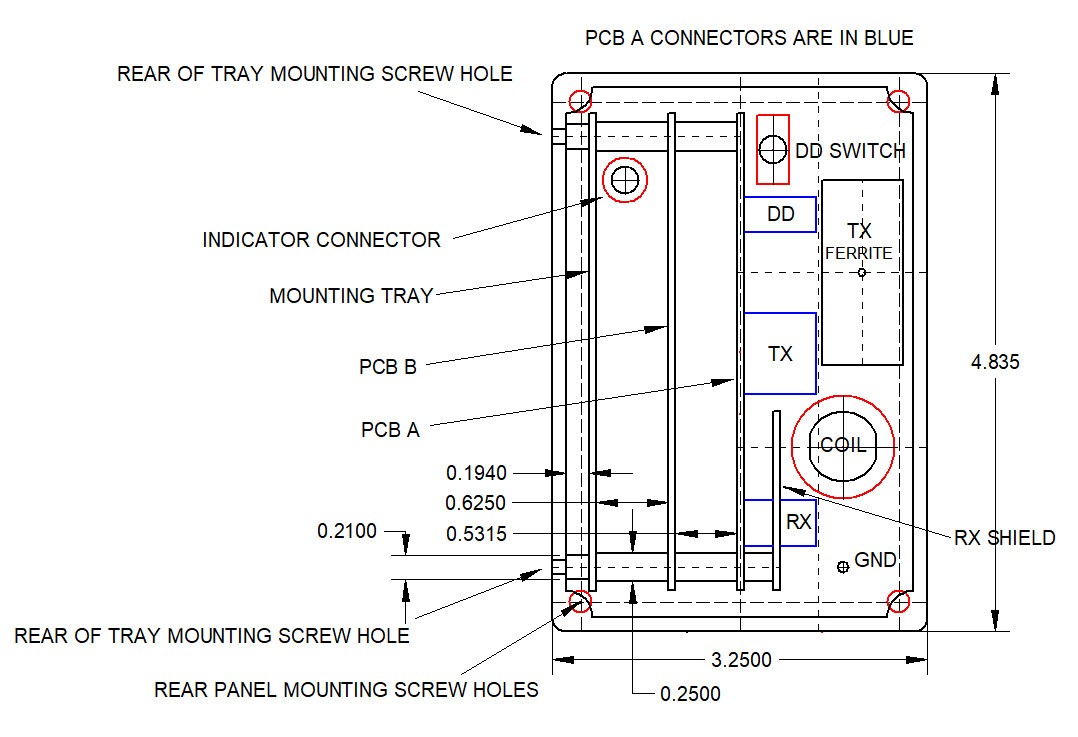

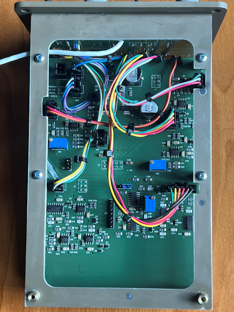

    • The AGD24.1.B circuit board has not arrived yet. To get ready for these I checked the length or the wires coming from the front control panel and found that the ones for the volume control, Timing and power input was going to be to short and I decided to replace those instead of splicing them. This allowed me to get a picture of the populated front panel circuit board. There usually is not a need to discuss the front control panel but I thought that a picture may help in case someone is considering building one. It does show how the various wires connect. The coax routes to the variable gain amp in the receive front end. The board color looks weird from the light source.
      You can also see the metal case and the rail I made to attach it to the wand. It can use the standard GPX arrangement.
      The back for the circuit board looks like this:
      The little jumper wire on the bottom left was a change on how the standby feature worked. It used to disable pulsing but that effects component temperatures and was found not to be useful. It was instead changed to just mute the audio output. The power switch works fine for disabling pulsing.
      Since updating to AGD24 version is a large change in circuit board layout makes it necessary to make a new rear panel. The old panel can still fit but the connector layout is not the best for use with the new circuit boards which take up considerable more space. The main reason for the updated boards it to make it a lot simpler to and some kind of digital controller if desired. There is plenty of space available on the secondary B board to do that.
      In order to determine what the best locations are for the connectors on the rear panel I made this drawing to show were the two circuit boards and the main "A" board connectors are located.​ This would be like looking into the back of di-cast enclosure.
      In the original there was room for a 4 inch speaker in the enclosure. A built in speaker is convenient and I have some new speakers on order that are not as deep as the originals and hope to be able to use them. It is possible to mount them from the outside instead of the inside.
      • The lower AGD24.1.B circuit board arrived a few days back and I was able to get all of its parts installed and checked out. It is working properly but I did have an issue with some connector locations mainly because I designed the board before working on the support tray requirements. This will be corrected on the next blank board order. The picture below shows the circuit board installed with its connections to the front panel in place.
        This board has the CMOS logic, VCO, Demod Signal handler, Audio amp and an indicator driver which comes in handy. The VCO is on the bottom left and the CMOS logic is on the Bottom right. The demoded signal handler for the signals from the main circuit board is on the top left. The auto amp and indicator driver is on the top right. The audio amp is on the top center. The board is 4.1 inches wide and 5.9 inches high. I mostly designed this board to make it possible to add some digital processing, likely just for the VCO, CMOS logic and add a scope like display along with wireless audio interface. For now it will basically be an all analog machine which has proven to work very well for me.
        The DEMOD signal handler/VCO driver on the board above gives a 25 Hz increase in VCO frequency for a input voltage of +10mv and 2.5 Hz frequency shift for a input level of +1mV. A 2.5 Hz frequency shift is easy to hear while sweeping the detector at a rate of 1/2 to 1 second across a very small target. The VCO idle frequency that I use is 400Hz which is suitable for most small loudspeakers. The VCO outputs a sine wave.
        The boards current requirements are, 20ma from the -12V source (usually about -13.5 volts), 47ma from the +10 volt source and 39ma from the -10v source.​
        I expect the main circuit boards, the AGD24.1.A boards arrive some time next week. It will mount on the back side of the board shown above and interface with it using PC/104 type connectors. Two 6 pin and one 10 pin which allowed for a good board layout on both circuit boards.

                      • I think that this was one of the pictures that ended up missing.
                        Click image for larger version  Name:	AGD24.1.B-ProtoPCB.png Views:	0 Size:	549.8 KB ID:	422087
                        And this one about how things will fit in its enclosure viewed from the rear panel end.
