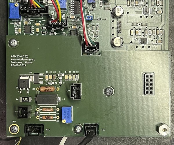

                  I should also mention that having the RX and TX functions operate on separate circuit boards has not presented any problems.

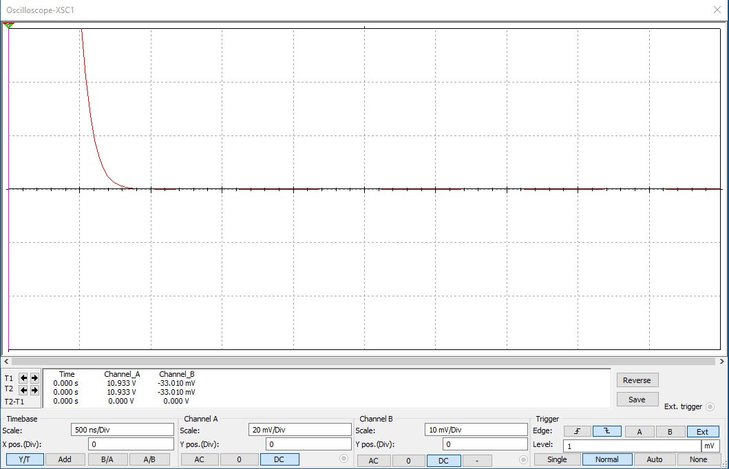

                          This post will concentrate on the now named "TX-Coil-Decay-Control-Circuit" because it it a very important addition and usable in many PI detectors with only minor changes in the detectors a long as they have the required power sources to power the circuit itself. The issue that this circuit is designed to solve is that when the TX coils decay voltage decays to a point lower than the voltage for the RX clamping diodes to conduct the load presented to the coil becomes basically a open circuit. This causes a large voltage spike during the first 0.5us of the signal being routed to the receive preamp as shown below and for the most part should be considered to be a very large error.
                          The picture indicates that this spike is 32.955mV and when amplified by the detectors RX signal gain amplifiers it can become amplified enough to cause signal clipping following gain stages. Again the reason for this spike is that there is no longer a damping or as we call it in the RF field a lack of termination of proper impedance. Trying to provide a termination with a simple resistor to solve this is not very practical because it will need a very large decrease in damping resistance to settle down this spike which will cause decay time to increase by many microseconds. Fortunately this problem can be fixed without increasing decay time, but by decreasing decal time and also at the same time increasing recovered signal level by up to 30% as compared to just damping the coil more with a simple resistor.
                          Here is a picture that shows that the problem spike is no longer there and that a much better damping control is being used. At the 32.955mv it is more difficult to see the actual crossover times to a near zero volt condition. For that I will use a 2uv level later on.
                          Click image for larger version  Name:	Fixed.jpg Views:	0 Size:	110.4 KB ID:	421653
                          Lets look at the 2uv samples now
                          For the the fix using a simple resistor below you can see that the curve decays to zero with no spike being produced, but the decay time is extremely long at 8us and not very use full.
                          Click image for larger version  Name:	DecayWithOnlyResistiveLoad.jpg Views:	0 Size:	54.2 KB ID:	421655
                          Now lets look at the same 2uv one for the fix which has an active part to automatically adjust the damping load on the TX coil very slightly during the last part of decay and see how it compares to the above. You can see that there is a gain of about 3us less time required to decay for the fix that used active loading to control the final part of the decay curve. The other nice thing is that now you have a fully adjustable damping load by just using a trim pot. The only the original damping resistor values need to be modified to allow the fix ti be installed ince it will replace parts of the normal damping resistor load. Which is what I'm working on now for the 24.1 version of the AGD. This fix is working well in the AGD23.4 version with its updated TX board which has this fix circuitry installed.
                          Click image for larger version  Name:	With-Decay-Control.jpg Views:	0 Size:	52.6 KB ID:	421656
                          Here is a picture and some info on this fix. I hope you try implementing this. It is bound to improve your detector if it has RX clamping methods simulator to AGD detector, and if not it can likely be adapted to work as designed in most detectors. The proper choice of active device is important.
                          Click image for larger version  Name:	PI-TX-Coil-Decay-Control-Circuit.jpg Views:	0 Size:	129.6 KB ID:	421657

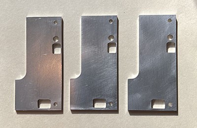

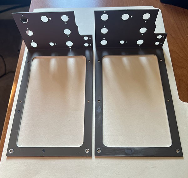

                            • I got word that the lower circuit board for AGD24.1.B has been manufactured and is on the way to me. I hope to have the board populated and tested in the next seven days.
                              I was able the get the shields that will cover the critical parts of the receiver circuitry covered cut out. These will help a lot to keep RFI out of the front end while working on the work bench when the detector is not in its case, but will also keep wires away from this critical area once the end covers are closed. There is no way of knowing were internal wires from the rear panel end up once closed.
                              Internal shields for the TX-RX boards. The lower cutout is the connector for the RX coil. The upper one to the left is for the variable gain amp control. and the hole right on top of that is for access to the pre-amp output test point. One per detector.
                              Click image for larger version  Name:	AGD24.1-InternalShields.jpg Views:	0 Size:	27.4 KB ID:	421666
                              • Well, well. Look at that, a PROPERLY designed detector. Rx in screened box on a properly laid out board of its own. No surprise that this machine will be super sensitive and VERY quiet in its final version.
