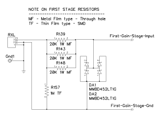

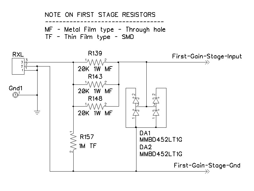

    Here is a schematic of my receive board input.
    Click image for larger version  Name:	Clamping.png Views:	0 Size:	12.2 KB ID:	420211

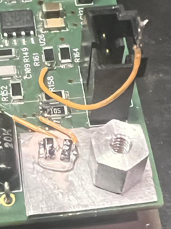

    I have measured the diodes that I use to clamp the input signal from 74 to 140 degrees Fahrenheit and find that the voltage drop across a single diode changes 44.2mV over that temperature range with only 1.28mA of current applied. The current that they actually need to handle is about 90 times that amount but varies with peak coil decay voltage which can cause significant warming of the diodes over time. Nearby parts that also warm up should not be placed to close to the clamping diodes.
    The actual voltage across my test diode which was mounted on separate circuit board was 0.3984 V at 74 degrees F and 0.3542 V at 140 degrees F with only 1.28mA flowing through the diode. This temperature related voltage shift will end effectively changing the point at which the receive waveform is sampled.
    Any PI detector that uses clamping diodes will suffer to some degree but my test have indicated that the diodes may contribute more that 85 percent of all temperature related drift and that it becomes more of a problem when a detector has timing parameters set to detect very small flakes of gold. In such a case parameters set on the workbench for a detector may not anywhere near correct for locations where temperatures are significantly higher. Transmit pulse length has control of the heating process and a detector using multiple pulses instead of one may cause more heating of clamping diodes.
    The best way to at least help alleviate this is to have a temperature sensor in the detector and have its output adjust the timing parameters to compensate for this drift automatically, and the second best and always desired is to keep the clamping diodes from warming up to much to start with by choosing the best possible suitable location for these components. I did my testing using the location shown in the picture below below with heat sink compound for my actual in detector test.

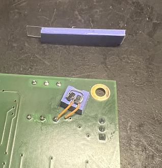

    My initial test clamping diode heat sink - The loose wire goes to the flatten circuit which I removed for the picture.
    Click image for larger version  Name:	DiodeHeatsink.png Views:	0 Size:	718.5 KB ID:	420212
    The AGD detector currently uses 2ea MMBD452LT1G dual diodes in parallel for the diode clamp and I used a type K thermocouple to make my all my temperature measurements. The range I was most interested in right now was for 74 to 85 degrees F which has a 7.5mV change 0.3984V cold and 0.3909V warm. Keeping the diodes cooler shows a very significant improvement in overall temperature related drift and this can be seen clearly by looking at signal at the output of the analog gate feeding the fast sample and hold circuit. Particularly at the leading and trailing edges of the signal was temperature increases after turn on.

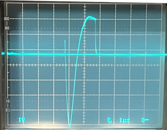

    This is a typical wave form picture when the diodes are cool. When the temperature of the diodes increase the spike at the top left side will drop down below the horizontal line by about the same amount as they are above the top with the heat sink. Without the heat sink the spike will drop down to about 1 horizontal line up from the bottom and also lower the overall signal level. That shows that we are sliding down the decay curve by perhaps 0.2us or so. That is a lot for the small temperature change during bench tests. The part of the wave going up towards the right is the action of the automatic offset control in the detector and ends straight down and then the second slower channel starts to sample.
    Click image for larger version  Name:	Cold.png Views:	0 Size:	417.0 KB ID:	420213

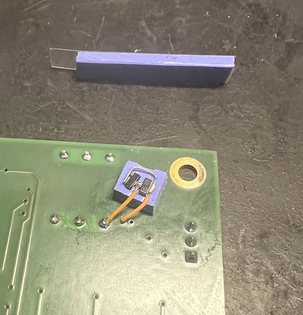

    I plan to keep the clamping diodes temperature as stable as possible by putting them in a U shape clamp with some 1mm thermal silicon pad material surrounding them on top and bottom. This will then press into the slot in the clamp and have a nice tight fit, and still be removable if required. The standoff in the picture will likely become part of the clamp. I will also plan to do some testing by adding a temperature sensor onto the clamp and then into the timing circuit itself. That would allow for a greater temperature compensation range.
    My current test procedure is with my swinging small flake of gold attached to a golf ball shown in prior pictures at a 1 inch distance which still gives a very strong audible signal, and use machinist gauge blocks for ease of setting my distances.

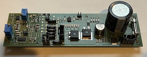

        The updated TX circuit boards arrived for the detectors that I built last year. These boards added the modification that I posted before which controls the coils damping resistive load during the time when the decay waveform gets low enough to make the clamping diodes stop conducting. Since these boards need to go into existing detectors there was no good way to increase the board dimensions to make all newly added components fit on top of the board and thus the larger metal film resistors that that circuit uses were placed on the bottom of the board.
        Click image for larger version  Name:	AGD23.4.B TX Board.jpg Views:	0 Size:	46.5 KB ID:	420437
        And the bottom
        Click image for larger version  Name:	AGD23.4.B TX Board Back.jpg Views:	0 Size:	27.0 KB ID:	420438
        With the added function the sampled waveform can now be corrected for the loss of partial coil loading when the clamping diodes become a gradual open circuit. In order to be able to display this and make the adjustment I added several test points to the sample and hold circuits on the RX board. This allows for looking at the receive signal only during the correct sample time. To get the proper wave form at the correct time both the point at which sampling starts has to be set and also the delay for the sample and hold gate has to be set correctly. This may be about 0.205us and is set by adjustment on the RX board. This compensates for signal delay caused additional signal routing before the signal reaches the sample and hold circuit. Adjustments values depend to TX pulse width and voltage levels driving the TX coil along with coil damping load. These control peak coil decay voltage and the length of time it takes to decay. The decay complete signal is master and other adjustments are made after this best time to trigger is set and is before well before the decay reaches its zero volts point. For me it is typically 2.805us after the TX pulse ends which activates the first RX gate 0.445us later or at the 3.25us point.
        To make the two adjustments, for 'decay complete' and 'waveform correction' the TX board has two adjustment trimmers. The first is a time delay based control and the second is a voltage based control.
        Back in a prior post I made note that clamping diodes are a bit temperature sensitive and It helps to keep them as cool as possible. I looking at my old detectors more carefully I decided that it was best to move them to under the board and clamp them between the board and its mounting tray with 3mm silicon pad material top and bottom. See picture below which show part of the receive board bottom.
        Click image for larger version  Name:	ClampingDiodes.jpg Views:	0 Size:	92.7 KB ID:	420439

                About five days ago I ran some tests while heating up the clamping diodes that are show in a prior post and the chart I made based on my measurements.
                This test was with the clamping diodes on top of the RX board and with clamps to the standoff with .025 thick alum top and bottom of the diodes and with the diodes surrounded with 1mm thick silicon pad material.
                The diodes were heated to the temperature indicated or cooled. The heating effect is normally caused by the large peak currents from reducing the TX coil recoil voltage down to around 1.3 volts.
                Recoil peak voltage can reach 650 volts in my design and will reach that level if TX pulse is increased to more than 45us.
                Current flowing to these small diodes will cause them to warm up and when diodes warm up all their operating parameters become degraded. Thus when dealing with diodes in critical areas it pays to keep them as cool as reasonably possible by choosing the best possible locations for them and using small heat sink if desired.
                Nano seconds with + occur later than the reference time of 25 degrees C.
                Nano seconds with - occur before the reference time.
                DTD = Decay Time Delay trimmer on the TX board and R25 is the resistor in parallel with it.

                Total timing change from 10 to 55 degree C was 210.484ns with the small heat sink.
                Total resistive change required to correct timing over same range was 315 ohms.
                Normally the temperature of the clamping diodes reach 30.8 degree C or 87.3 degree F while on the work bench. This is about 15 degrees F higher than ambient temperature.
                I think it is not practical to correct for the 60 degree level with analog means. The change from 55 to 60 degrees C is to large.
                Without a heat sink or a poor location of the clamping diodes will cause the temperature related drift to be significantly higher.

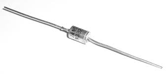

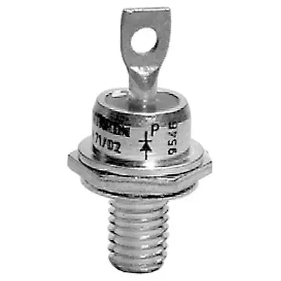

                  putting it a insulated enclosure will make things a lot worse. = maybe not, it is the chance that temperature will stabilize after 1 or 2 minutes, at least you will isolate them from outside temperature changing
                  use stronger diodes or metal case diode.

                      2. Moved both clamping diodes below the RX circuit board to better control their temperature increase from the high current pulses of the TX coil kick back voltage.

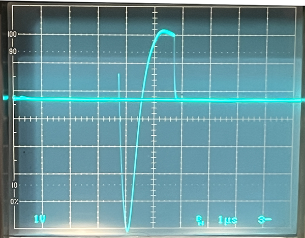

                          The picture above is the receive waveform at the input of my fast sample and hold channel and is not what I expect to see there. There should not be a large negative going spike there.

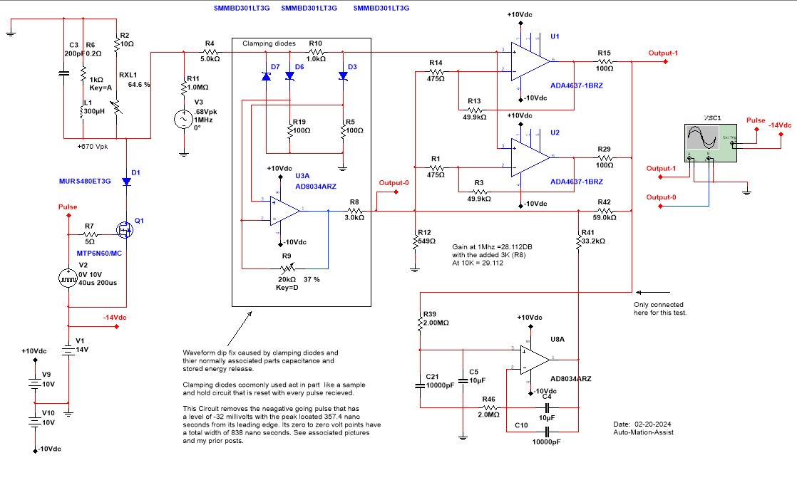

                          I will show why this is happening, the cause, and my fix that may help other persons working or building their own detectors.
                          I have made a number of post relating to flattening the downward side of the TX coils decay slope to help with obtaining the most possible receive signal handling headroom. My prior work on this has been tested and can be made to work but it cannot fix the problem with the waveform pictured above. The reason for that is that this problem is not created by the coils decay waveform and is instead created by the clamping diode capacitance, stored energy, op amp input capacitance and also a small amount of circuit board capacitance. This problem shows up as the large negative going spike in the picture. My own simulations has show that this negative going spike has a level of -32mV out of my first gain stage and turns out to be actual reason I developed a way to flatten it. The spike is there is not preventing me from detecting small gold but it is something that should be fixed as a improvement to the existing circuit design.
                          If you study the partial diagram of part of the front end of the AGD detector you will find that if you just consider everything wired to the output of the three 20W 1W metal film resistors 'to be capacitors' then what we have is actually have a sample and hold circuit that gets set and reset by each signal pulse received from the TX coil decay signal. With each received pulse the parts are charged up until limiting starts and then they decay by whatever the circuits time constant turn out to be. This is not a good thing to have going on at the most sensitive part of a detector.
                          It is something we have to live with and work around the best we can. This negative spike is generated and amplified by the parallel op-amps to -32mV and it likely ends up being 3.2 volts or more later on, and is a lot for something that is mostly fixable. The spike as a time constant of 357.4 nano seconds from its leading edge to its peak and has a total period of 838 nano seconds between its zero volts points. Since this is fairly fast some of the pulse is filtered out a bit before entering the actual sample a hold circuit by its preceding low pass filter.
                          To fix this problem the arrangement of the clamping diodes need to be changed from a normal configuration to one in which currents going through the clamping diodes and be measured and also a time difference has to be established so that measurement differences relating to time can be made. This is what I will do using all analog methods to suit the analog detector.
                          Lets look at some before and after pictures first that also have a 1Mhz sine wave added just to verify that there is no loss of the actual desired signal.
                          The test waveform with the problem.
                          Click image for larger version  Name:	Before-With-1Mhz-Sig.jpg Views:	0 Size:	175.0 KB ID:	420662
                          The wave form after I applied my fix to decrease the negative going spike to a minimum. There is just a very slight rise of the 1Mhz injected sine wave in the first two cycles. This is a great improvement over the waveform shown above.
                          Click image for larger version  Name:	After-With-1Mhz-Sig.jpg Views:	0 Size:	173.3 KB ID:	420663
                          My circuit diagram for my clamping diode and associated parts negative going spike fix that is caused diode capacitance, stored energy, op amp capacitance and a very small amount of capacitance in the PCB layout.. The changed parts are in the the rectangular box. It uses three diodes as shown in the diagram, two of which generate the source for the correcting signal.
                          Click image for larger version  Name:	My-Clamping-Diode-Fix.jpg Views:	0 Size:	128.0 KB ID:	420664
                          By using this method I see no need to use the flatten circuit that developed and I tested before since I think that this addresses the source of the problem I was attempting to cure and had not yet properly identified. The waveform correction addition that address loosing part of the TX coils damping resistive load after the clamping diodes stop conducting is working well. The clamping diodes in the above circuit also provide desired signal isolation so that the actual desired receive signal remains unchanged when the circuit is used as can be seen by looking at the 1Mz since wave that was injected into the simulated TX coil as shown in the diagram above.​
