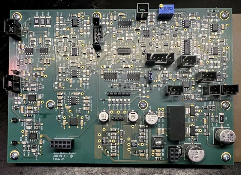

          I was able to update 6 of the AGD23-3 diagram pages and anticipate making some minor changes to the timing drawing to add some level shifter parts to outputs TS-3 and TS-4 even though they are not used. The supplied diagrams are for the AGD23-3 version for which the required receive board has already been laid out. Boards will likely be ordered before the end of this month. The parts that I have been waiting for are now expected to be shipped to me on about Mar 14th instead of in May.
          I have attached a picture of a board built about a year ago (22-1) and the 23-3 version will be very similar with on relocations of mounting holes. Some parts get moved slightly.

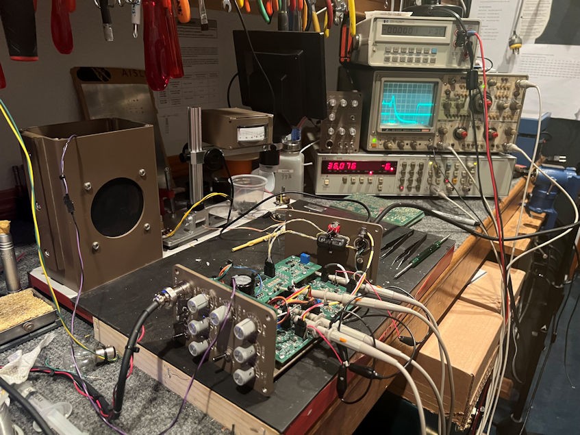

              I was using a older version of the AGD23 to do some verification work before populating one of the newer PCB's that I received a few days ago.
              Click image for larger version  Name:	VerifyWork.jpg Views:	0 Size:	177.9 KB ID:	410493
              It gets to be pretty messy at times.

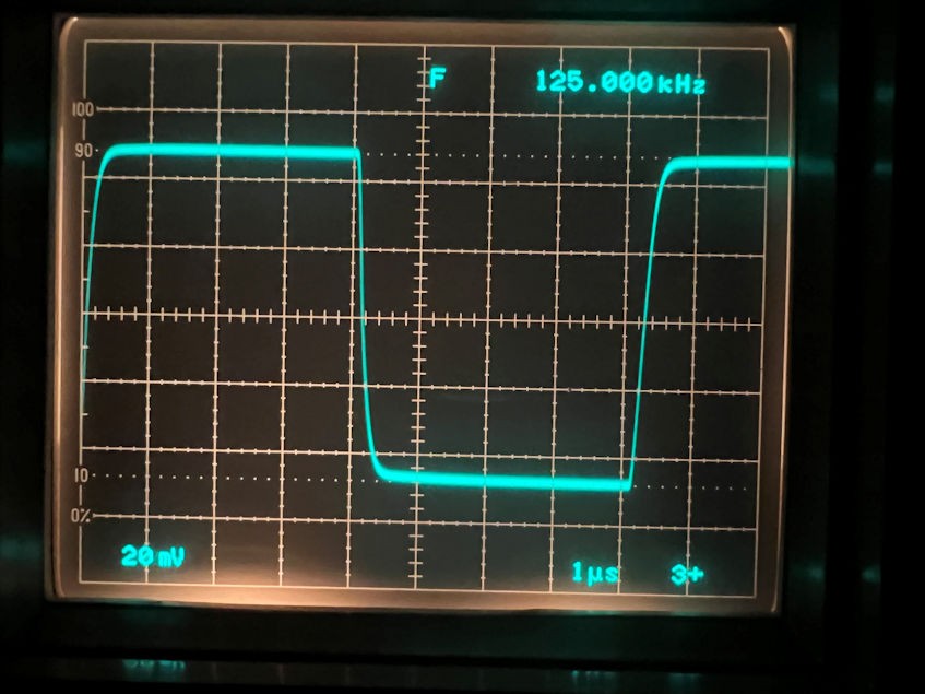

                  The front end design goal has been to utilize only linear parts to keep intermodulation (IMD) generation to a minimum and to allow fast recovery from overload due to transmit pulsing and its bad side effects. As a result you will not find and switches before the first amplification stage since those can act like a none linear device while switching and increase susceptibility to interference. The closets to this is the diode in series with Mosfet driver and it gets reversed biased almost immediately upon completion of the TX pulse by the coils kick back. Intermodulation distortion occurs when two or more signals are received by a system that has components that have a non-linear area when switching on and off just like a mixer in a radio receiver. Some times using a simpler design has benefits over a more complex one.
                  The drawing of the AGD23 front end that I posted in .pdf format is actually page two of the design. Page 3 (Signal filtering and sample and hold), and page 4 (Signal filtering and amplification) are still being redrawn to add component values
                  The 125kHz square wave test picture that I posted is a usual test done in audio design work to verify that there is no or little overshoot in the waveform and indicates its usability to ten times the test frequency or 1.25Mhz. Careful PCB layout is important here. Back in my prior years I built a lot equipment and had over 110 pieces of personal test equipment and this test was used a lot when gain flatness was very important.

                            I use my HP3325A function generator and have it output a 2Hz square wave signal at 1mV and run that into a 1000:1 of attenuation to get down to about 1 micro-volt level. With the VCO idle frequency adjusted to 400Hz it should cause the VCO frequency to shift the frequency about 10Hz upwards if everything in is correct in its important TS-0 (Time Slot 0) amplification chain and its servo loop. The servo loop allows for DC coupling all the way from the front end to the VCO input if desired. On the board itself there is a 10uf capacitor into which would need to be replaced with a zero ohm resistor (1206 size). I usually order circuit boards by the dozen so if anyone is interested in building this keep that mind.
