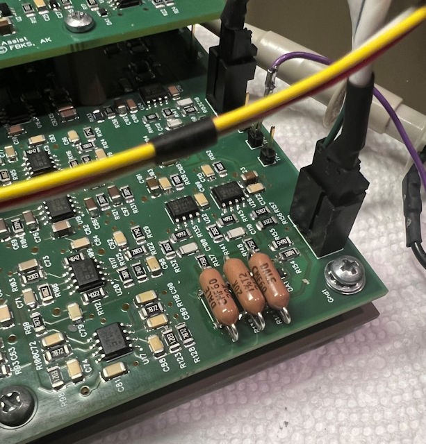

            In reference to the fast response time:
            I think that I adjusted the sample and hold timing to be fairly fast but not to unreasonable and to the point that it is to fast for the ear to respond to. It is not difficult to make it slower and only requires changing the time constant of the two sample and hold circuits. The best way to do that is the increase the value of the four 1.5K resistors to a personalized value.
              While upgrading to my already built detectors to the version AGD23.2.A receive boards I decided to do just one since the cost of populating a board is fairly high and use the version 2 board to verify performance for my proposed updates for version 3. As a result I have completed updates for AGD23.3.A (Receive Board) and AGD23.3.B (Transmit Board).
              I have ordered the version 3 boards and they should be here shortly after April 4, 2023. There are no basic circuit changes in this update. I eliminated on test point, added a test point on the first timer output to trigger a scope on and added a mounting screw hole. The added screw hole along with one existing screw hole allows for adding a metal shield over the first stage if desired. Also added a test point to aid adjusting coil damping resistor value on the TX board voltage divider output at 10 ohm resistor junction point.
              The primary changes have to do with minimizing noise generated by resistors in sensitive areas that presently use thick film surface mount resistors which can be quite noisy. These will be replaced by lower noise types which of course are more expensive. The result of lowering this noise will make a difference in that it will detecting small objects will become more distinct because signals are not being modulated as much by resistor generated random noise as much. Parallel resistors are are also used to reduce noise since parallel devices reduce noise due to partial cancellation of random generated level and phase differences.
              All resistors for the coil damping and voltage divider on the TX board are changed to through hole metal film types. I have chosen to use Holco resistors, H4P10RFCA, H4P2K7FCA, H4P7K5FZA and for the DD added load H4P1K8FCA, not my prefered value of 1K87 which is not available right now. Holco resistors are by TE Connectivity / Holsworthy.
              On the receive board the three parallel resistors on the input to the first stage are also changed to through hole metal film types. I have chosen to use Holco resistors, H4P20KFCA or an alternate CMF6020K000FHEK from Vishay / Dale.
              Also on the receive board all resistors of the first stage change from surface mount thick film types to the less noisier thin film types. I plan to use these resistors once the version 3 boards arrive and are available from Digikey, ERA-8AEB101V, ERA-8APB4750V, ERA-8APB5490V, ERA-8APB2552V, ERA-8APB3322V, ERA-8APB4992V, ERA-8APB5902V and ERA-8AEB105V which is used to provide a path to ground if the input plug is pulled from the board.
              The only resistor change I made so far with my tests have been with the three parallel resistors on the input to the first stage others have not arrived yet.
              I have been testing with 0.75 spacing on my golf ball swing with the 0.015 gram of gold with the Coiltek Elite 9 inch coils. I did suspend from the ceiling since testing with the DD 8 inch coil to give a wider swing. The DD coil I tested with before has a very knife edge response, and it would likely be easy to miss a small target in the field if the swing is to fast with the 8 inch DD coil. I have been using a 2us wide window to gate the primary sample and hold during my tests.
              This shows the upcoming change to through hole parts for some resistors. On version AGD23.3 printed circuit boards these will have the correct pads. The picture show the CMF6020K000FHEK from Vishay / Dale parts which are less expensive than the Holco 20K 1 watt resistors and a bit smaller.
              Click image for larger version  Name:	ResTest.jpg Views:	0 Size:	128.2 KB ID:	410878

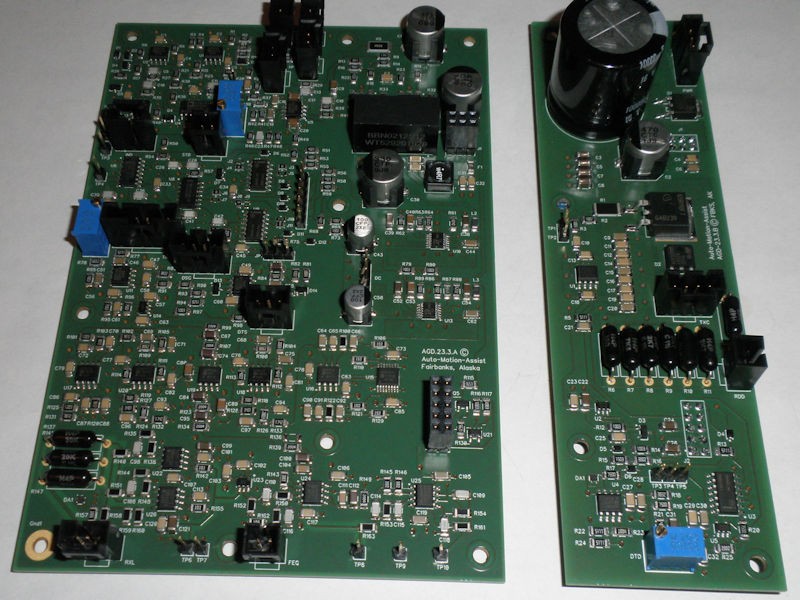

                      I have assembled and tested AGD23.3.A and AGD23.3.B version boards and found them to work properly.
                      Click image for larger version  Name:	AGD23.3-Ciruit-Boards.jpg Views:	0 Size:	144.0 KB ID:	411400
                      I did make a lot of initial;l measurements due to a initial loss of a lot sensitivity. I traced this down to the sensitivity control working in reverse because the connector on the circuit board got reversed in version 3 to make trace routing on the PCB and bit better. I moved the pins for the DTS plug around that connects the the front panel PCB and the problem was solved. I'm always looking for a way to maximize performance and while solving the plug wiring problem let me to improve two areas. The first one is the low pass filter that is found on page three of the diagrams. This filter is a bit slow and thus have a small overshoot on pulse response. My modification for this filter removes R153 and replaced it with a 0 ohm jumper , and also removes C144 on the prior submitted diagrams. It also changes R163 to 1.41K, R161 to 200 ohms, and R154 to 3.77K. This modification moves the -1db gain point up to 1Mhz and decreases pulse response time to about 360ns and almost overshoot on the rising edge. This filter drives the dual channel sample and hold circuitry on the circuit board and the modification makes the receive signal arrive at the sample and hold also about 400ns faster.
