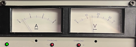

                I have been testing AGD23.4 receive circuit board along with a AGD23.3 TX board. D2 on the TX board was changed to changed to NXPSC10650D6J Silicon Carbide Schottky diode. The silicon carbide type improves decay time slightly. The AGD23.4.A receive board has the delay adjustment for channel 0 time alignment I mentioned before. The blue trimmer pot towards the center of the receive board. It also shows the shield over the first gain stage of the receive board.
                Click image for larger version  Name:	Testing-AGD23.4.A RX with 23.3 TX board .png Views:	0 Size:	453.1 KB ID:	412114
                Total current consumption and supply voltage.
                Click image for larger version  Name:	VoltageAndCurrent.png Views:	0 Size:	90.0 KB ID:	412115

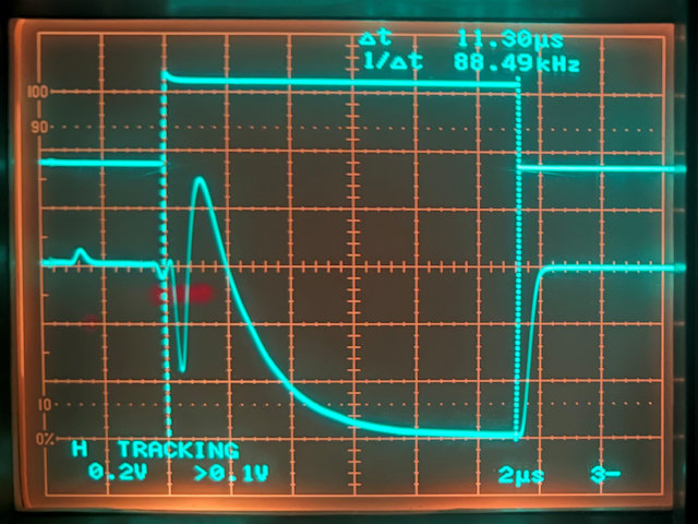

                  I thought that it may be useful to expand a bit in the functions of the logic pulses that open and close the analog gates at the proper times to route the receive signals to the next processing stage.
                  In order for the receive board to do more than supply the TX clock and reset pulses we need to get a signal from the coil decay end circuitry on the transmit board. The decay end detect circuit has a delay adjustment that sets how high we want to climb up the decay curve. If going up to high it will overload the signal gain stages so a point has to be chosen that is reasonable for the decay times of the items to be detected and is chosen as a certain amount for time in fractions of a microsecond from the end of the TX pulse. For the AGD23.4 I have chosen to set this time 3.52us.
                  Here is a picture of the delay pulse and its relationship to the received signal while triggering on the TX pulse and its expanded version.
                  Expanded view
                  On the receive board there are two analog gates that need to be switched on and off at the proper times by the pulses generated in the receive board logic. There are two separate channels in the receive board, these are numbered TS-0 and TS-1 and each has its own pulse width control that can be set via the front panel controls. The pulse width of TS-0 and TS-1 are added together and form time slot TS-2.
                  Time slot TS-2 is used to control what part of the received signal will be processed after the first front end gain stage via the analog gate it turns on and off. The signal leaving this is amplified and filtered before being broken down into separate channels later on via analog gates controlled by the TS-0 and TS-1 pulses.
                  To get the signal flowing let’s look at the time relation ship with the receive signal for TS-2 by looking at the below picture. The picture shows the TS-2 pulse on top and the typical receive waveform of the AGD detector below. The TS-2 pulse width is the total as set for TS-0 and TS-1 time slots.
                  TS-2 picture
                  If we look at the below pictures for the pulses generated for TS-0 and TS-1 we can see how they line up with the receive signal and thus what parts of the signal is routed to each channel via the channels own analog gate. The output of each analog gates drives its own sample and hold circuit and routes the signal to additional stages for further processing.
                  TS-0 Picture
                  TS-1 picture
                  When routing signals through electronic components it does not happen instantaneously. It takes time and each component has its own time specification and thus it is important to minimize the time required to route signals. Components have specific bandwidth limitations and circuit design issues can introduce overshoot which also adds to the time required to route signals. It similar to domino blocks standing on end in a row and each knocking the next one down in precession.
                  This brings us to time alignment of the receive signal at the demodulation stage, which in the AGD detector are the two sample and hold circuits, one for each channel. To have the ability to do a time alignment we have to have a reference point to adjust from. In the AGD detector the decay end signal is used for this purpose. As you may recall it was set to 3.52us at the start of this post and after routing through some additional components it is routed through a adjustable delay whose outputs start the TS-0 pulse. Completion of the TS-0 pulse triggers the TS-1 pulse to start. The TS-0 pulse time position very important for maximum detect sensitivity.
                  If we look at the picture below of the signal at the input of the sample and hold circuits, we can see that the decay end pulse occurs ahead of the signal zero crossing at about 4us and must be moved to that point. The two very small pulses, one positive going and one negative going are suspected of being front end overload recovery due to TX pulsing and appear to minimal and on the outside of our receive window.
                  Decay end expanded
                  Let’s look at the next picture below. It is and expanded version of the above and shows the TS-0 pulse after having its delay adjusted to the correct point. The two vertical dashed lines show the amount of delay adjustment that is required, and the text above for the width between the two lines indicates it being 0.610us. It could be adjusted to a bit less but it is very close to where it should be. The analog switches are very fast but do have a bit of turn on and turn off delay (110ns on and 85ns off).
                  If you were to do some air testing while configured for this test you will see the trace bending at or near the point where the TS-0 pulse should cross. Once this adjustment is made it does not need to be adjusted again. It will follow whatever the setting is for the delay end adjustment on the TX board.
                  Adjust the delay end adjustment on the TX board slowly as an experiment to see how moving up and down the coil decay slope slightly effects the signal wave shape within the TS-0 receive window. But do watch out for front end overload while doing this.
                  This is all I got for now.

                          4. RX3 timer triggered by RX2 timer pulse end and default set to 35us for the channel 2 signal gate.
                          The following signal routing time delays have to be considered for the RX timer start times.
                          A. The signal transit time through the first RX gain stage to the signal gate following it. In the present circuit this time is adjusted by setting the decay end time ahead and setting the the trim pot in the decay end logic so that the desired part of the decay waveform is aligned with the firsts gate closed time.
                          B. The total signal transit time from the output of the first gate to channel 1 and channel 2 signal gates. This is presently adjust via trim pot on the RX board.
                          I can see a process where these delay adjustments can be automatically set by injecting an test pulse into the receive string and making a time difference measurements with one of the analog to digital converters in the G474. This would save on having to make manual adjustments and compensate for parts and bandwidth differences and thus optimize performance.
