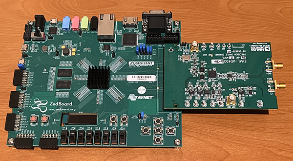

                      I decided to see what it takes to utilize a standalone 24 bit ADC in to the AGD detector and developed a preliminary new front end to satisfy the differential input requirements of the 24 bit ADC that I choose to experiment with. It is the AD4030-24BBCZ that came out several years back and plan to stream its output via SPI interface to a STM32 based MPU. I think that this is workable and I'm working on getting my test set up completed to determine if this would actually be the best way to digitize the voltage levels of the received signal.
                      The AD4030-24 or its dual version AD4630-24 are both 2MSPS devices but the drawback to me is all the power supply voltages that are required to make this work.
                      It does not take much DC offset or noise at the inputs of a 24 bit ADC before accuracy starts to get lost. I my goal is to try to reach 24 bit accuracy by using the built in features of the AD4030-24 2MSPS ADC. I expect that the sampling period will have 40us to do its sampling with 160us between sampling periods. Values written to an array and sorted out into the two or more desired channels in a STM32 MCU
                      My original ADG detector uses two precision low noise +/- 10 Vdc regulators. To make a good interface for the ADC it looks like +/- 6 Vdc, + 5 Vdc, 2 ea at 3.3 Vdc, +2.5 Vdc, -1.6 Vdc and -6 Vdc. Thus power supply complexity is increased but the potential of eliminating most of the analog stages that follow the current sample and hold circuits could be eliminated. The control panel would also need changes since the controls on it are also analog based. So it looks like a complete new design is going to be in the works for the receive board.
                      A simpler option is not to use the 24 bit stand alone ADC and to just digitize the outputs of the two present sample and hold circuits since they are plenty good enough to use as is. Then it becomes much easier to digitize the much slower moving signal and any 12 bit ADC with at least 2 channels could be used. Many STM32 chips would be suitable. But I got 24 bits running around in my head and want to investigate that further.
                      It is also important to define what the goal is to turn the receive signal into something that can actually be used as an alert signal that something resembling metal has been found. In my opinion the alert signal should not be to slow to build up, or linger on past the pin point to long, or be a unintelligible mess of various tones or noises.
                      1: For a alert signal I have found that a simple audio tone is the best for me. Presently a fairly low distortion analog VCO takes care of this in the AGD detector but this would need conversion to a PWM filtered signal if an ADC is used.
                      2: In conjunction with the alert tone the second best being an old style mechanical signal strength meter with adjustable gain. The AGD detector has built in circuitry to drive such a meter movement and can switch between two gain settings. Tying to use LED's for this purpose is useless but simulation of a meter scale in a LCD display may not be if the update rate is fast.
                      For my present development setup for working with the 24 bit ADC I decided to invest in the Analog Devices Eval-AD4030-24 24bit 2MSPS evaluation board and also the ZedBoard which in conjunction with Analog Devices ACE software should allow me to see what is going on inside the AD4030-24 chip along with other functions. The AD403-24 eval board comes with a microSD card and adapter to plug into the ZedBoard and contains ADI Kuiper Linux configured to communicate with the AD4030-24 bit ADC. The ACE software installs on a PC.
                      Recently Micro-Cap spice simulator has become free and QSPICE is a newly developed simulator prototype is also available for download and has many features. I understand it will be released in July but presently available for testing as a proto version. It may well become the new standard for simulation. The designer is a well know for his prior work with spice type simulators. Check it out.
                      This is my development board setup for this 24 bit project. Now waiting for test cables to arrive.

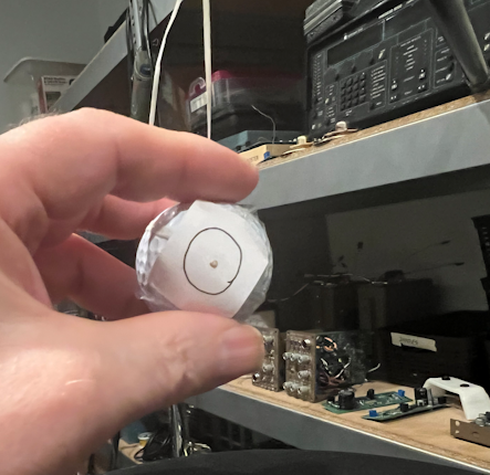

                            I'm still doing all my testing with my 0.015 gram piece of gold swinging on a golf ball and the modification I proposed for the next generation of the AGD has proved to be worthwhile. The sensitivity increase was substantial. Picture my test piece of Alaskan gold is below and it swings about 0.75 inches above my 9 inch Elite Mono coil that I use for most of my testing. I have two of these coils and both give similar results. Removing the gold and swinging the ball has no effect.

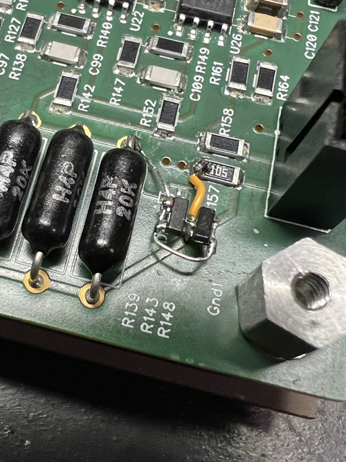

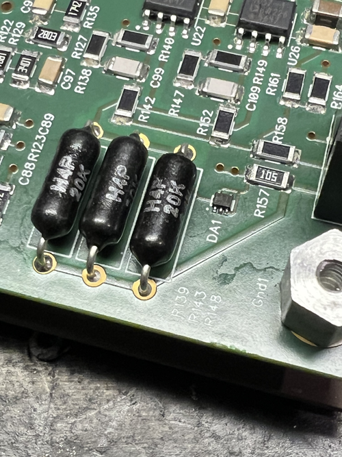

                            The modification on the AGD.23.4.A receive board involve changing the present diode array voltage clamp to two separate MMBD452LT1G diode arrays in parallel. These diodes clamp at a lower voltage. Under normal operating conditions with TX pulse width set to 36us and the coil driver operating from a 14.4 VDC source. The first stage recovers from its inductive kickback overload 0.700 us before the RX gate at its output is enabled as measured at TP4 on the attached diagram. The replacement diode arrays are labeled DA1 and DA2. Below are some pictures on the old diode array and the test new ones. My diagram shows it as I would install it on the next generation PCB.
                            The old DA1 diode array
                            Click image for larger version  Name:	Old-DA1.png Views:	0 Size:	629.6 KB ID:	418990
                            The replacement test diode arrays - Not pretty but good enough for testing
                            Click image for larger version  Name:	New-DA1-DA2.png Views:	0 Size:	608.4 KB ID:	418991
                            New schematic for page 2 of the AGD.23.4.A receive board is attached below. There are three parallel 20K 1 Watt metal film resistors before the diode arrays and have a loss of about 0.03 dB on the receive signal. Very high quality metal film resistors are used for minimum noise contribution. On future generations there will be four resistors in parallel.

                                My micrometer indicates that the approximate diameter is about 0.06 inch with thickness of about 0.01 inch and is a good size for testing with a 9 inch diameter coil at 3/4 of an inch. I look at the amount of deflection on an mechanical meter movement and also need to hear a loud and clear change of pitch in the audio signal. The 3/4 inch is not the detection limits for this particular piece of gold with a 9 inch diameter coil. Alaskan gold is usually very small and my detector is able to find very small hot rocks, super small junk metal and fairly small gold. Mostly in that order. For real small gold panning is by far the best but not real productive. I usually keep a small piece of gold like this in my detectors cover for checking that the detector is working as expected while in the field.
