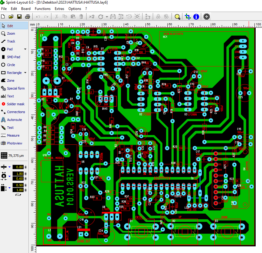

            "...hi, since no one has received a suggestion, I have this analog structure for digital;
            a- I added 1 x 16x2 lcd
            b- I added 3 buttons
            c- I added an hc05 bluetooth module for future use for android or PC (I will activate it when the project progresses)
            d- it is the sound layer that upsets me. for two audio outputs, the atmega328 is a bit old architecture, there are 3 timers inside. I couldn't activate timer0 because timer0 is used for millis() and delay, I couldn't use timer1 because timer1 is used for spi, only timer2 remains, I couldn't use it in the sound stage because I used it for firing the mosfet and timing in TX. i wish i could use a more powerful MCU sure it would be easier. But for members I have to use atmega328...
            a - No problem, piece of cake
            b - 5 is better than 3, if you explain the exact functions of those 3 buttons; I might understsand better the concept.
            c - No problem, piece of cake
            d - Don't worry too much about the architecture of Atmega, just clearly describe the processes you want the code to do.
            Changing a timer will only spoil some of the Cpp functions. Well-written code for a PI detector cannot rely on code written only in Cpp. You don't need many of these functions at all.
            Don't waste time on things that haven't happened yet. Instead, describe it clearly in the form of a descriptive algorithm; all the processes you want to happen in the code.
            Direct port/pin manipulation is 14 times faster than a similar function written in Cpp.
            All necessary timings will be done with the help of a timer(s).
            Outside the main code, independent and having the highest priority.
            Everything else comes later.

                  I hastily drew the schematic and am attaching it here. I also drew the PCB according to the diagram. I am using sprint layout, I am attaching that file as well. If you don't mind, I'll build the PCB next. In the code part, I plan to share the oscilloscope images step by step.
                  The menu is simple with 3 buttons;
                  1. menu button: make ground balance if pressed short, settings menu with long press
                  2. Up button: If not entered in the settings menu, increase the sensitivity, and in the settings menu, increase the relevant setting.
                  3. down button: decrease the sensitivity if it is not in the settings menu, and decrease the relevant setting in the settings menu.​
                    Click image for larger version  Name:	HATTUSA.jpg Views:	0 Size:	287.6 KB ID:	411188
                      Click image for larger version  Name:	HattusaPCB.jpg Views:	0 Size:	107.7 KB ID:	411192
                      These are the proteus and sprint layout files;

                          Did you download the proteus and sprint layout files?
                            Yes!
                            But I didn't opened them yet.
                            In a few minutes I will.
                              Dang!
                              Click image for larger version  Name:	image.png Views:	0 Size:	11.3 KB ID:	411200
                              Is it possible You to save it in earlier version?
                              I am not sure Proteus can do that... must check.
                                This one is alright!
