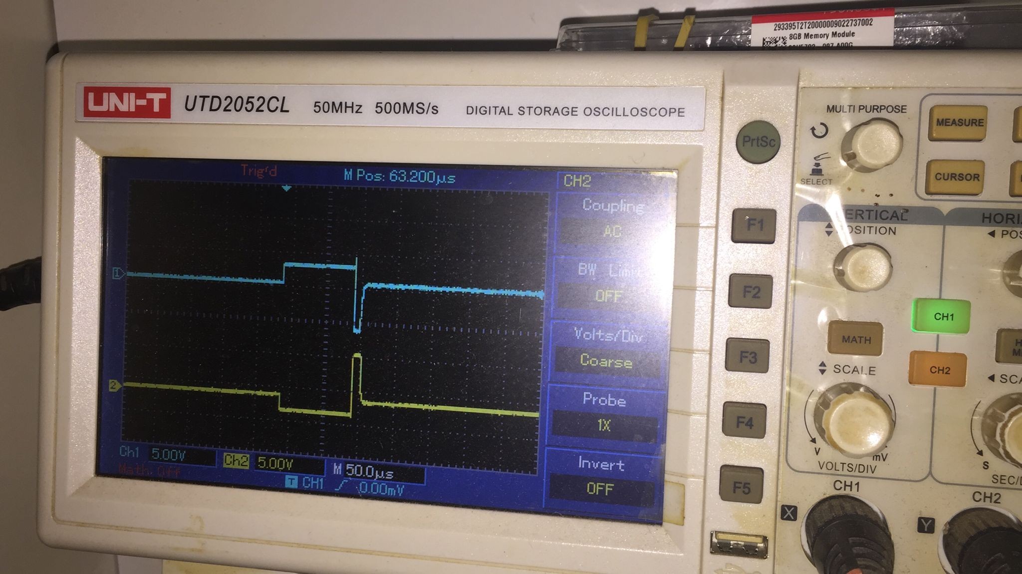

                    • #55
                      I want to talk about the parallel resistance to the coil on the TX floor while I am laying the PCB board on the one hand. As far as I've seen in the forums, they think that this resistor is related to the correction of the end point of the damping curve. I think it's incomplete information. This resistor corrects the signal, but there is another point to be considered, and it is necessary to take into account its effect on the detection depth.
                      Especially if we want to make the device different and have a large depth, we should choose this resistor well. Because this is very important for an error-free separation.​

                              • #60
                                probably i have a problem with damping and gain resistor, i need to set it from the beginning. But overall the code works
