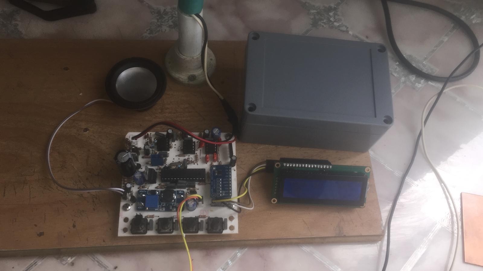

                        The design of the detector is finished, it seems that it will not fit in this box with a 16x2 LCD. When I put the batteries, card and LCD screen in the box, the height of the box will not be enough. Would it be better if I use a 128x64 OLED screen?
                        the detector is currently operating in single mode. in this mode;
                        1. precious metal-non-precious metal separation
                        2. threshold setting
                        3. sensitivity adjustment
                        4.sound level adjustment
                        I wonder if I add another mod, I will destroy the reaction of mineral, stone and brick in this mod, do you think it's appropriate?​

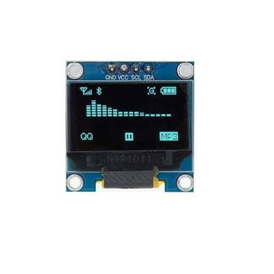

                          Which screen do you think I should use?
