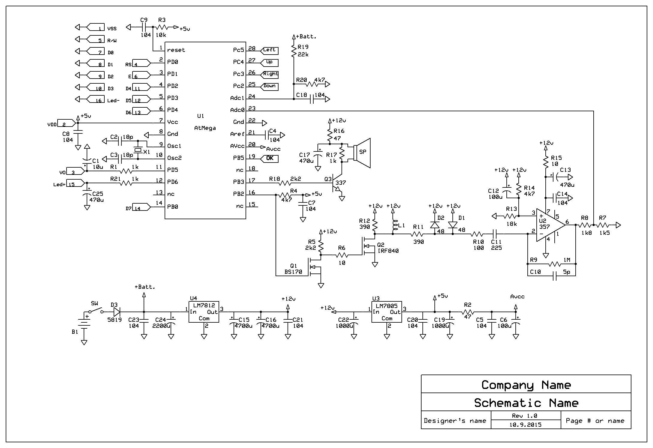

    A,B,C numbers have to be at their correct values which will eventually lead to a correct value of the Automated Delay.
    A = Ideally 300, however any number between 200 to 400 is fine
    B = Ideally 700, but any number around it is ok
    C = Ideally 800, but any number around it is ok
    Automatic Delay = Ideally 20, but any value from18 to 22 is perfect, and you will get it right once you adjust the A,B, C values.
    To do so, follow the below steps in order:
    1. Assuming the pcb components are with the designated values, check pin# 23 of the microcontroller with your oscilloscope (not a multimeter) and it should be 4.8V (between 4.75 and 4.85 volts) if it is not, you need to change R8 (1K8. To increase voltage you lower the resistance, and you do the opposite if you need to decrease the voltage. In my case,
      R8= 1.75 K and now voltage is 4.84v. Now you should notice an effect in the "A" value but keep in mind that is not its final value.
    2. Replace R9 (1M) with 1 mega potentiometer then turn the device on while the coil is connected to it. And start lowering the potentiometer to increase all of the three numbers but keep an eye mainly on "B" until you get it to its sweet spot. In my case, my numbers were about (170, 580 and 690) and I had to lower R9 to 560K to get (299, 700 and 802) and my amplifier is (LF157N). So if your numbers are higher than their supposed values, Instead of replacing R9, I would assume you need to connect a 500k potentiometer in series with R9 and start increasing resistance to lower the ABC values. (Do this step away from any metal objects even if it is not detected by the coil it still can affect the values)
      * Now with the corrected ABC values the automatic delay should be between 18 to 22. And with this, iron discrimination should be functioning.
    3. If your device is giving too much false signals, try to lower the sensitivity setting and see if that works out for you (this was my case). If it does not, replace R10 (100 ohms) with a higher value which I do not know by how much since it was enough for me to lower the sensitivity setting, but I would've increased the resistance staring from 150 ohms up 300 ohms or so. I mean until I gain a complete control to get rid of the false signals by using the device settings).
    4. Since I did not have to change R10, I'm not sure whether it has a significant effect on ABC values or not. If it does, go ahead and repeat step# 2. Also, double check pin# 23 of the microcontroller before soldering your new resistances.
    Now you are all set.

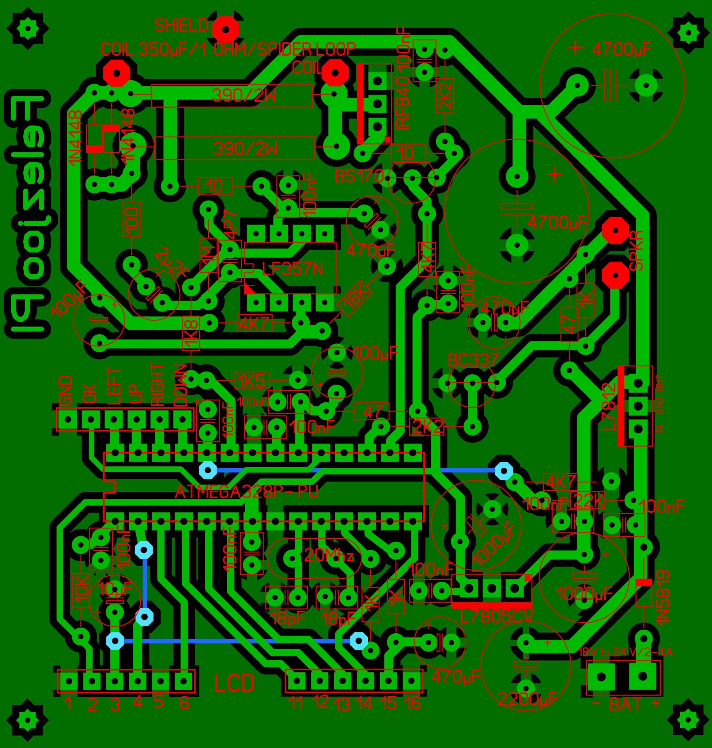

    • I do not recommend the pcb version I used (see photo attached) because it lacks enough space for the mosfet and regulators to have heat sinks, and for some of the components to not be in touch with each others, which I think it affects the detector performance.

      I hope one of the attached PCBs (which I found on the internet) can save you the troubles of making a new one. I renamed them 1,2 and 3 so it's easier for me to tell you the following:
      I only made # 1 twice which I destroyed due to soldering and desoldering too many times throughout my journey in shooting the troubles. It has decent space for components and also it has voltage check points which is crucial for such a device.(see the attached file named parts list regarding voltages) Just keep in mind that it has a little mistake which is R5, such that on the pcb it says 10K but the correct value is 2k2.
      #2&3 which I did not use in any of my felezjoo projects; therefore, I'm not sure whether they have any mistakes or not. But they are very interesting to me because they contain a trim-pot which is not in the schematic and I'm curious about it's purpose.
      I included a pdf file named parts list, which has notes from the maker himself worth reading at the bottom. Which suggests to use an 18 volts battery rather than a 24 volts one. I personally use a 12 volts charger (at my own risk) at the moment because I just ordered Li-ion batteries and waiting for them to be delivered. Therefore, I had to replace the 12v regulator with a jumber also I had to replace R19 (22k),which is responsible for telling the microcontroller how much voltage is left, with 10k resistor as you know the device is programmed to shut down at 14 volts. Now with the 12v charger, the screen shows voltage is about 21 Volts .
