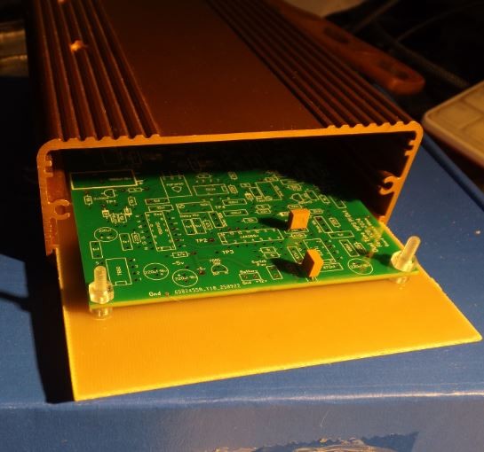

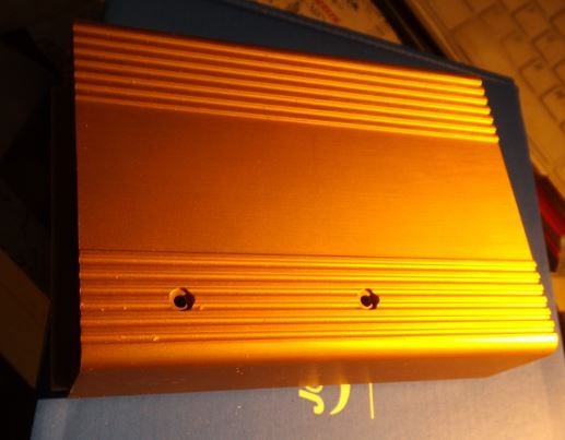

      Tried KiCad Problem auto routing works for very very simple pcb's This is circuit is fairly complex and requires manual routing which will become a major project in itself. DFBowers did a monumental job in doing the layout by hand.......don't want to re-invent the wheel. I have come up with a simple solution use a 100 x 200 blank board and mount DFBowers pcb with 4 nylon screws and nuts. BTW come across very cheap 200 mm x 100 mm Al extrusion enclosure @ a cost of 50c Will post pix's when done.

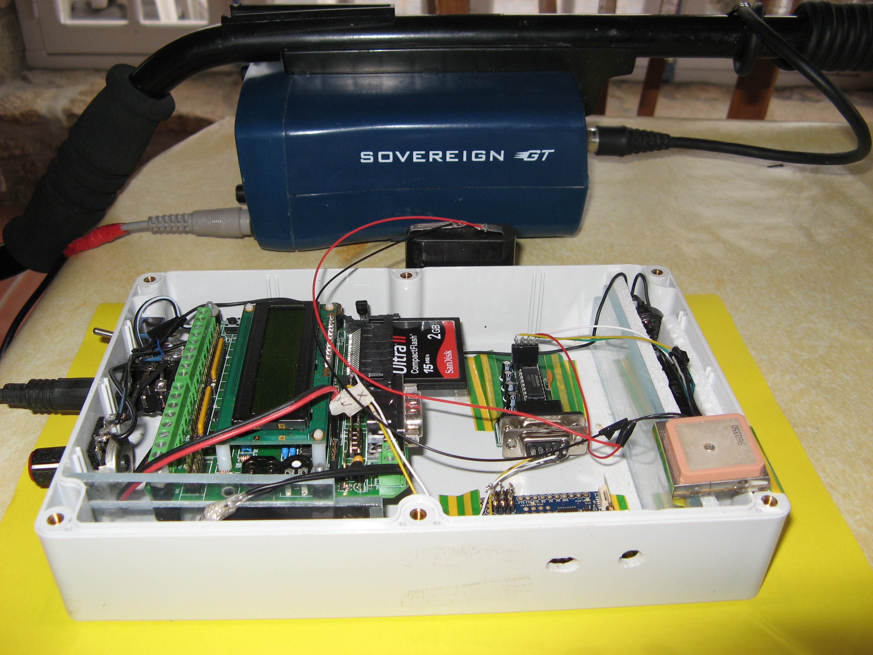

        My philosophy by necessity is to record analyse and record again using different detectors. My background is in GPS surveying from that experience I think postprocessing, build data bases, analysis and even AI is where you have to go if progress is to be made. I can build a high precision GPS postprosseing system for under $300 and a programmable GPS navigation system for between $500 - $1000 for semi autonomous work. In a way this is like going from single item production to mass production. I posted a proof of concept on DIYDrones in about 2008 - 2009 integrating GPS guidance, datalogging with a detector and I know OKM had a basic sort of system before that. Minelab took out a patent in 2012 on a basic GPS detector, something that was already in the public domain; nothing new there. Since then I have seen no evidence that any one has pushed this idea, basically its still swing dig. So much the same nothing new.
        Click image for larger version  Name:	IMG_0897.jpg Views:	0 Size:	1,007.1 KB ID:	441392
        Specific to your project, has to operates effectively in mineralized ground. Unless it can do that the Minelab Sovereign is always going to be better and thats decades old.

          • My cheap enclosure with board adapter Piggy backing pcb onto blank 100mm x 200mm single sided board see pics
            • Hi DIY's and Home Brewers
              Finally got majority components from Futurlec Miss-ordered a few parts like LM 393 ordered LM 339 instead which is 14 pin quad version .....bit hard to squeeze into 8 pin socket.......... pcb 90% loaded . Updated the material regarding minor capacitor quantity didn't check the resistor quantities. Found very hard to stuff the board from the screen overlay It would have been better have component id like R1.... C1.... IC1..etc cross reference to the cct diagram plan to do this soon
