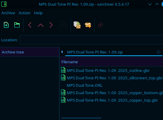

  • Tried to get PCB's made as per gerber files as posted here JLCPCB declined to manufacture there wasn't as solder mask for top & bottom sides. From the pcb image there doesn't appear one Is there one that can be posted
    • They should be able to make them without solder mask.
        Both solder masks for the top and bottom sides are located in the Gerber zip archive.
          That's what I thought. JLCPCB were unhappy to make the pcb without solder mask due track corrosion concerns. I even suggested tinning the tracks & not just the pads. My conclusion is their system is rigid expecting a gerber files like in the voodoo project
            not in gerber file posted in this thread see contents list in attachment
            could a correct link be provided please?
            • Hello Phred01,
              Take another close look at the Gerber file archive in post #1 of this thread. Everything you need is confirmed here. Here's a screenshot of the archive contents. I also downloaded the file and opened all the Gerber files. They are all complete enough to produce a circuit board. I don't know where you downloaded your Gerber files from, but they are complete in post #1.​
