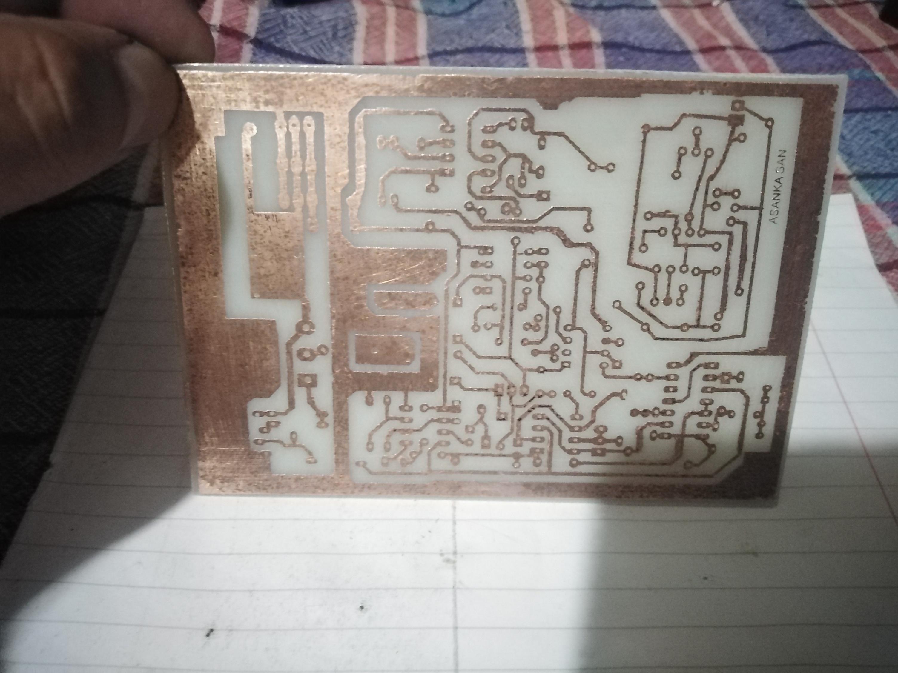

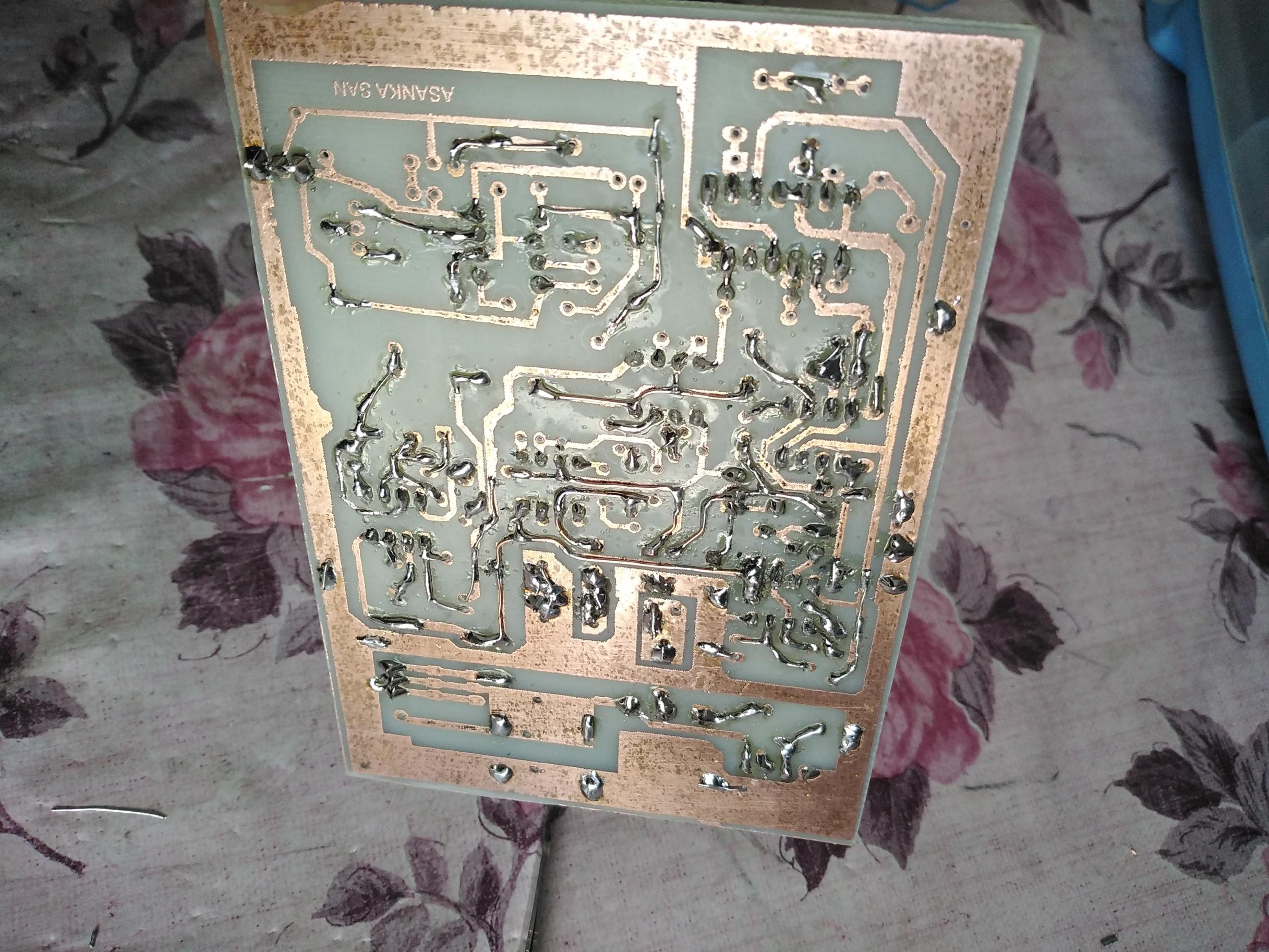

              Hi Asanka Sanjeewa
              have you made this PCB? If not, do you know who did it?
Name:	TL12000 PCB COMPONENT PLACEMENT(r).png
              I just haven't tried this yet, I want to do it soon.

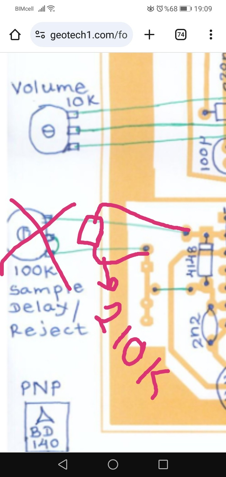

                • Dear Asanka, I canceled the janper here, but the device works but does not detect it. And I canceled the delay potential meter and installed 210k.

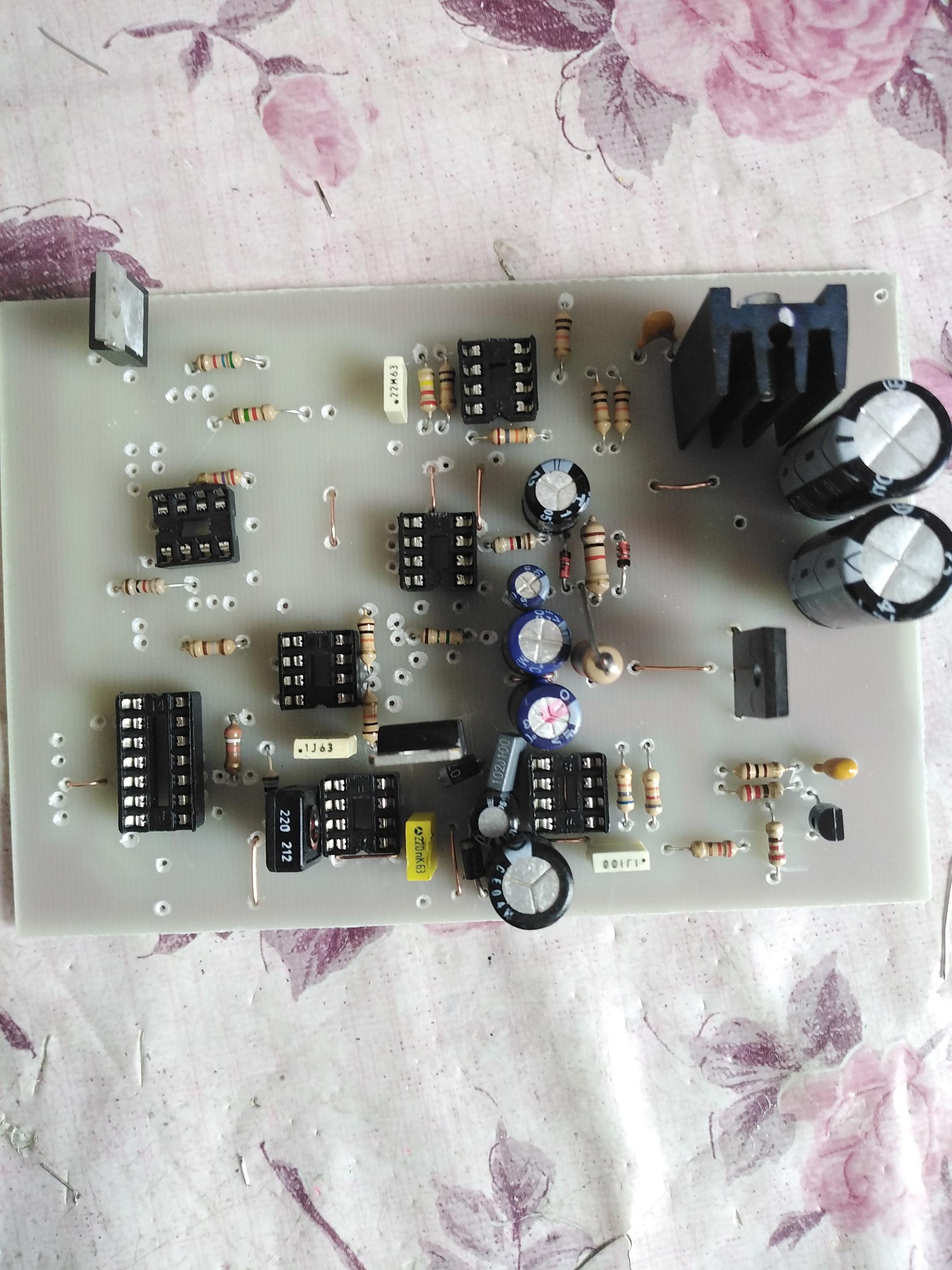

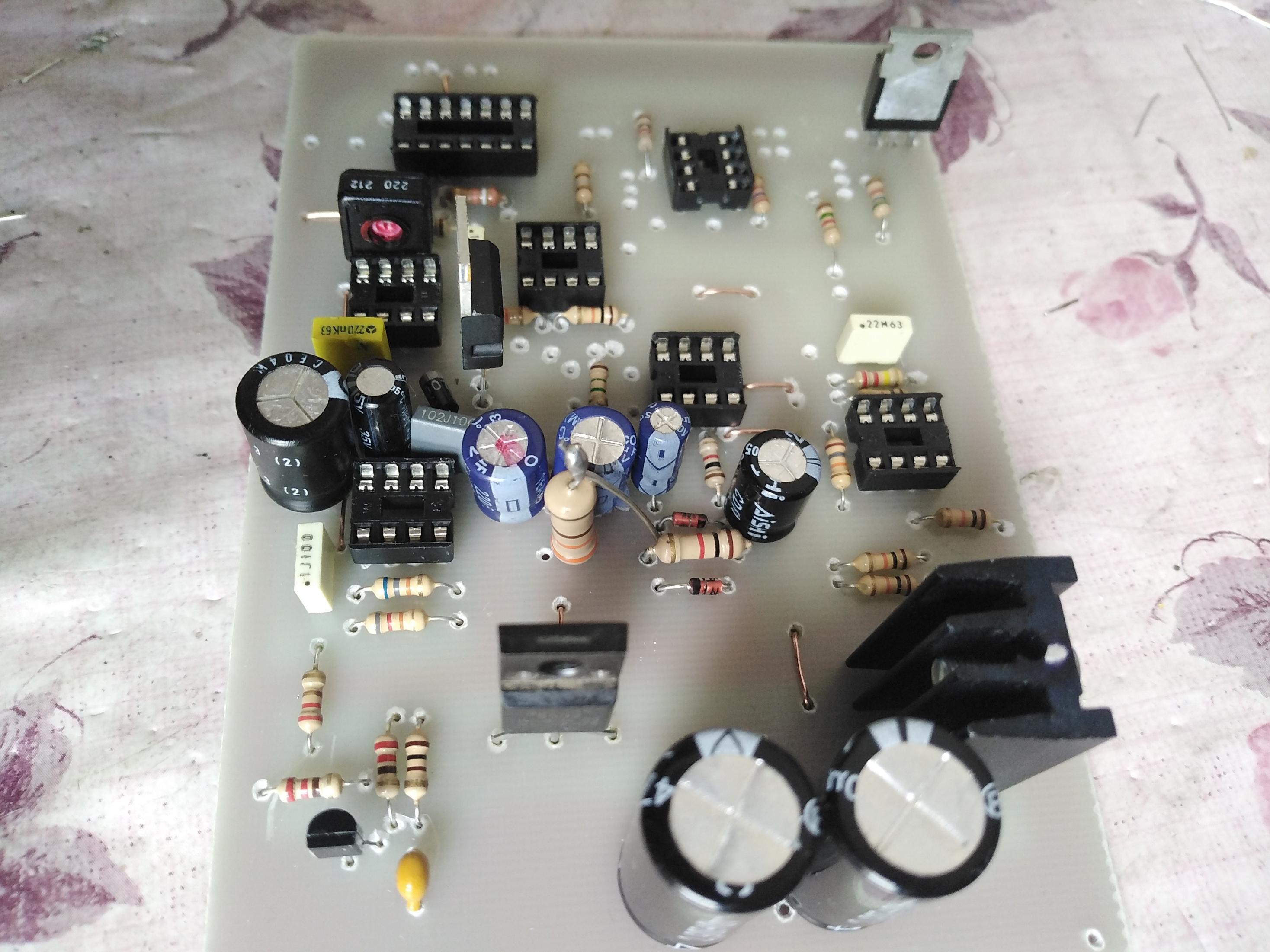

                    • The device was not stable, the ticking sound was constantly increasing, it would not stop. I found the best sensitive point and added the resistance, it was very nice, it was stable and very deep, but there was no separation, one last thing, the sound is very low. I want to make a Sar schematic, by the way, I could not find an LM709, I used TL081, I used TL072 instead of LM358, it was great.
                      • Pcb
                          • Originally posted by haylaz0036 View Post
                            Why have you removed the jumper here?

                              • Dear Asanka, I assembled the device and started it, the sound is great, the performance is very very bad, the MOSFET is overheating, I did not change it, there is no MOSFET TRANSISTOR left, moreover, you say run it at 400mhz, the batteries will run out in 15-20 minutes in the field, the issue of separation is yes, it isolates iron type metals, the funny part is that it isolates under it. That's all I have to say, do not deviate from the original map, the only sound is weak, another problem
