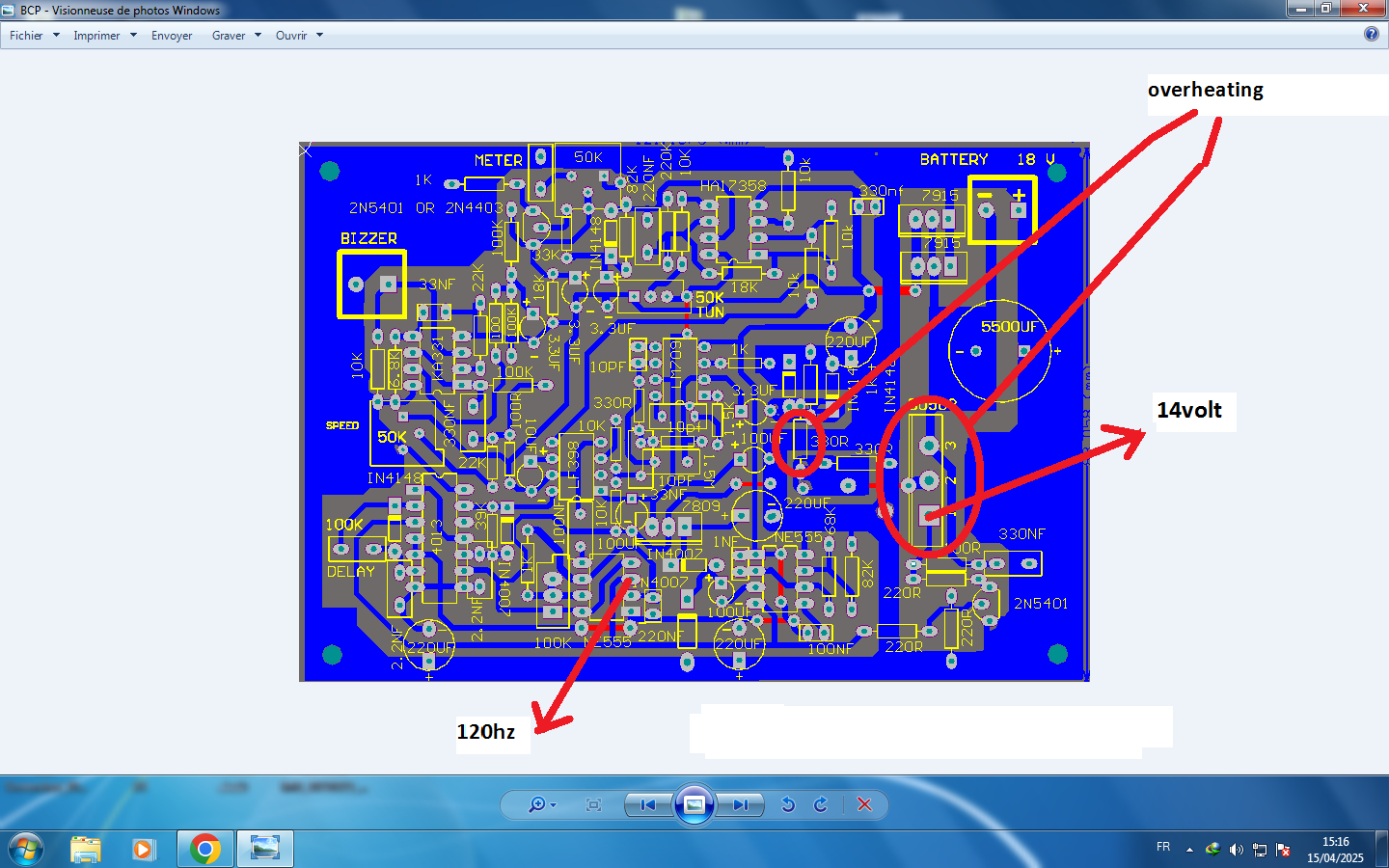

                          • Greetings to everyone. I have just finished making the TL12000 device, but unfortunately, it doesn't work as there is a continuous sound. The BU2508AF transistor and the 330-ohm 2-watt resistor are overheating. When measuring the coil terminals, I find 19 volts, which is the power supply for the device. When measuring the voltage at the base of the BU2508AF transistor, I find 14 volts. Please, what is the problem? Note that I am working on this version. Thank you.

                            • Hi
                              Check-out this post... This will give you the answer to your problem.
                              tl12000 isn't stable - Geotech Forums
                              • hi geomax.
                                The link you provided didn't solve my issue. Anyway, thank you.
