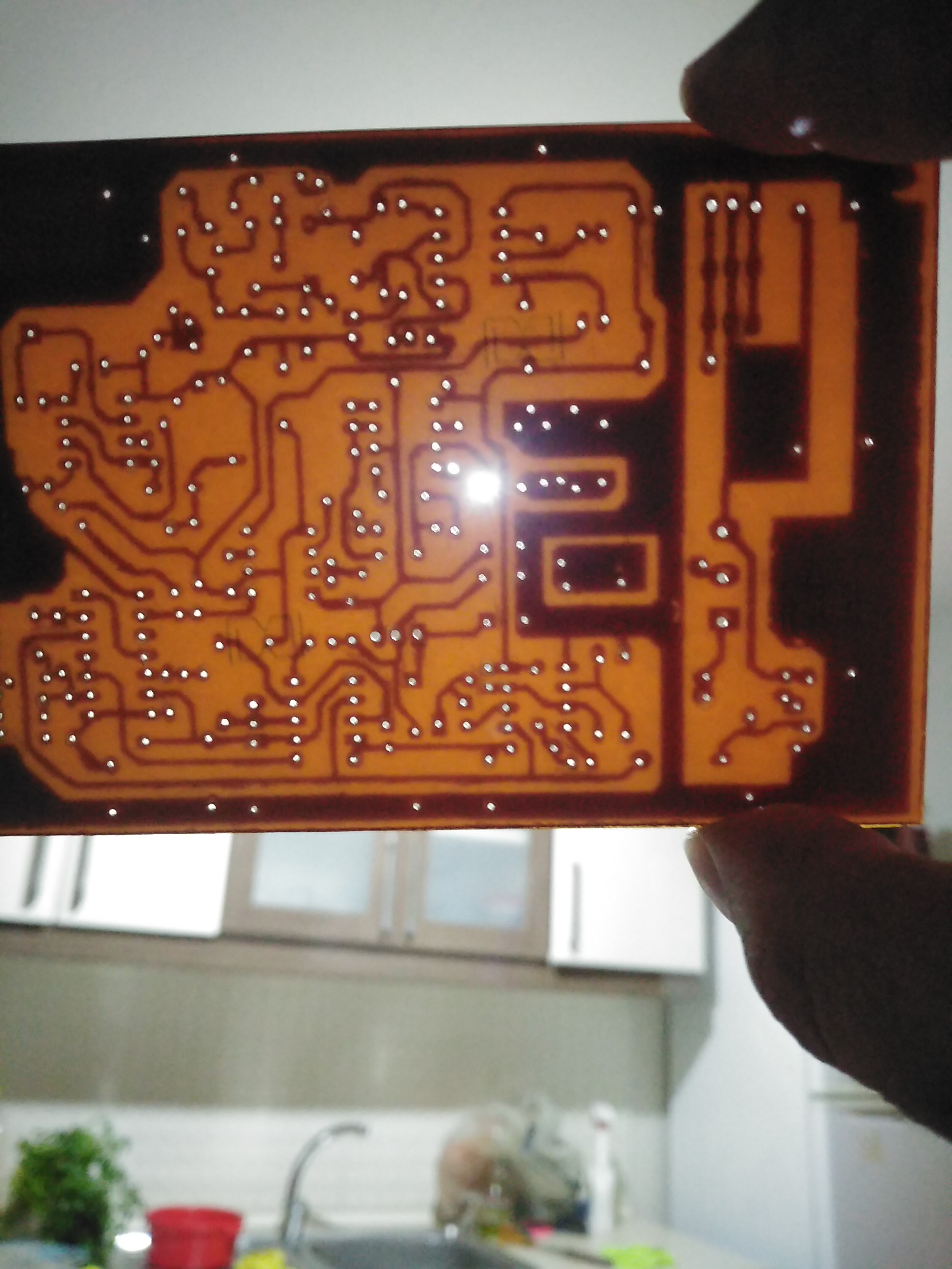

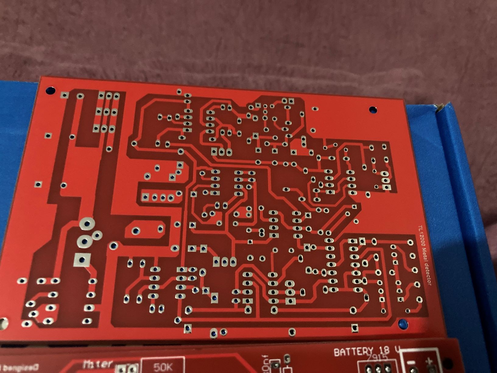

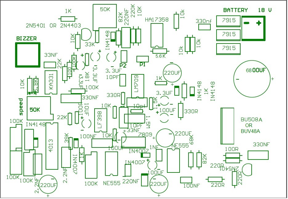

          I found something called Sx500, it looks very similar to TL12000.
            And I don't know this working pcb I'm a newbie
              And this is what I found on the new Internet

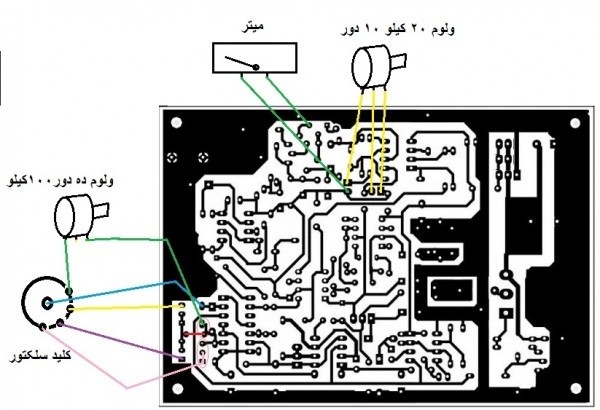

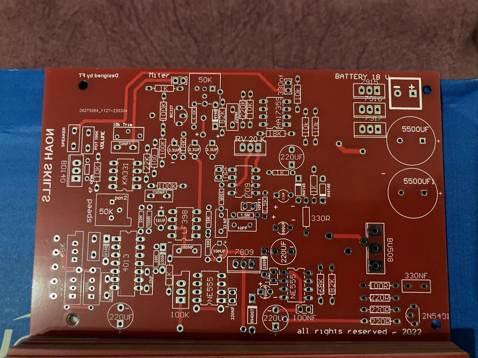

                This card is on sale in Iran for TL12000

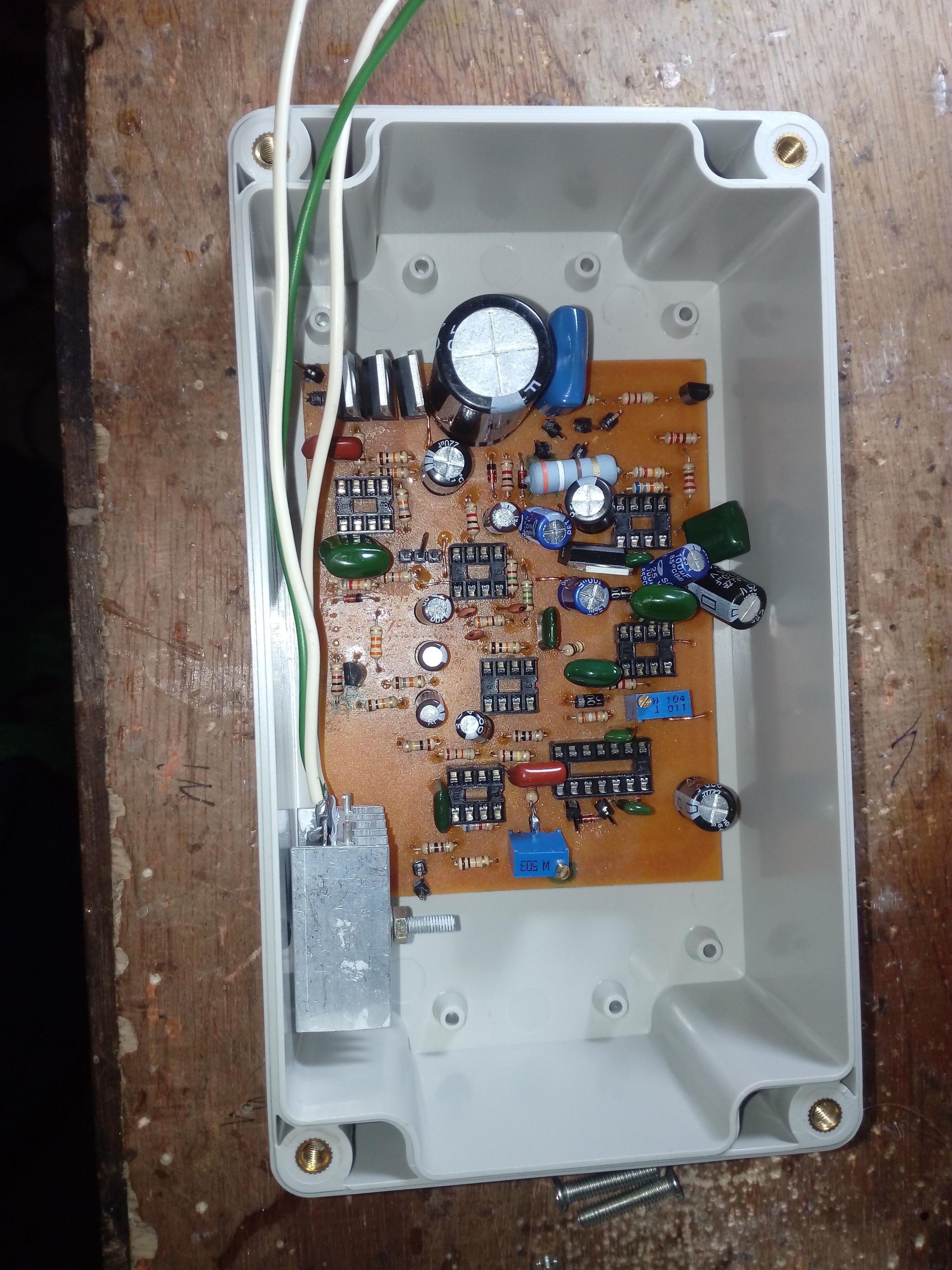

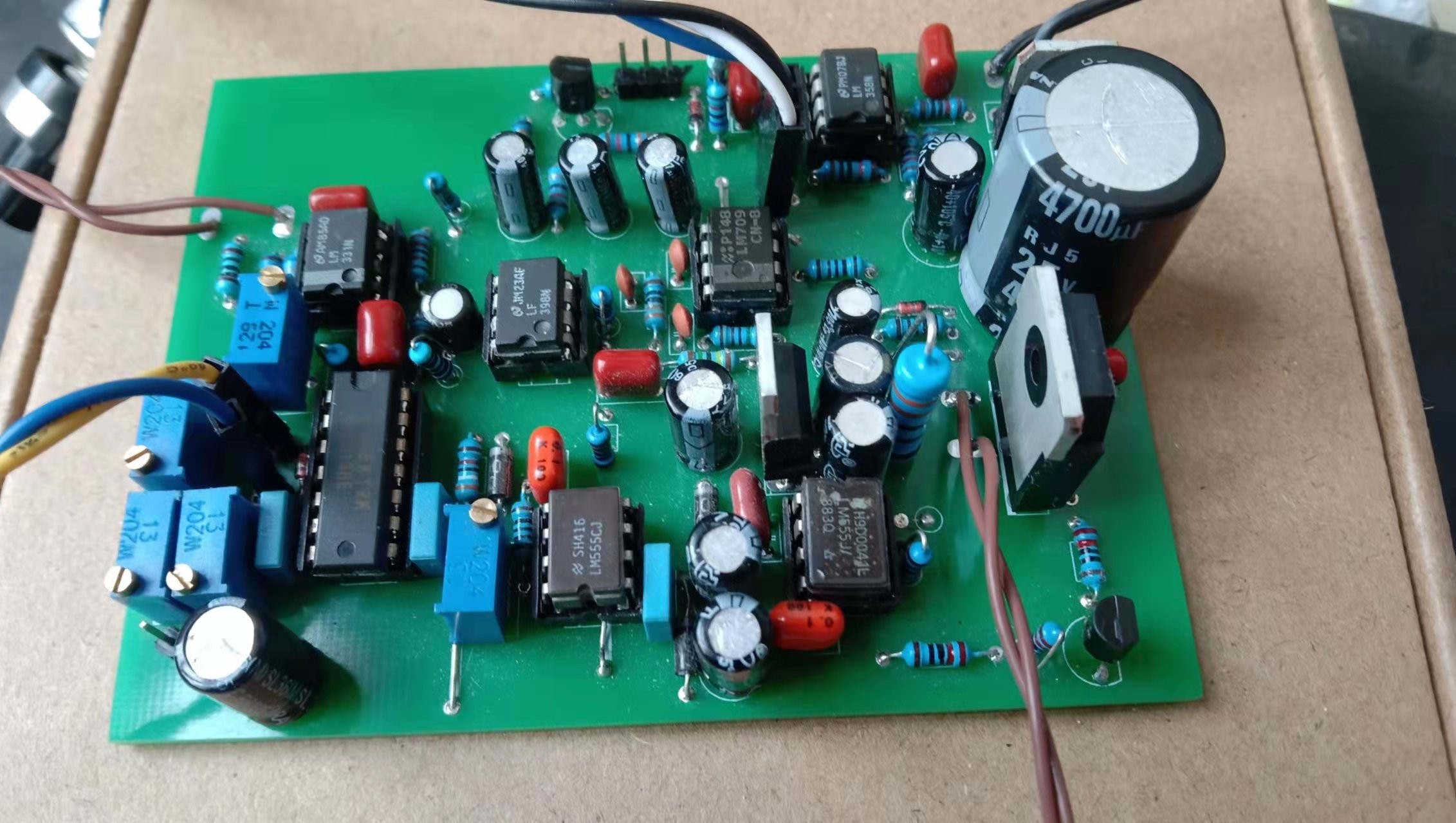

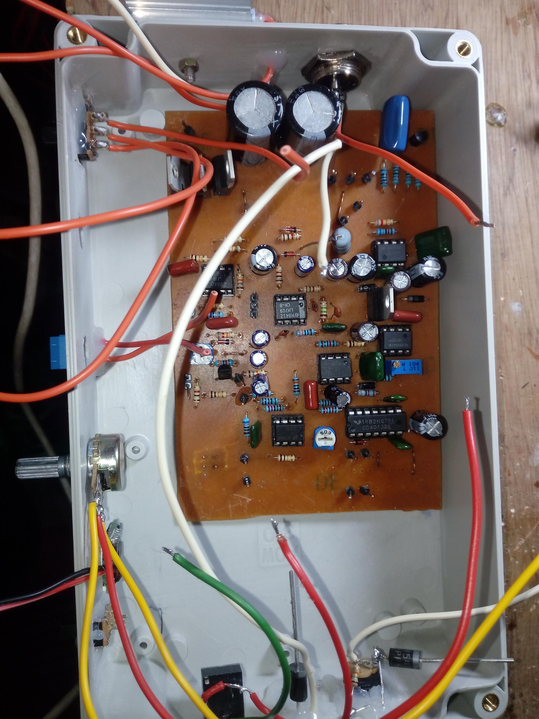

                    This friend made the working pcb, it works now, I will do it just so I don't make any mistakes.
                      This is me

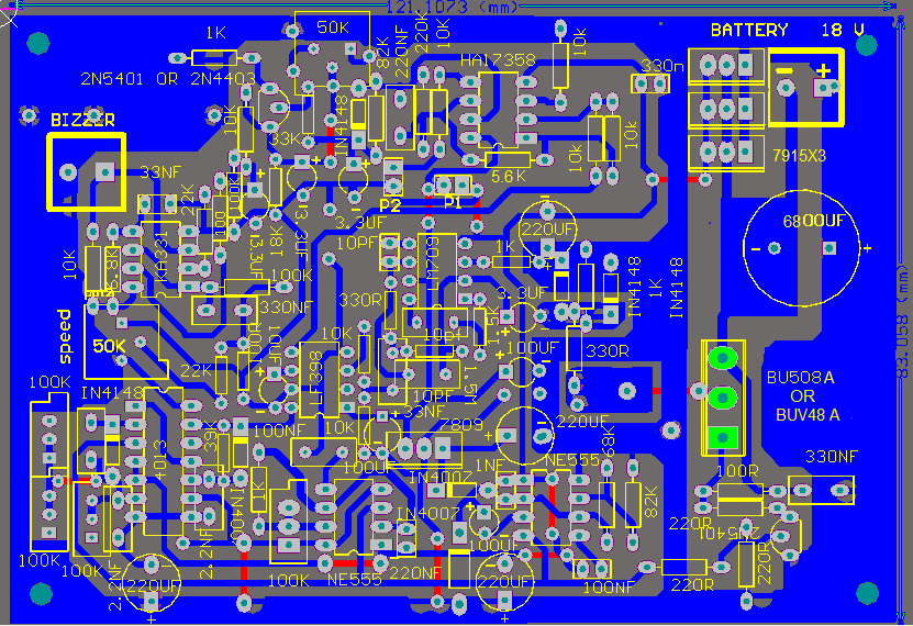

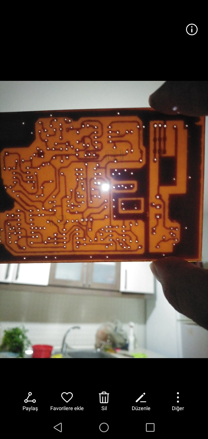

                              This is my old TL12000 Board [ this forum published board ] . It works but can't iron rejection.
