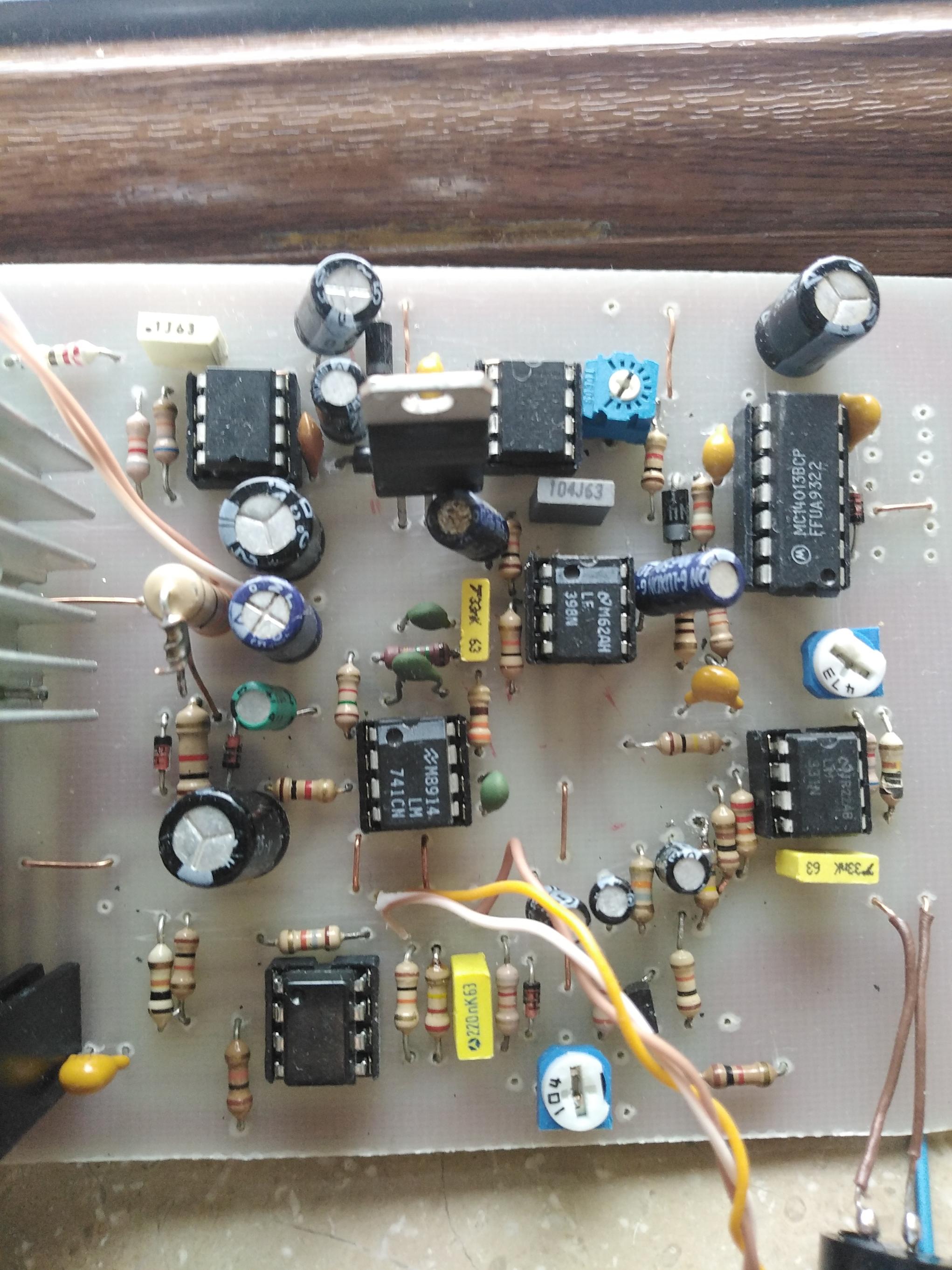

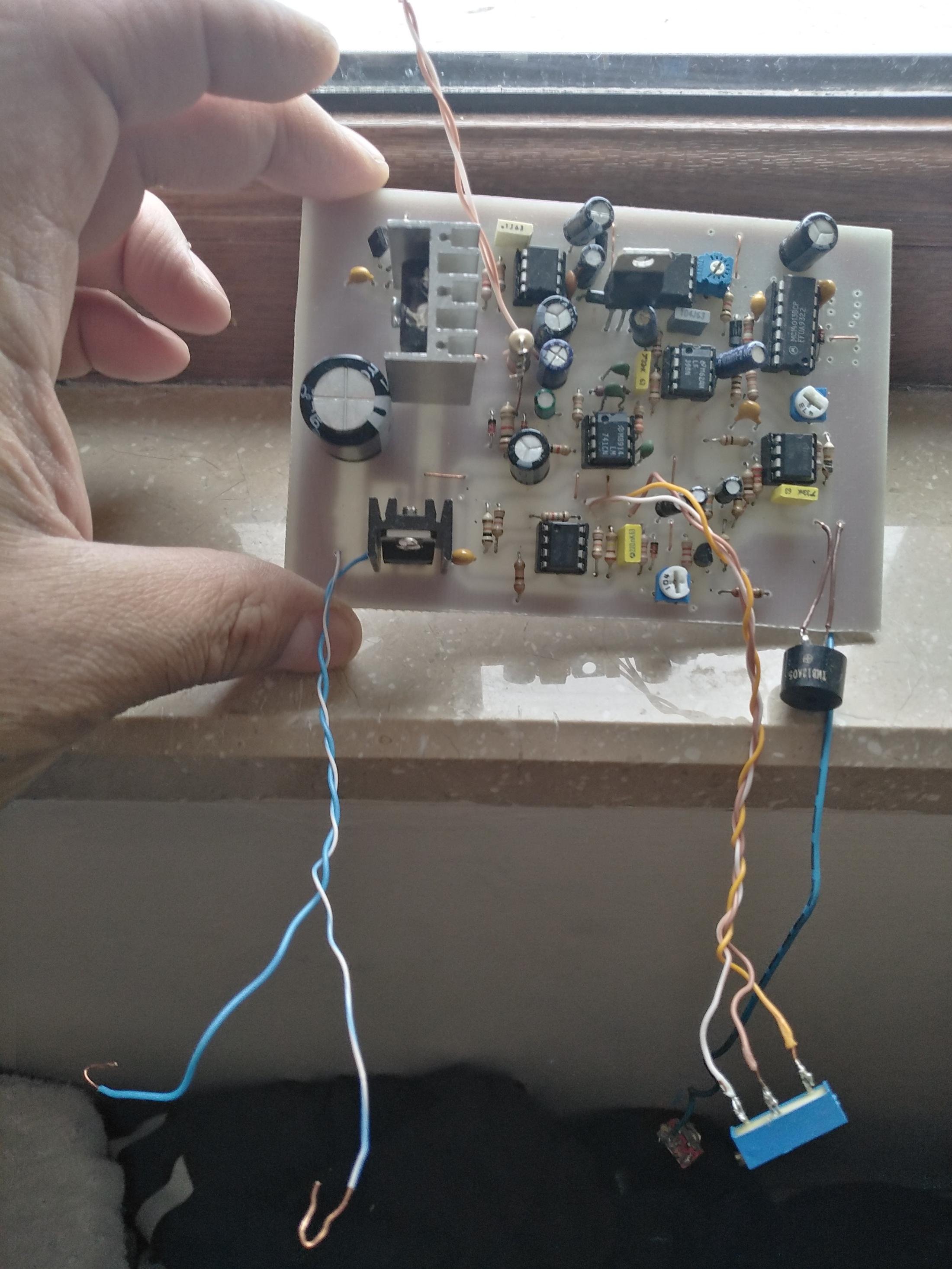

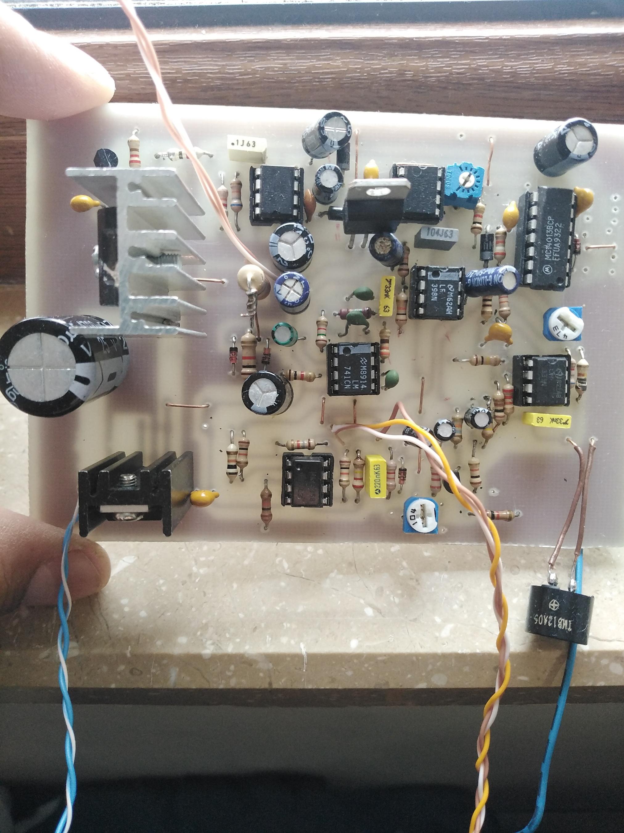

    why do you have in your PCB 3x a voltage regulator connected in parallel?
    • #47
      One stabilizer is heating up, so he installed three. Here is a video (subtitles available)
      • #48
        Hi GeoMax
        SORRY FOR DELAY
        I am a person who works by testing everything practically rather than theory. It got hot when I put a regulator ic. Actually, when you put 3 in parallel, it works fine. Do not forget that this circuit requires more negative current. Also, when taking just 200mA from cheap Chinese ic, it gets hot.
        • #49
          Yes I did it and it worked I couldn't find LM709 I put LM741 instead it works but not very deep

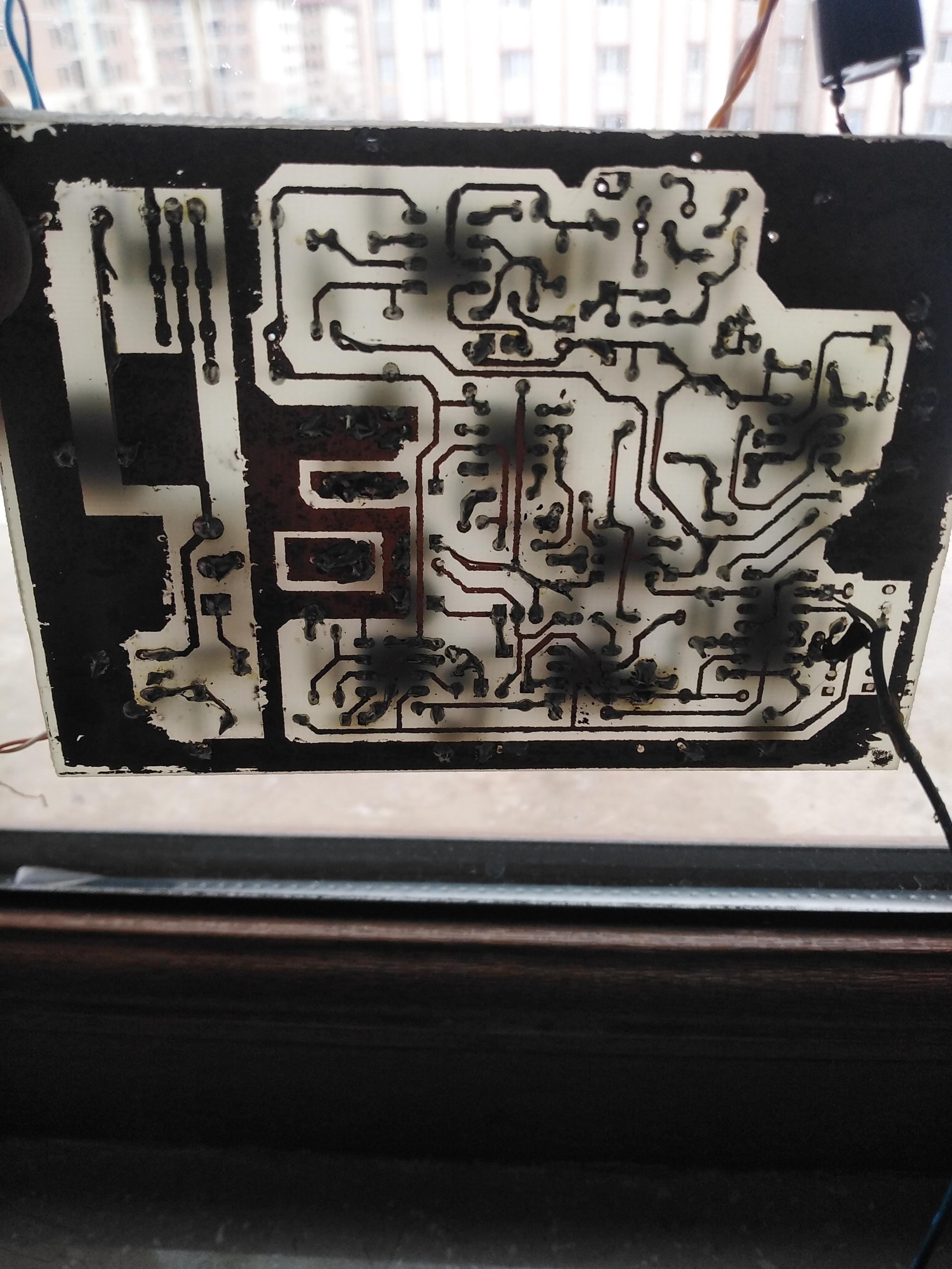

                        100/100 Pcb
                        • #58
                          Originally posted by haylaz0036 View Post
                          Pcb
                          This board is very sloppily made. Here are just a few of the blots.
                          • #59
                            Yes, but there is no problem with the other one, everything comes out clearly
                            • #60
                              No, not everything is clearly. There is no connection with the contact here.
