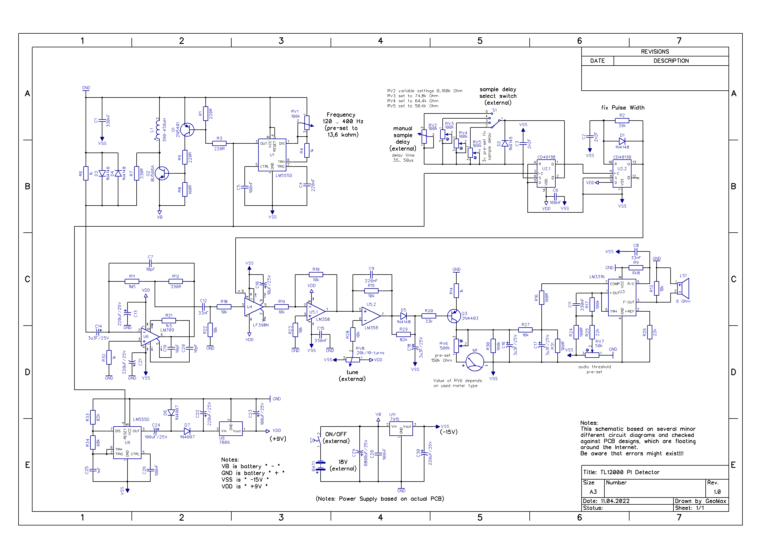

    Do you have an oscilloscope screenshot of the TX signal? What pulse settings is the TX signal set to? And also the schematic that corresponds to your (blue) PCB layout?
    • .Unfortunately, I currently do not have an oscilloscope. The schematic I worked on is this.
      • ​Sorry.The plan you attached earlier is not the one. I worked on this plan instead.
        • This is not the circuit diagram of the blue PCB. I know that for sure. Just have a look at the bottom right corner. I redrew the schematic based on others which are floating around the Internet.
          • Thank you for your help. Do you have a correct plan that works for you?

                      • Hello,
                        I know the circuit. You can see who drew the circuit diagram at the bottom right. Also, read the notes above in the circuit diagram. This circuit diagram does NOT correspond to the blue circuit board that was previously published.​
                          Hello,
                          Hello GeoMax
                          That's exactly what I meant.
                          I would be happy if there was a board for this project.

                            • hi for all.I made a TL12000 device, but it does not sense any metal despite the availability of the required frequency and voltage.i need your help .thank you in advance
                              • Which of the many TL12000 detector versions did you build? I already know of six different TL12000 circuit diagrams, and there are probably many more circulating online. The same applies to the PCB layout. I published the circuit diagrams I know of in post #85.
