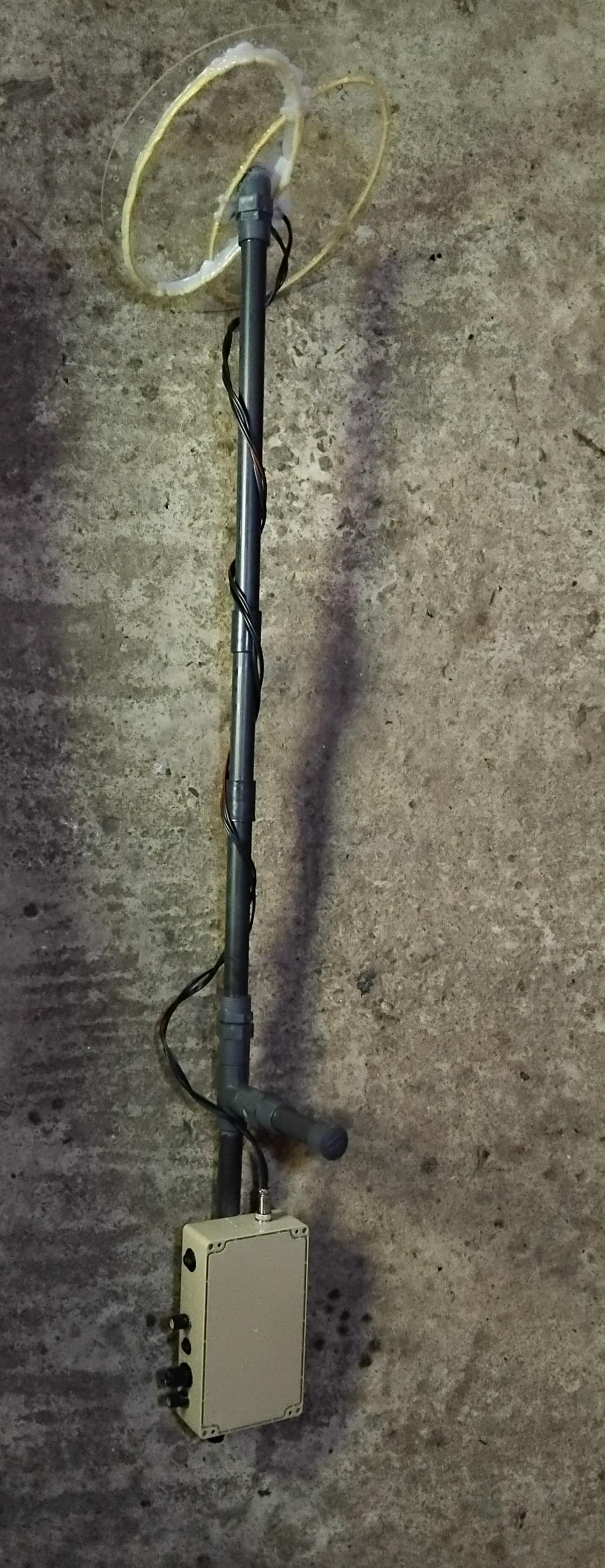

    • Dear forum friends,
      I am not saying anything about this TL 12000, a person who bought the device [yellow picture posted in this forum] that I upgraded at my strong request sent a video today. Because they don't want to show their faces, the sensitivity of the device is reduced and the video is taken.The instrument clearly distinguishes the large steel knife, iron knife, brass and is only sensitive to the small gold ring. This is at the minimum sensitivity of the device.Even if an old circuit diagram is properly modified, superior results can be obtained. Its discrimination ability exceeds that of modern barrakuda and felezjoo. This is the last thing I have to say.

          • Hi Asanka Sanjeewa​
            I had the fun of comparing the TL12000 and PI Polones circuits in detail and came to the conclusion that they both have the same origin, namely the Sandbanks PI from 1979. Is it possible that your TL12000 audio modification was taken from the PI Polones circuit? Because that part of the circuit is 100% identical to the original PI Polones circuit.
            Both are old circuit designs but still easy to replicate for beginners and show quite good results in treasure hunting. But they are not really made for the gold fields in Australia or the USA.​

                • Dear Geomax but there is no yellow map
                    Hi Asanka Sanjeewa​
                    Dear GeoMax
                    You are 100% right. I said that there is supply weakness in the voltage regulator oscillator. And you yourself admitted that sandbank, polones, TL 12000 are very similar. So I did this POLONES vco replacement.​

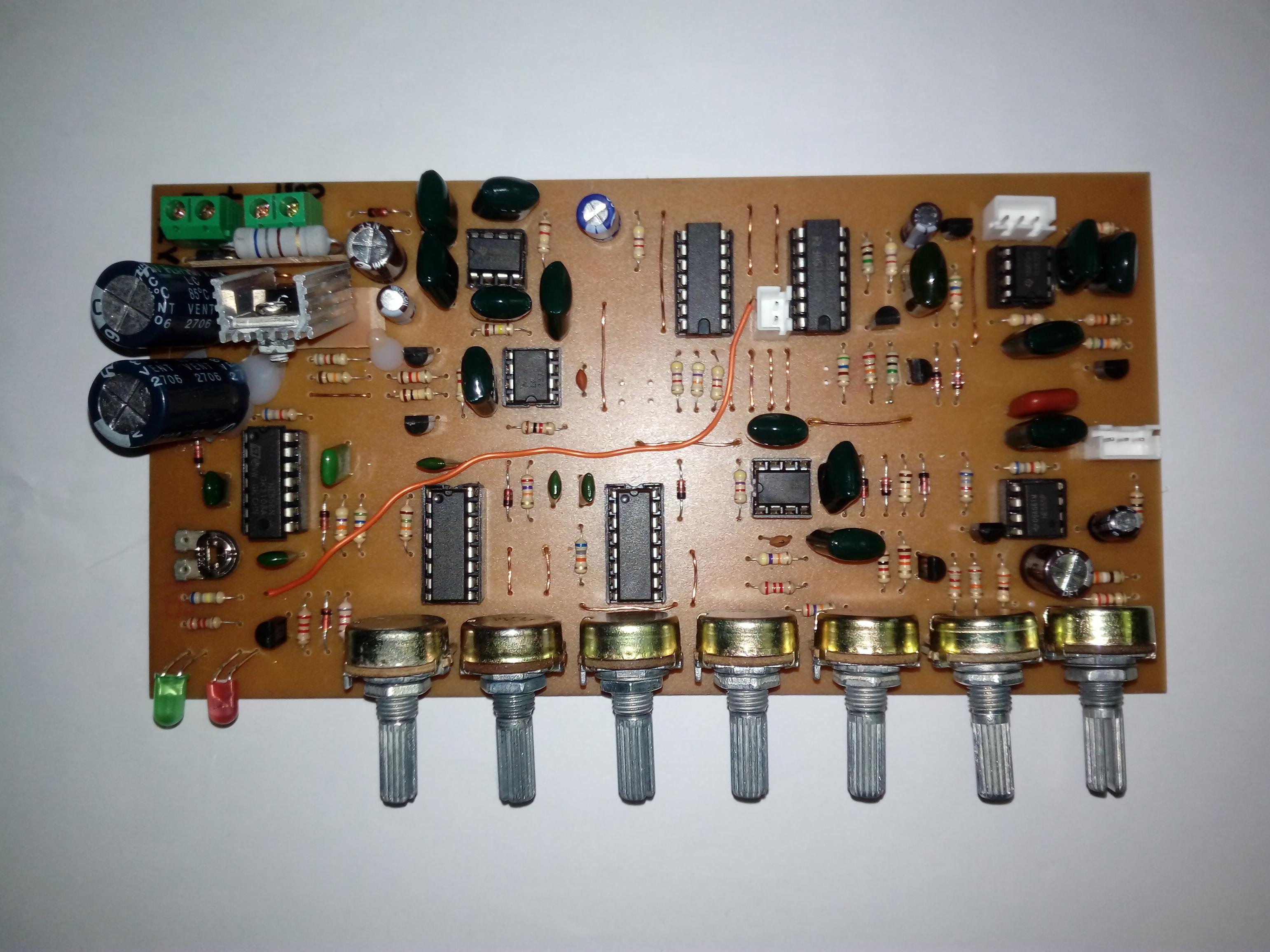

                    • Hi Asanka,
                      Where in the schematics is "voltage regulator oscillator"?
                      • my Dear Emersonpaz and haylaz0036
                        The people who sent that video told me not to post it on social media. This is their help to my strong request. So if you send a gmail address of a member here, I can give it to you personally.It is not a problem for a foreign member to get it and upload it to youtube and put the youtube link in the forum. Please give me an address where I can upload the video.
                          Hi Asanka,

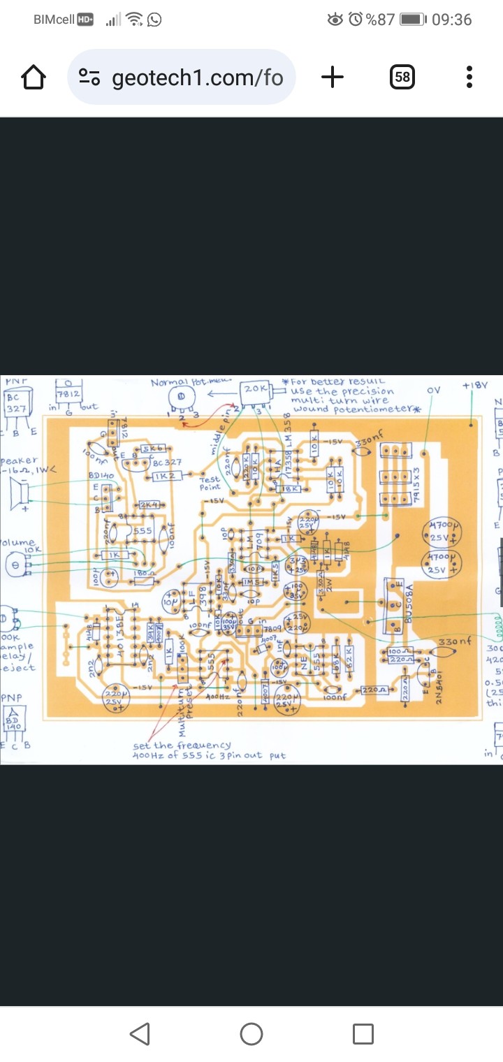

                          Hi Detectorist#1,
                          probably Asanka means the 555 timer circuit that feeds the LM7809 voltage regulator circuit part. There is a nonsense connection from the TX oscillator to pin 4 of this 555 timer. This connection is not present in the original Sandbanks PI or PI Polones.​ See the red arrow below. Pin 4 should be connected to pin 8 of the 555 timer IC, just as it is shown in the original Sandbanks PI and PI Polones schematic.
Name:	TL12000 PCB COMPONENT PLACEMENT(rm).png
