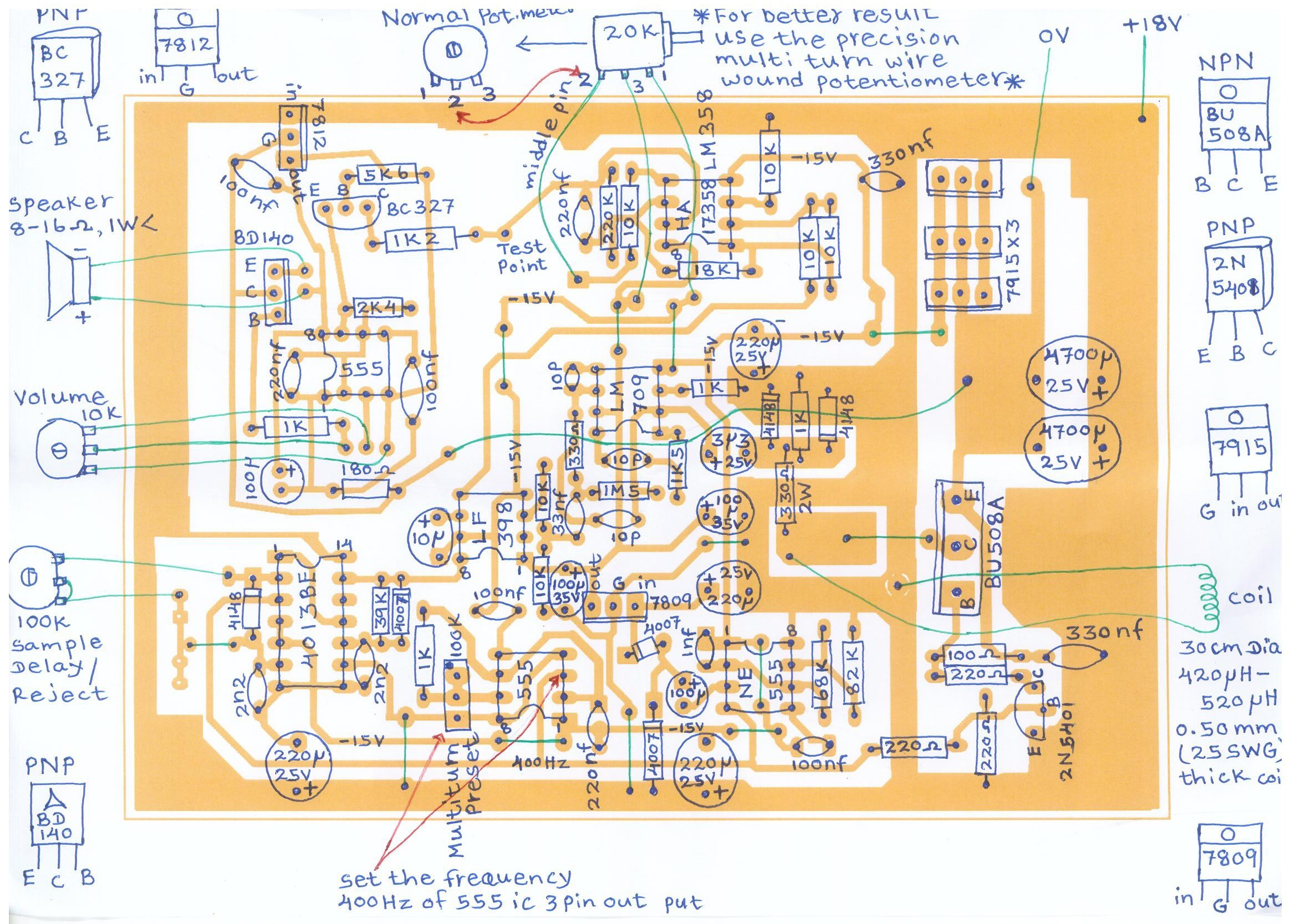

    have you made this PCB? If not, do you know who did it?

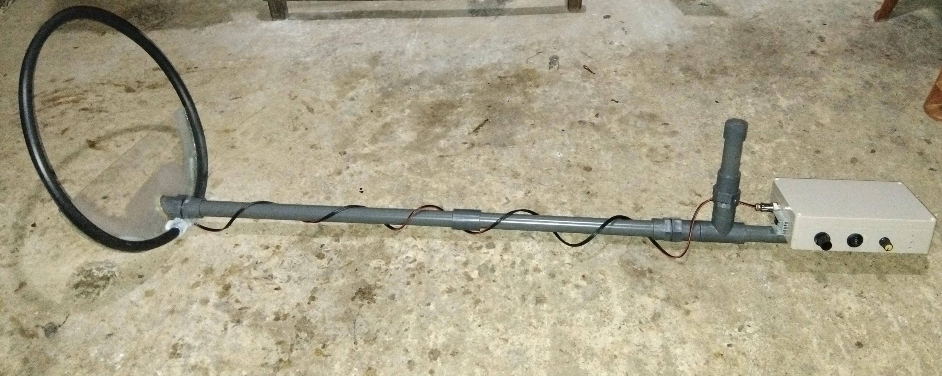

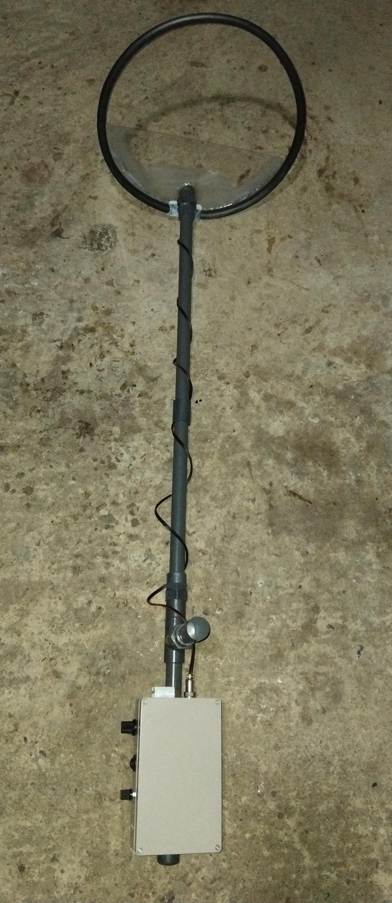

      The story is this, I first tried some circuits on the internet. I have posted some photos of those made before. But they have a common weakness. The circuit works but the iron rejection and VCO design is poor. But 4013B flip-flops and LF398 sample and hold ic design impressed me. Finally i made the circuit VCO and some changes. The yellow paper posted in that forum is all my handwriting and my modification. After preparing everything , i checked the place where test point is written on the paper [ LM358 opamp output line ] the circuit very accurately shows negative volt for iron object and positive volt for non ferrous metals. I made and sold 3 piece of these. They said [ buyers ] that is suitable for an environment with high mineral content with mountainous rocks. Photos were not take in a constructed circuit because of the risk of share. I will post a photo of one that was made and sold with this. If i make a new one again, i can put it.
      • #93
        Dear GeoMax
        I respect Kt315, Qiaozhi, dfbowers and their service in this forum.I have also gained a lot of knowledge because of these gents. I decided to post this circuit as a respect for it. I have put everything without hiding anything, of course. I have to tried to explain in a simple way that even the least knowledgeable member can under stand without going into deep theories. But remember that this is a rejection based on the conductivity of the metal objects.But rejection is much better than other PI devices. Please be careful when you sold 20K multiturn potentiometer because change pinout than normal pot.meter.
        There is nothing to question again. All information required for construction is provided without lack. It is your choice to believe or not. I have fulfilled my responsibility.
        Have a nice day friend

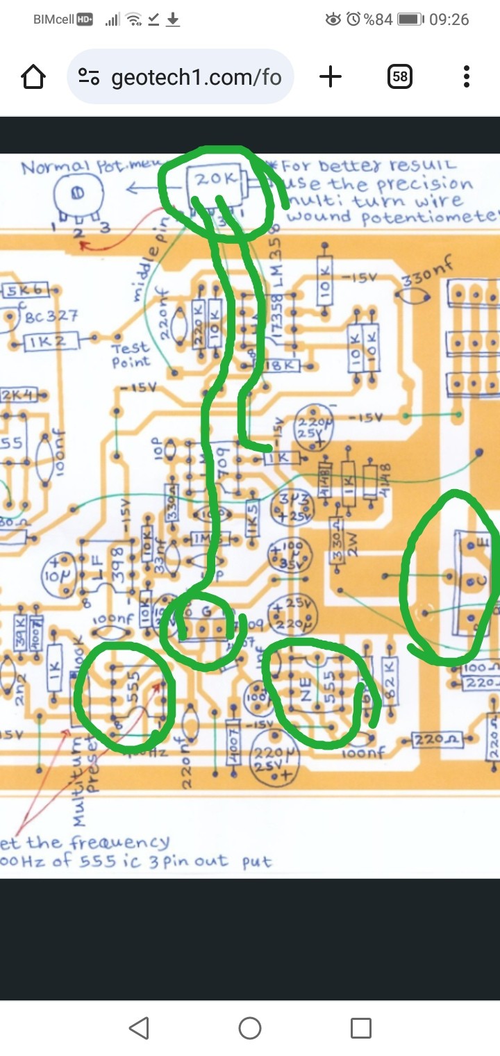

          This is another scheme, LM331 is gone, NE555 is there, is the sound of Barbie strong now?....... I want to ask something, you say to run it at 400hz, if it runs at 400hz, yes, the depth increases, but the battery cannot withstand this and everything heats up, I want to ask something, the 7809 output and the 7915 output are connected to the 20k pot, they get very hot, what is the joke here?

              By asking such questions, I understand that you do not even have basic electronic knowledge. The Lm331 is replaced with a better volume, volume controllable VCO circuit. Who told the big lie that the whole circuit heats up when increasing to 400Hz frequency? It is a fault in your circuit.if your BU508A transistor get hot please put the heatzink.Positioning of variable resistor [20K] is correct. It controls the output of the LM 358 [integrator]. Also if your variable resister get hot to connect this way maybe wrong pin soldering. I have not tried coins. Men's wedding rings look 8 inches [ in the discrimination mod ]. I am from sri lanka [ south asia country]
