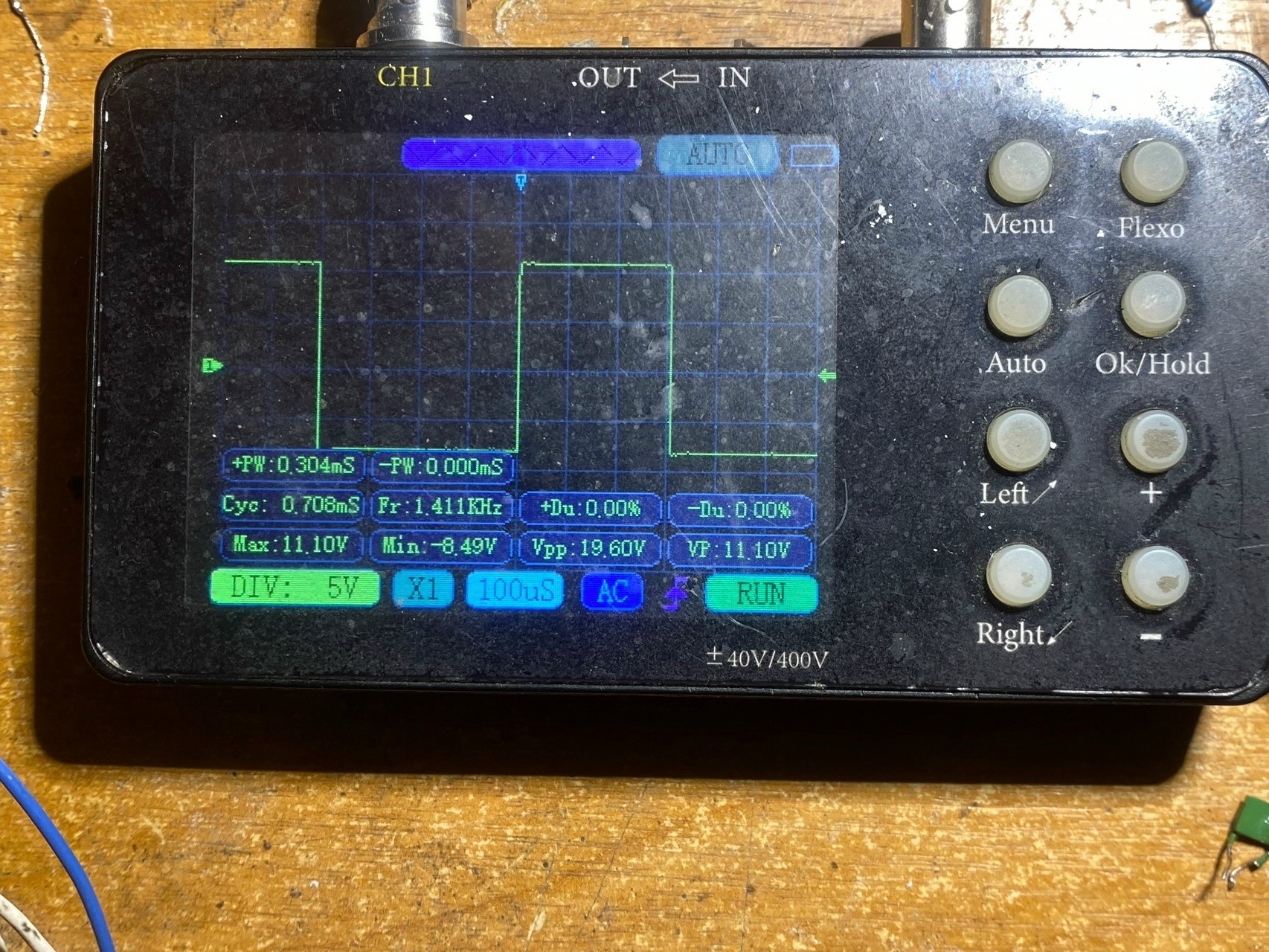

              Hello Click image for larger version  Name:	ОС.jpg Views:	0 Size:	666.4 KB ID:	442647 Detectorist#1​. The coil is a 22 cm diameter ring. I accidentally connected the 12 V supply in reverse polarity, and everything went wrong. I'm starting over. Check the oscilloscope; I can't get the pulses to match. I've changed the microcircuits, capacitors, and resistors. The voltage on the power supply microcircuit is the same, between -9.4 V and +9.4 V.This is from pin 2 of the CD40106 microcircuit. Thanks for your help.

                Hello Detectorist#1 there seems to be an error in the circuit. Capacitor C41 is connected to -8 volts. I'll check this evening.​
                • Hi Ahmat,
                  This is not error. All voltage threshold levels of 40106 IC are given as voltages between inputs and pin7 (Vss). No connection of the 40106 to GND. If you connect C41 to GND, will be big jitter in output signal of U9A. The source of this jitter will be all parasite AC signals on the GND traces of the board.​
