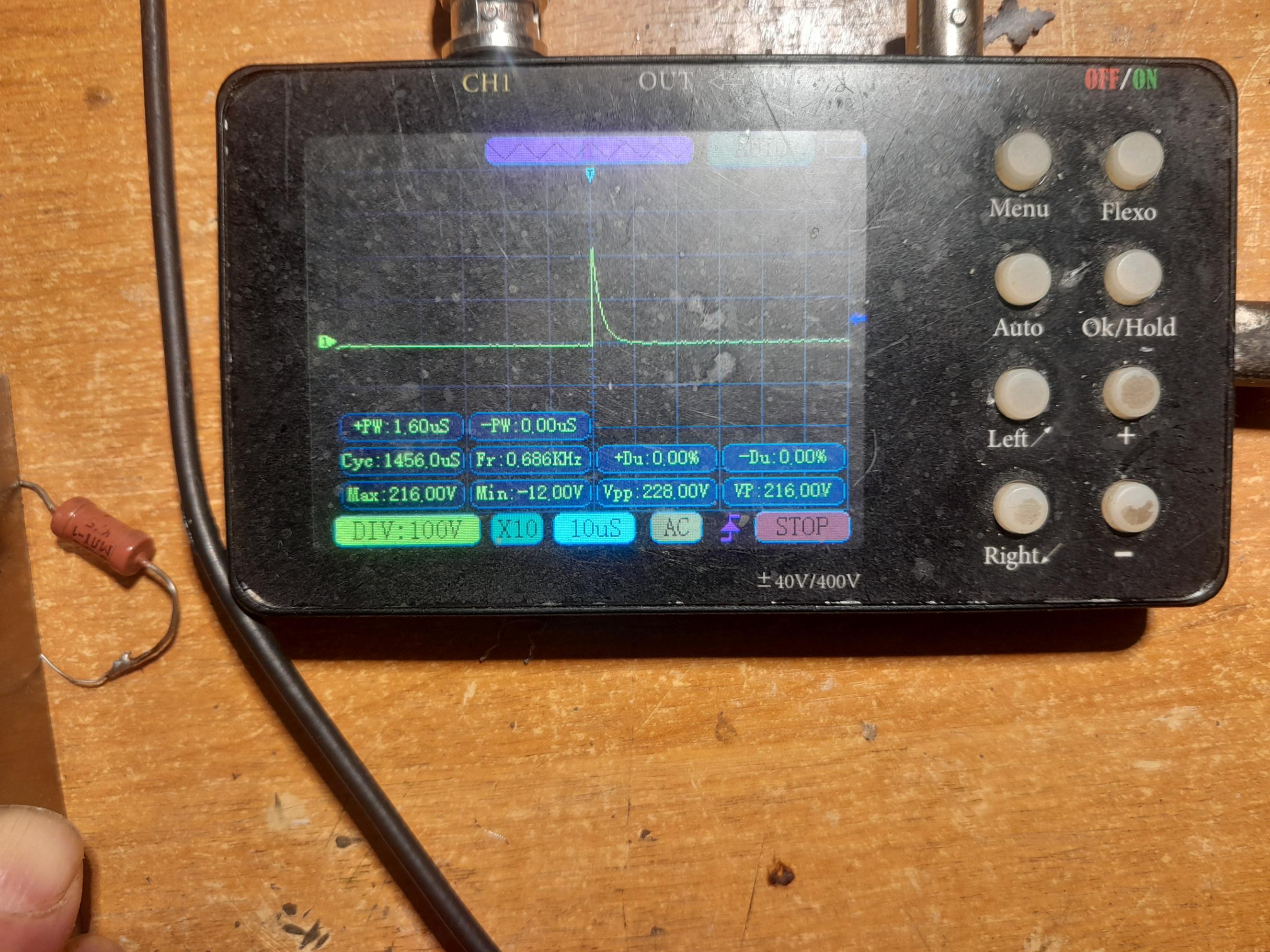

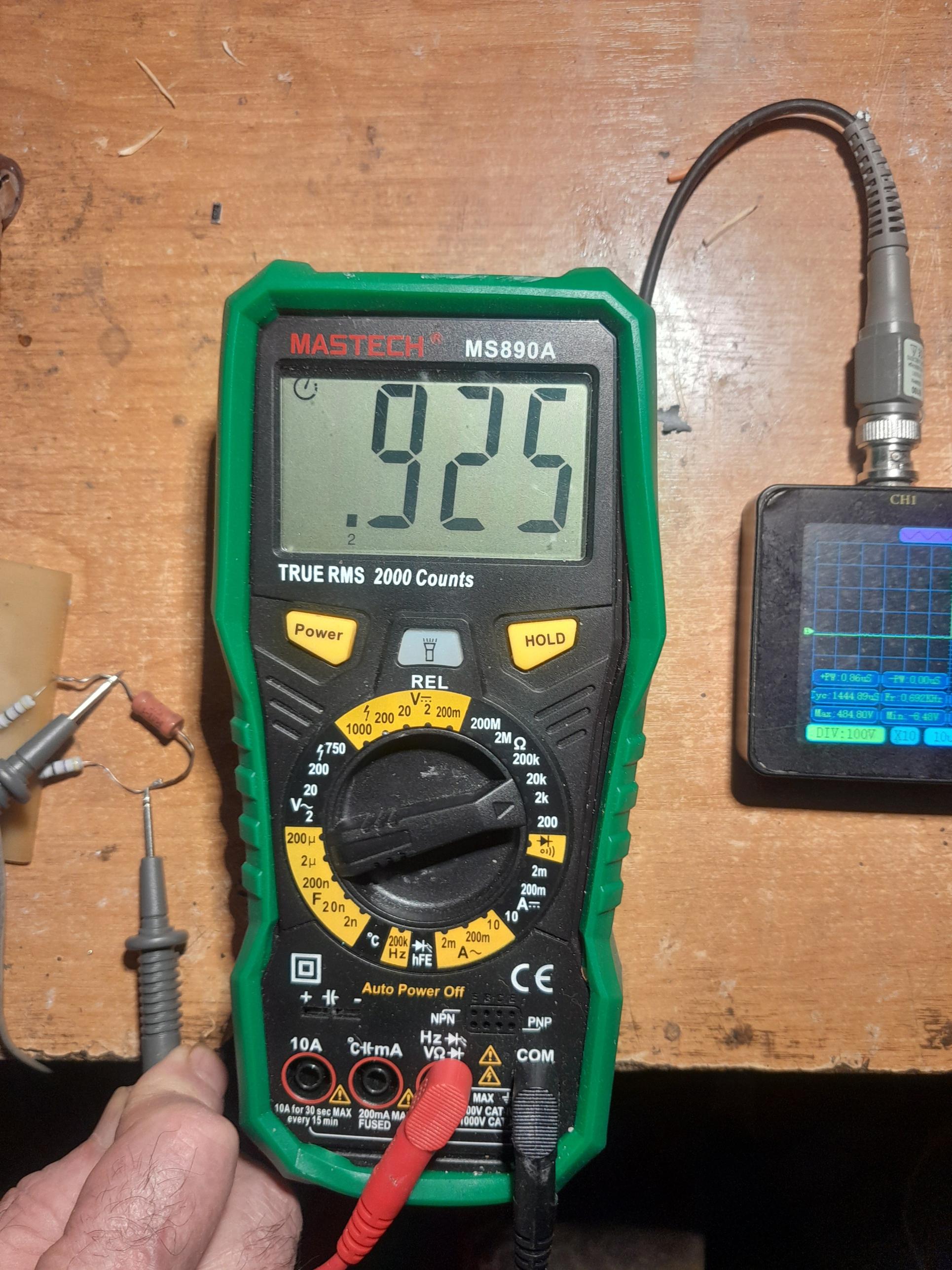

    Hello. As you recommended, I reduced the R57 resistor to 59 ​ ohms. More precisely, I set the constant resistor to 39 ohms and the variable resistor to 20 ohms. Before the changes, the TX was 200 µs; now it's adjustable between 50 and 100 µs. Resistors R1 and R44 are 5 ohms. The metal detector's current consumption with the coils connected is now 220 mA. The main thing is that the metal detector is working. Its metal sensitivity is good, but it needs some adjustment. I need to finish the DD coil. I'm posting a photo showing how I shorted a 925-ohm resistor with a utility knife, Click image for larger version

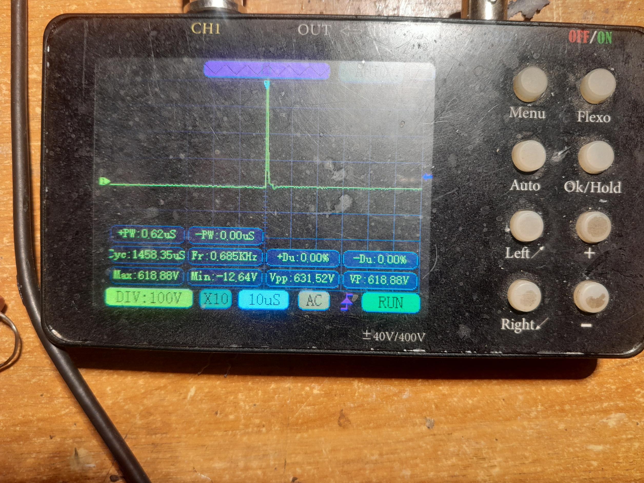

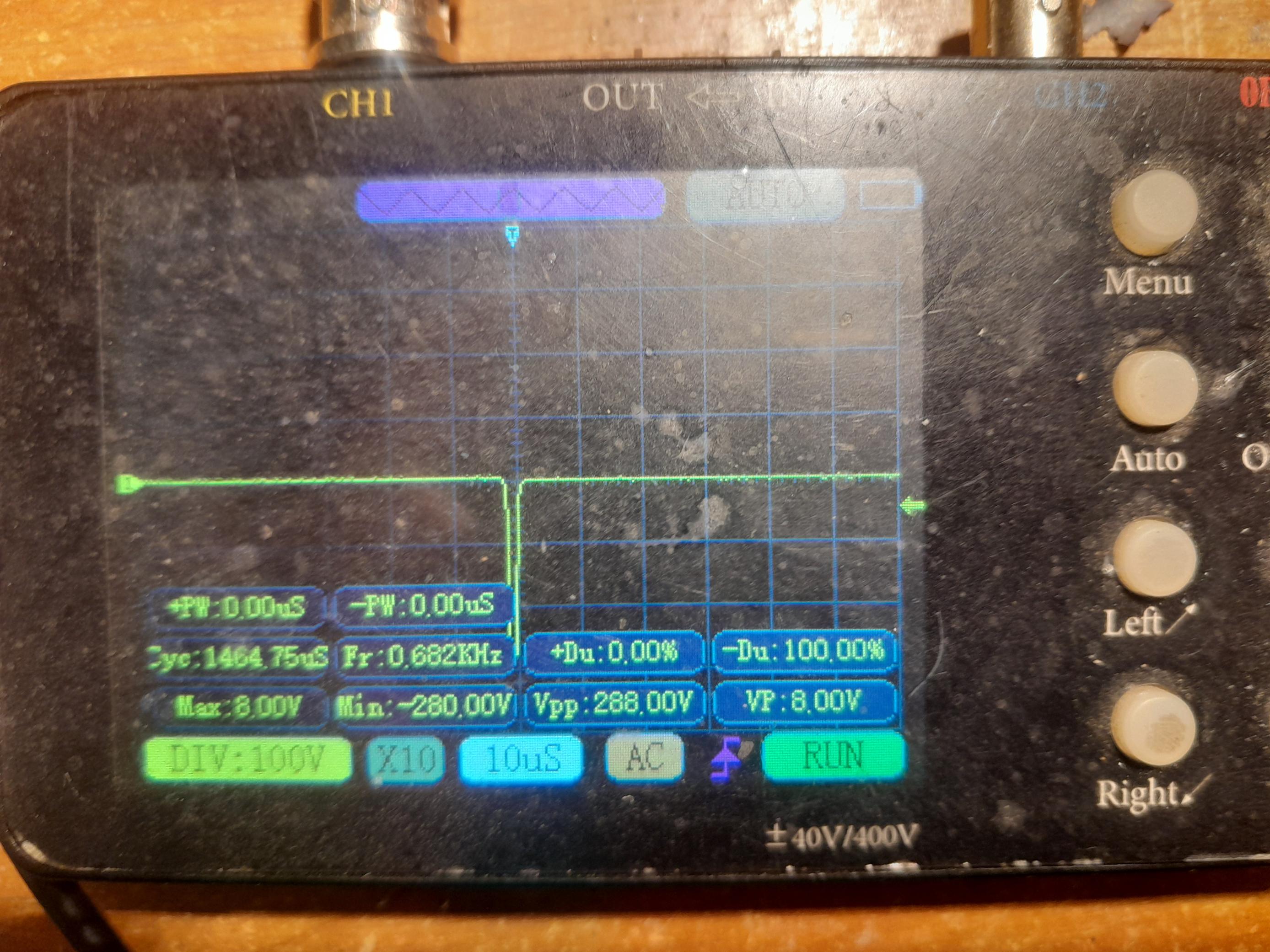

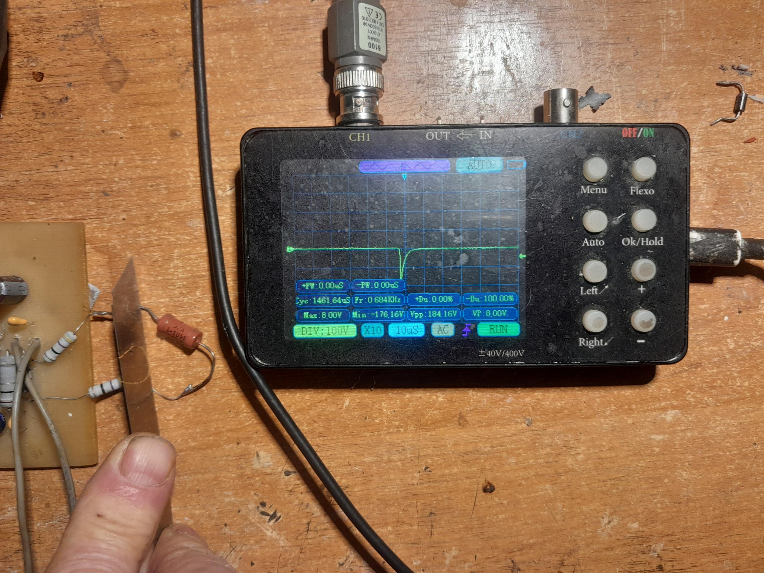

ID:	442094 It is clear that when the resistance R24 R25 decreases to 94 ohms, the voltage decreases and the duration of the reverse pulse increases. My current resistor is R24 + R25 = 700 ohms. I have a few questions for you. 1. Is it possible to increase the pulse voltage by replacing the STTH1L06 diodes with higher-voltage ones? 2. Please recommend a low-frequency amplifier, as I don't have a 150-ohm speaker. 3. How to increase the reaction speed of a metal detector The most interesting thing is that the microcircuits are all Chinese, and I examined them with a TL062 and TL072 oscilloscope. They were defective, but the circuit works.Thank you so much for developing this scheme.

            Capacitor C34 turned out to be 1nF, so I replaced it with a SD40106. Each one had different pulse lengths, from 50 µs to 400 µs. The frequency also varied from 700 Hz to 1600 Hz. Only one chip gave 100 µs with the component values ​​according to your schematic. I buy components from AliExpress. Because of sanctions, the Chinese are selling nothing but defective parts.Russian companies sell the same thing, only at a much higher price, and you have to wait two months for your order to be fulfilled. I built three metal detectors— this , a Tesoro Lobo, and a Magpi—and threw away over 50 microchips. Instead of the IXTP10P50P, I installed an MTP2P50G for an experiment. It ran for over an hour without heating up. Resistors R24 and R25 are 250 ohms each. One pulse is 400 volts, and the other is 500 volts. Duration is 3 µs. Please advise how to make them equal. Preferably 500 volts each.
            • Hi Ahmat,
              For equal positive and negative peek voltage, the sum of Rds of N-ch MOSFET + R34 have to be equal to the sum of Rds of P-ch MOSFET + R15.

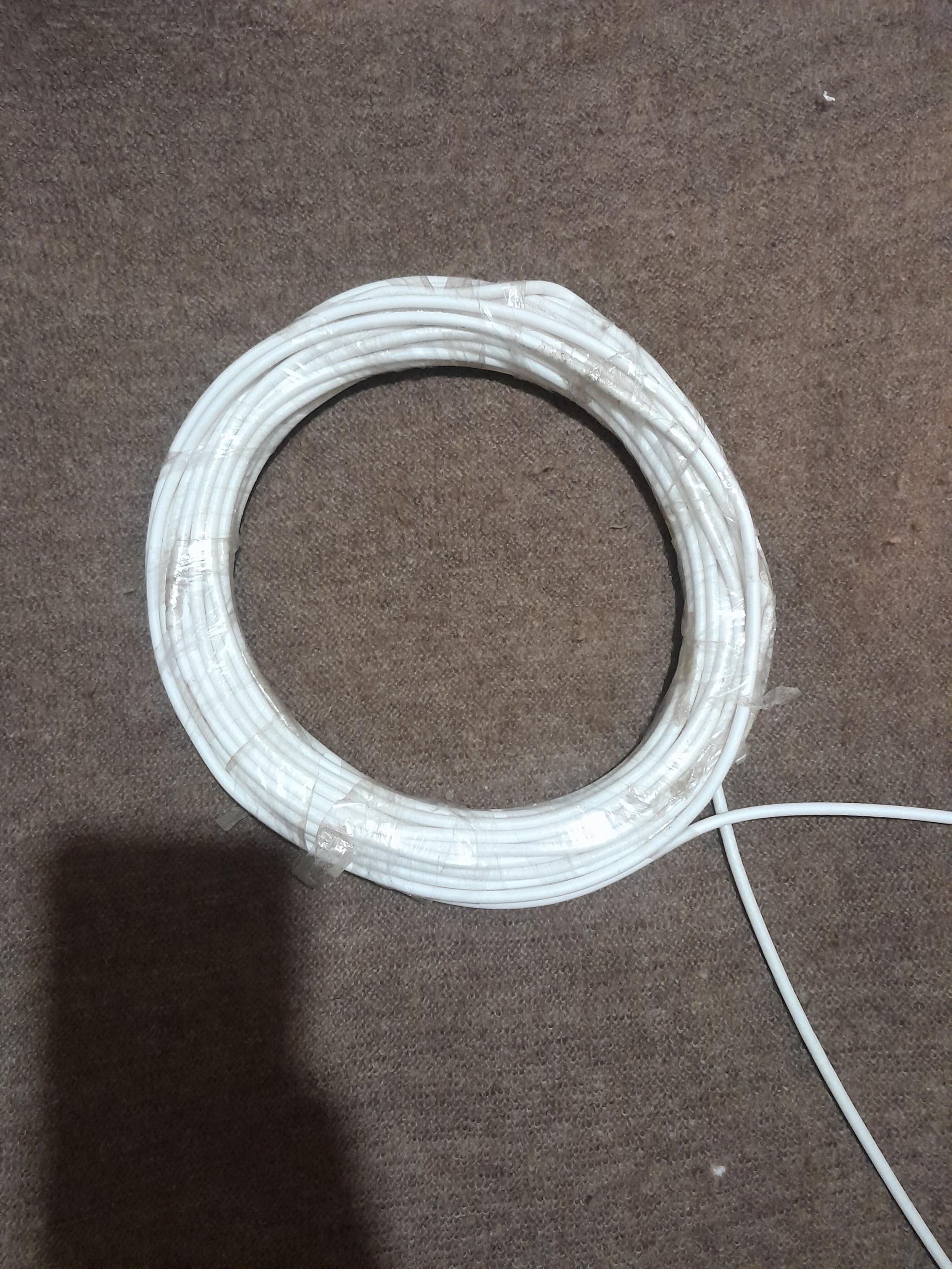

                Hello, Detector #1. P57 = 130kΩ. All component values ​​match your schematic, except for resistors R24 and R25. Mine are 250 ohms. I already asked why increasing these resistors increases the reverse voltage and thedecreases pulse duration.It should be the other way around. With R24=47 ohms and R25=47 ohms, as per the diagram, the pulse voltage is 190-200 volts, and the pulse is damped in 10 µs. The coil is a homemade ring; I'll be making a DD out of it.
