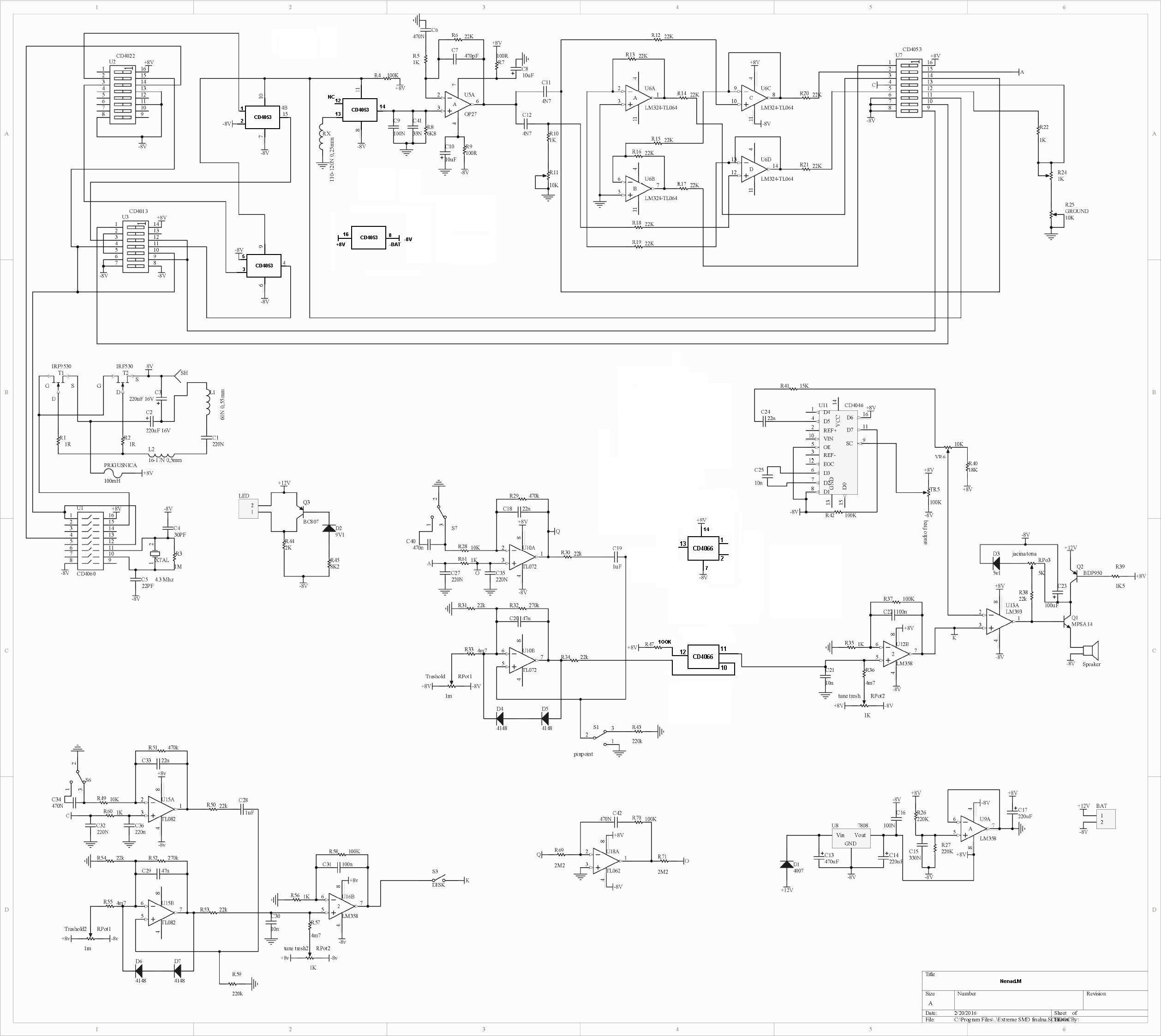

                    • Only the transmitter is bipolar and the processing is VLF at your Pecka, here is a scheme from 2016, similar except that there is no delay during the cycle, i.e. bipolar pulses.-8v =bat negative.

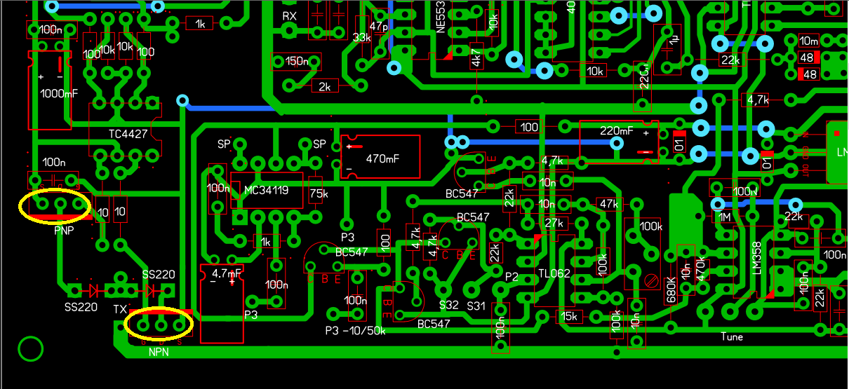

                        • Hi pechkata!
                          Thank you so much for sharing your files!
                          I wanted to ask you two questions:
                          1. What MOSFETs did you use in the circles marked in yellow?
                          2. Did you use the same coils designated in Sascho's schematic?​ Click image for larger version

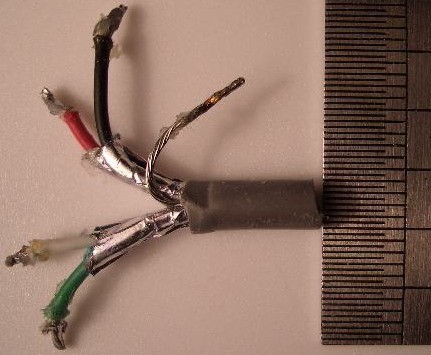

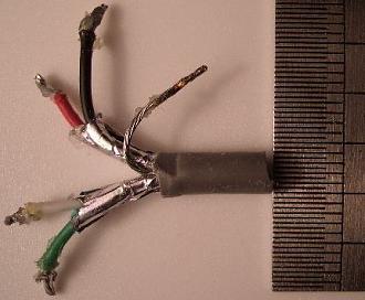

                            Hello, Ruben.
                            Yes – a capacitor in parallel to determine the sweep.
                            The MOSFET doesn't matter—it doesn't consume power.
                            The cable to the ignition coils is also important.
                            The shielding connects to the battery negative terminal.

                            • Hi pechkata,
                              The mystery with the real schematic of this project continues to exist. On the PCB, the marked in yellow zones for transistors from Ruben2000 was named as PNP and NPN. But you mention for them as MOSFETs and TC4427 driver usually controls MOS transistors. Full mystery!

                                I think it refers to P-channel and N-channel MOSFET transistors. IRF740 and IRF9640. If we zoom in on the photo, we can see that the terminals are defined as GDS
