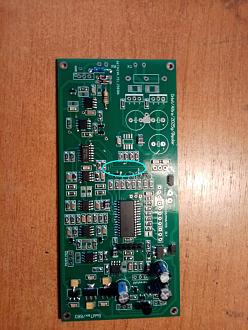

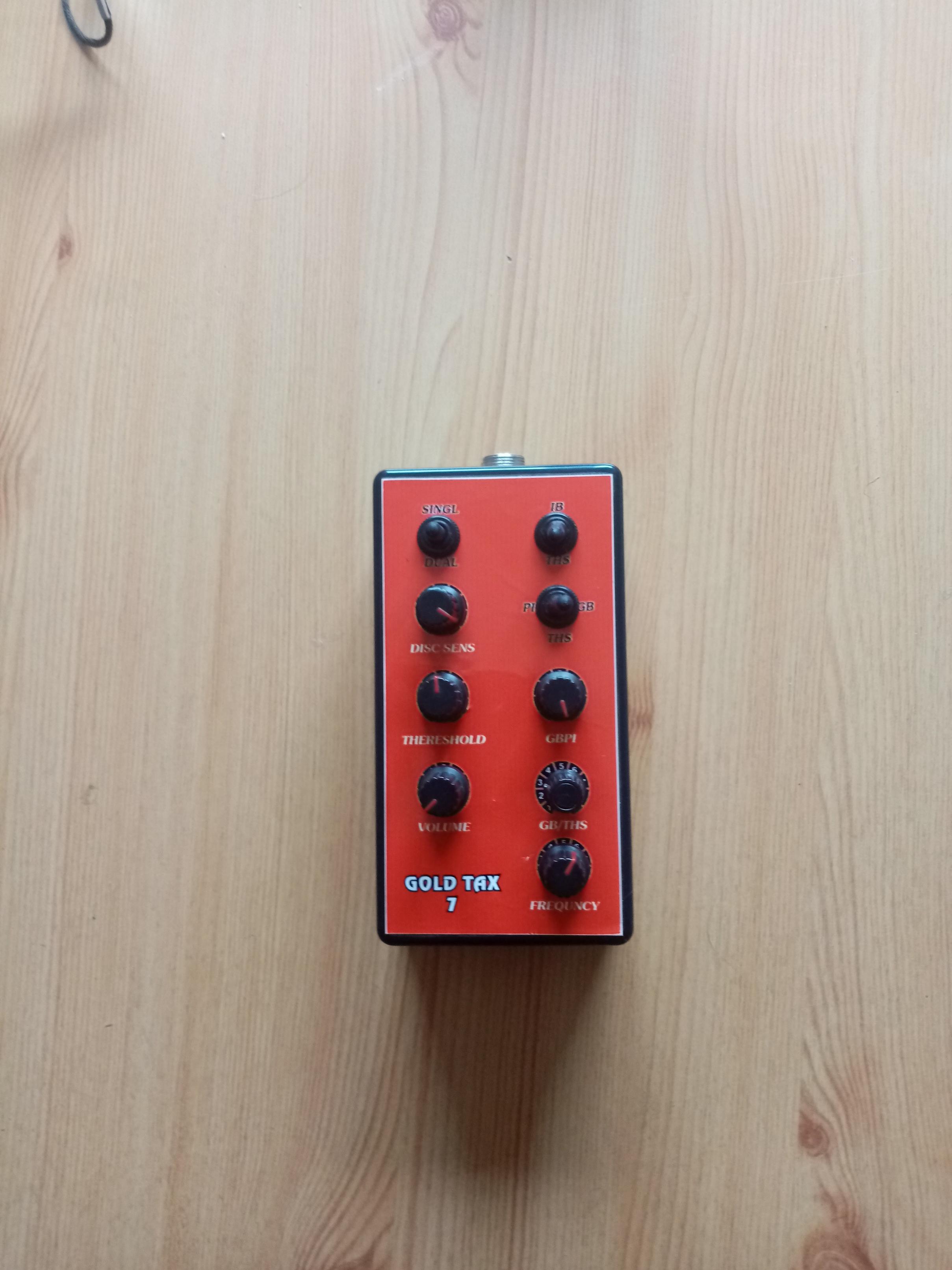

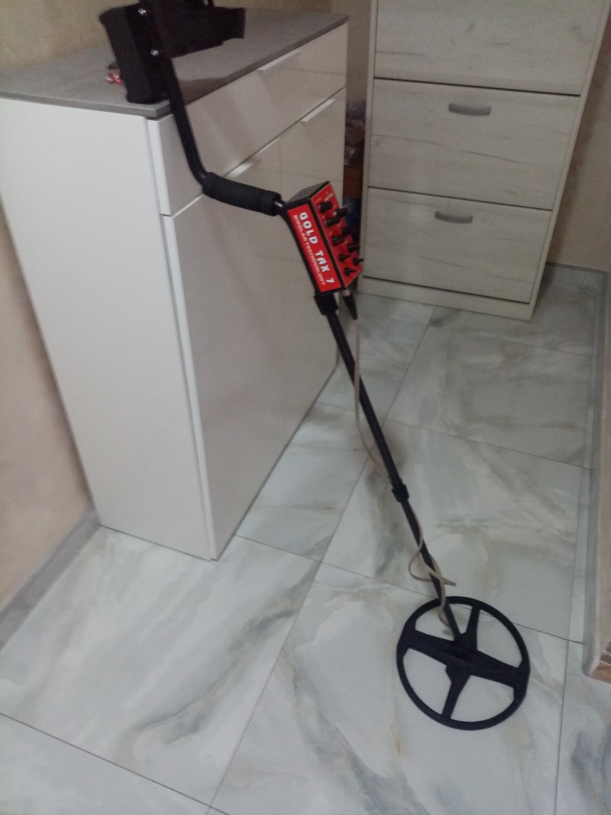

            • Bipolar hybrid detector pi region - ib region with geb +disk. With DD coil.
              • Hi Orbit / Altra,
                Nice clean PCB design... Looks very good...
                  Hi Orbit / Altra,
                  Hi GeoMax thanks, I think the Altra design is even nicer!And very importantly, the device works great in the field.

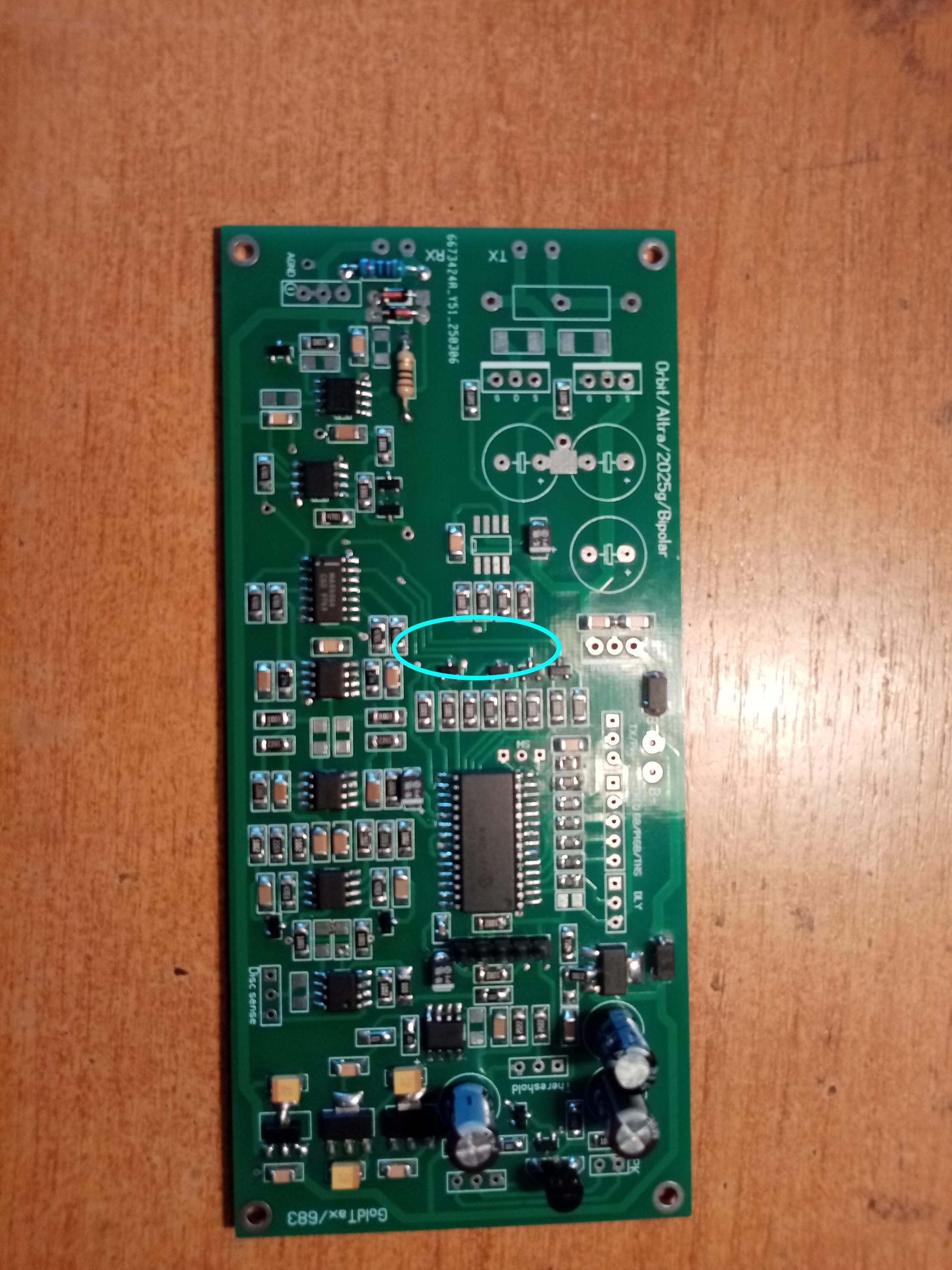

                  • Hi Orbit/Altra,
                    I’ve taken a second closer look at your PCB and have a question about it. Is there a reason why the tracks circled in blue are routed at 90-degree angles, even though all the others are routed at 45-degree angles? Or were they simply overlooked during the cleanup process?
Name:	Gold Tax 7 PCB (3b).jpg
                      Hi Orbit/Altra,
                      There is nothing special about it at the moment when I was drawing, so it was convenient for me because the pcb looks as small as possible. If the test version would have fixed the noise problem I had a different layout but since it works as expected I didn't send another version to be done.
                      • Hi Orbit,
                        Thanks... I was just curious and thought there might be a good reason for it.​

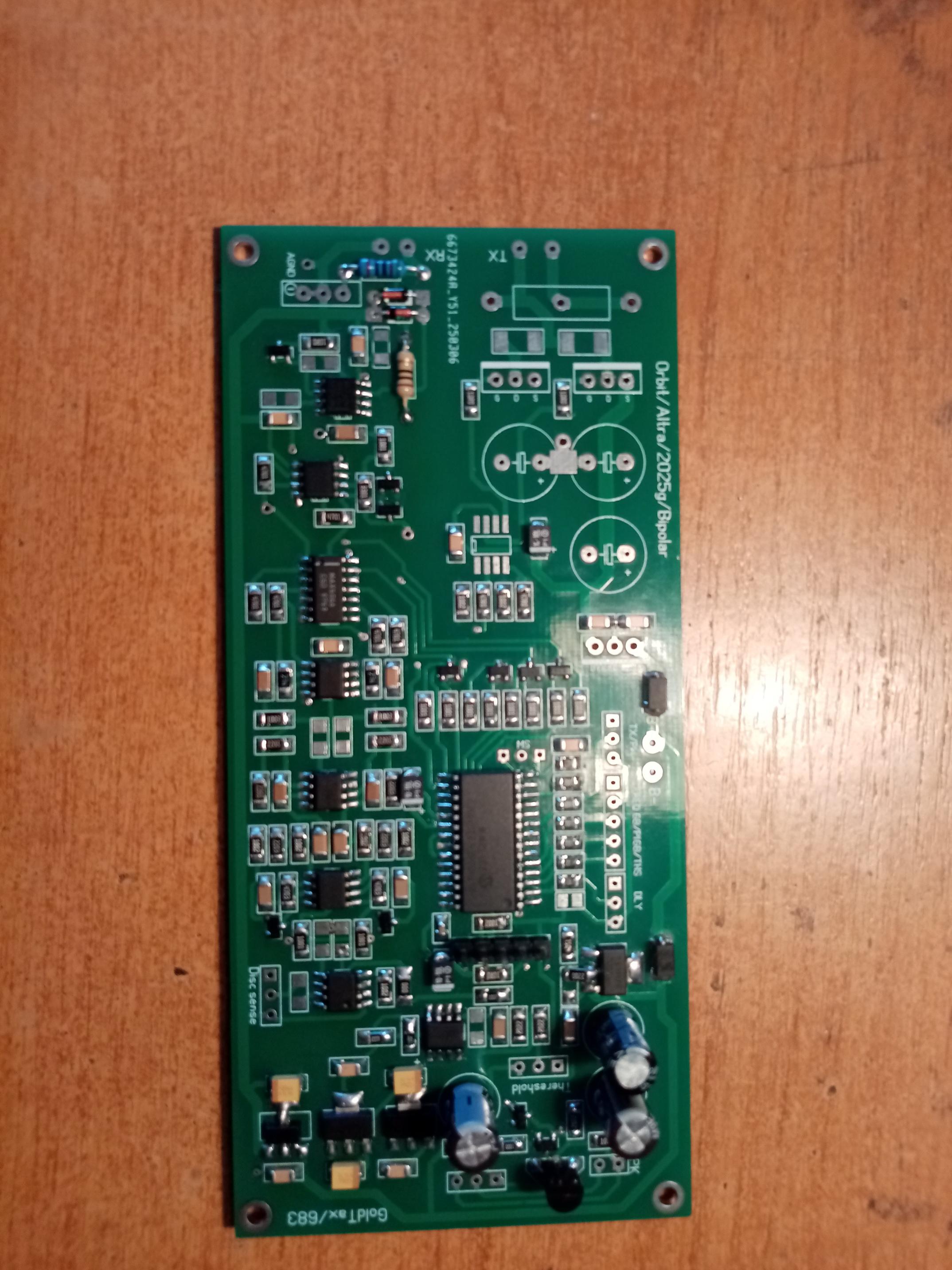

                          • Hi Pechkata.
                            Thanks for posting the PCB design and the video, which I really like. It would be very helpful if you could also post the schematic, so I can understand how the detector works. I'm especially interested in seeing the PI section of the detector. Did you use the AF108 bipolar configuration? I'd appreciate seeing a schematic, please. Thanks in advance.
                              Hi Pechkata.

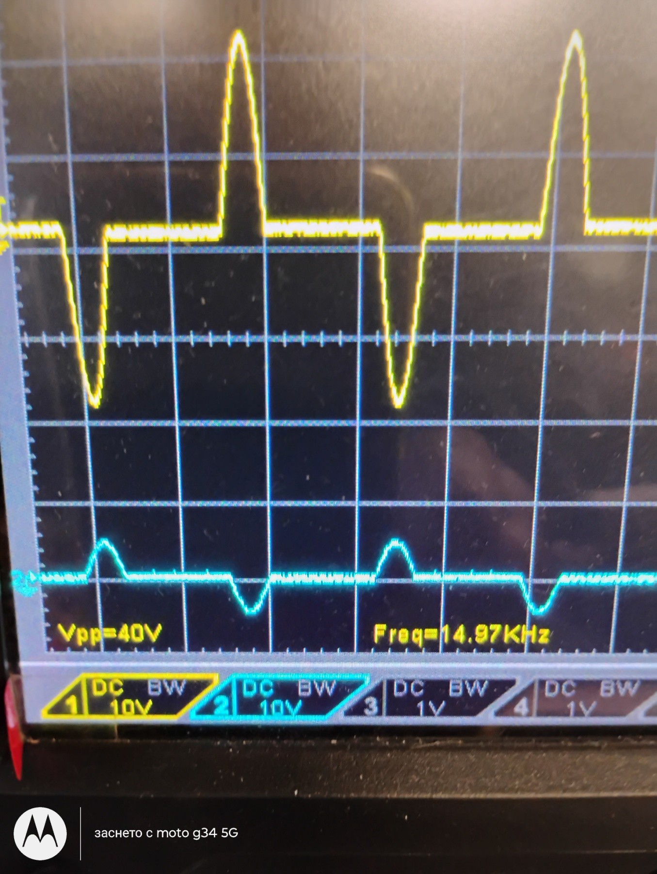

                              Hello, Eduardo.
                              There is no scheme.
                              The yellow probe is on the x10 setting.

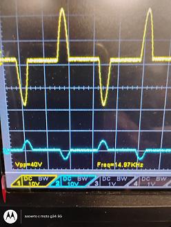

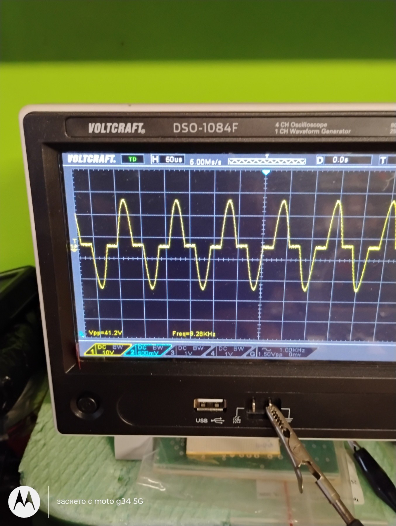

                              Click image for larger version  Name:	viber_изображение_2026-02-13_10-29-02-629.jpg Views:	0 Size:	397.4 KB ID:	450641 Click image for larger version  Name:	viber_изображение_2026-02-12_17-15-34-349.jpg Views:	0 Size:	366.6 KB ID:	450642
                              • Okay. Thanks anyway. I was particularly interested in the schematic for the bipolar pulse generator, which I see you've made with a TC4427 and a TL494. I'll try to draw a schematic based on the PCB layout.
