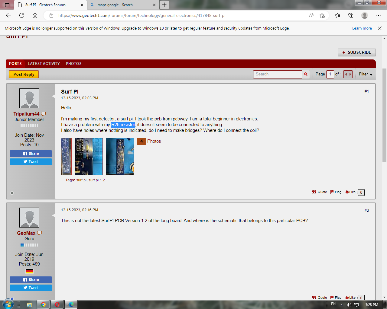

                          I must take off hottest burning coals from the fire by naked hands?? first trouble is R25 resistor is not connected to anything.
